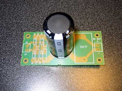

I am designing an improved high end power supply for the Pearl.
I will use a discrete diode bridge with bypass capacitors as well a bypass capacitor of 1uF across the Electrolytic snap in cap.
Any other suggestions?
I will post a photo of the layout as soon as I have a ready version.

Diodes you can start from 1N4007 or go to more exotic Schottky diodes.
Across them I will use WIMA 100nF Caps with RM 7,5.
The big snap in cap is the original 10 000uF Cap and across that I will be using a Mundorf 1uF MCap. But you can use any good Polypropylen Cap.
For those who have ordered boards for the PSU I just wanted to say that they will come next week.
I will post more info and photos when I get them.
