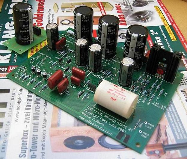

Hi promitheus,
thank you for the parts, i also received them and built 4 channels. The PCBs are very nice quality and were easy to solder due to the grid groundplane.
Now all i need is a transformer and cases for my double-stereo set who fit under my players.
And some 47k resistors for R1, that should fit for the concorde system.
Is the quality of R1 very important for the sound?
The attached pic shows the assembled parts for one mono channel.
Greetings
Ralf

Hi Ralf,
the look great.
I would buy good low noise resistors.
Even the best cost 1€ piece. Its only 2 pieces 😉
Keep us posted with more pictures.
OK, to keep it as you selected the parts i´m gonna use Farnell Nr. 340789 WELWYN 47k 0,1% 0,25W Metalfilm
For the capacitive load by C14 and C16 (Ortofon suggests 200-600pF for the Concorde Pro) i plan to use Farnell Nr. 3040008 LCR COMPONENTS 390pf 1% polystyrene Capacitor and the same as 200pf in parallel.
Is polystyrene known for good sound?
Did anyone experiment with different materials for C14 and C16, maybe with polypropylene WIMA FKP2 series?
Thanks for your efforts,
Ralf
Both are good but I wouldnt know what to suggest from the 2 capacitors.

Have you thought about how to bring the power from the power supply chassis to the phono chassis? Some people use a kind of XLR connection, some other like Pass Labs use DB25 type of connector. Which one would be the best?
My favorite ist the XLR connector.
You can use thicker cables and you need to drill a round hole.
The best solution is to use a 4 or 5 pin XLR so you can transfer the voltages separately. The most important is not to mix up the grounds from the 2 power supplies, so you dont have any ground loops.
That is propably the best way to go. I did use a SUBD connection though. No ill effects whatsoever🙂 Explanation here:My favorite ist the XLR connector.
