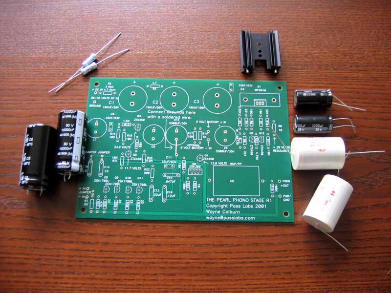

So after Calculating I could offer a Q Pack for 20 Euro.
2 Zeners
2 IRF9610
10 ZTX450
2 2sk389
2 quads of 2SK170BL
I could also organize a Cap Pack with all Caps for the PCB for 44,50 Euro not inlcuding the 10uF MKP.
Also an R Pack with all resistors using the MRS25 low noise Resistors from Vishay and the 2 2W resistors from panasonic for 8,50 Euro
The Heatsink costs 1,70 Euro and the 10 uF MKP Audyn Cap costs 3,70 Euro.

The prices I calculated were for the Panasonic Polypropylene Caps from Panasonic like the ones Passdiy suggested. They are 2% but good quality.
I dont know what tolerances they have but there are better ones.
Silvered Mica are a very good choice but they would cost a lot more than the PCBs themselves.

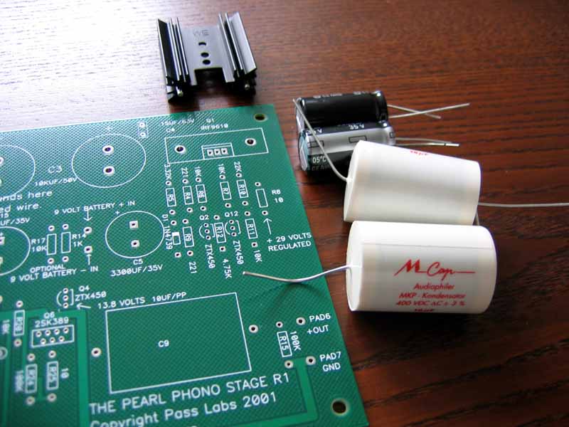

I see a problem in the schematic.
What´s wrong with C11 in the RIAA circuit?
The schematic says 0,15uF and the parts list says 15uF.
I think though that should be 150nF or 0,15uF.

I am confident that the sch. is right; C4, C6, C11 is 0.15uF🙂The schematic says 0,15uF and the parts list says 15uF.

So I ordered the boards today and I will be able to ship them after Easter I think in the middle of April.
The end price for one board is 17 Euro.

the boards cost 17,00 Euro ( 22,10 USD), you will need 2 PCBs
Following Packs are for 2 boards.
Q-Packs : 22,00 Euro (28,60 USD) all transistors matched
C-Pack : 36,44 Euro (47,37 USD) all caps, RIAA not included
R-Pack : 6,65 Euro (8,65 USD) all resistors , RIAA not included
RIAA-Pack : 17,65 Euro (22,95 USD), RIAA parts caps and resistors matched.
more info will be sent with email if you are interested.
