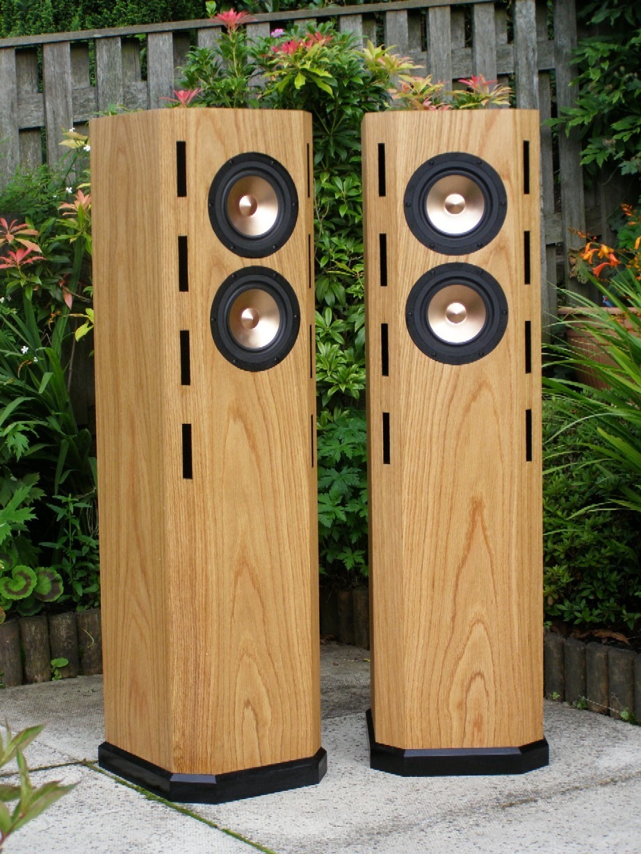

3/ Repeating myself again -the Pearl driver is built for them by Markaudio. It is not a current generation Alpair 10; it shares [most of] the cone but the motor design is different, per their requirements. I'm a consultant to Markaudio, so I actually know what's in it: I'm not saying what I 'think', this is simple fact.

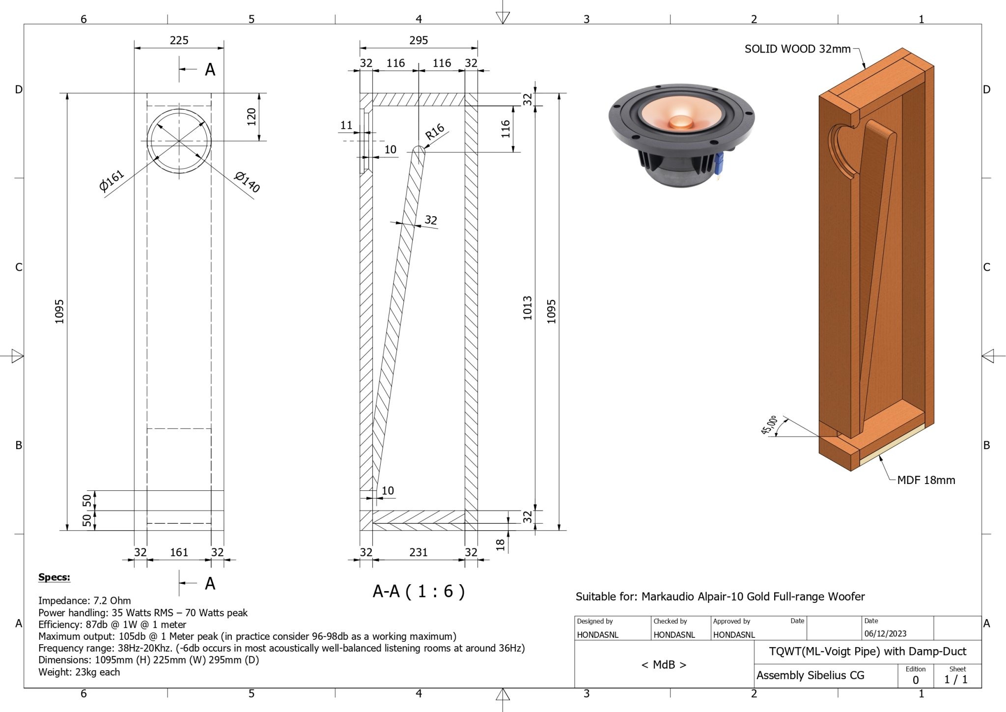

Will there be a big diffenrence in sound by using the original markaudio alpair-10 gold?
Maybe someone likes to build a cheap test cabinet? 😀 👍

It can probably be simulated in Hornresp or something with stock A10.3 parameters and see is it ok, or simply use some old closet sides to make box and measure it.

Is it worth it to build simple MDF cabinets according my drawing with Gen.3?A10.2 gold was never produced. They were A10.2 copper. Don’t know why MA still use gold and grey which disappeared with Gen 1.

i’d start with an enclosure designed for the driver used.
And given that the builds we do have proven to be solid, why build a cabinet you are going to burn eventually?

I just used DATS V3 with some Markaudio NIB drivers, they are close to each other but way off published parameters from manufacturer. I like to work with wood since early age as carpenter child, but can't design box cause I skipped to much math classes...so for fun I build proven designs for drivers I have, and it seems that some of those designs are calculated with published parameters which are not always correct
