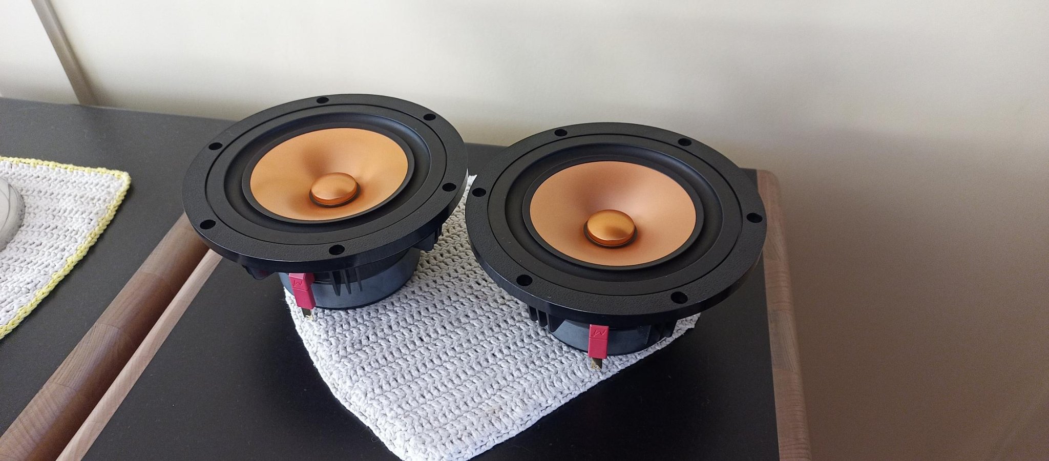

Cones on the A10.2 and A10.3 look the same. The Sibelus driver is neither.
I can say no more (i do know more).
But A10.3 is the DIYers starting point. I expect a pair of A10.3 Pensils would have very simialr performance.

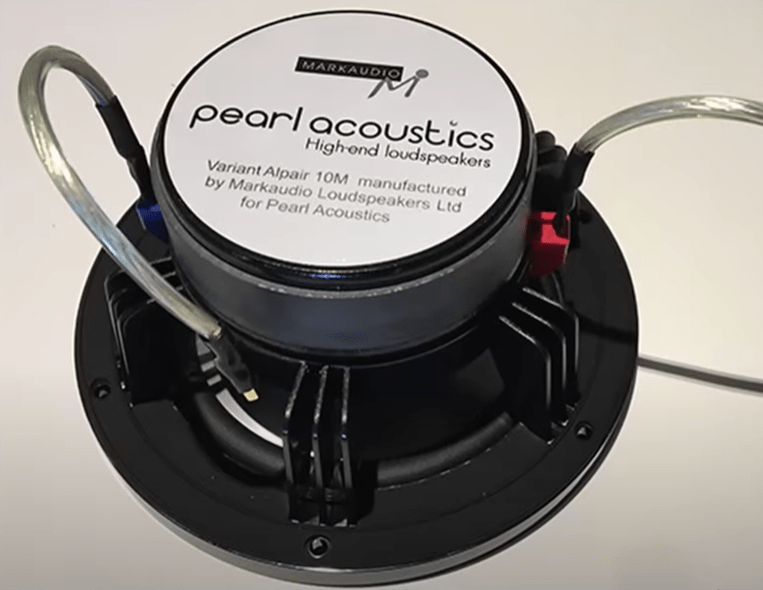

Its probably tweaked version of Alpair 10M for Pearl Acoustic
Yes. In a sense.
dave
But I still think it's pure commercial matter ;-).
Just another decal on the back specialy for Pearl Acoustics haha.
An ML-Voigt is closer, but there is a trick that turnes an ML-TL into an ML-Voigt.
The picture of the Pearl driver uses MUCH thicker wire than i would ever use.
dave
dave

Pearl Acoustics speaker cable is at least 16awg IIRC.The picture of the Pearl driver uses MUCH thicker wire than i would ever use.
jeff

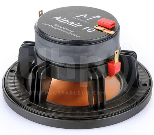

The magnet looks also exactly the same haha.
Same diameter and height.
Also Re 7,2 Ohm (edit: and efficiency).
But I believe you 🙂.

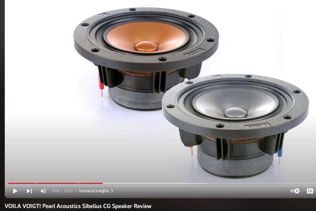

Mistake #1 in the review: it is a nominal 5.25” driver (which has a cone 100mm across)
Mistake#2: Not a phase plug, but a dustcap, but it does act like a 1” tweeter.
Terminology: A voigt is in the TL (quarter-wave) class of loudspeakers
Good comments on what no XO brings.
Hegel had too low an output impedance… too much damping.
dave
Except for the colour of the label, A10/10.2/103/10p you couldn’t tell the magnets apart/.
dave
