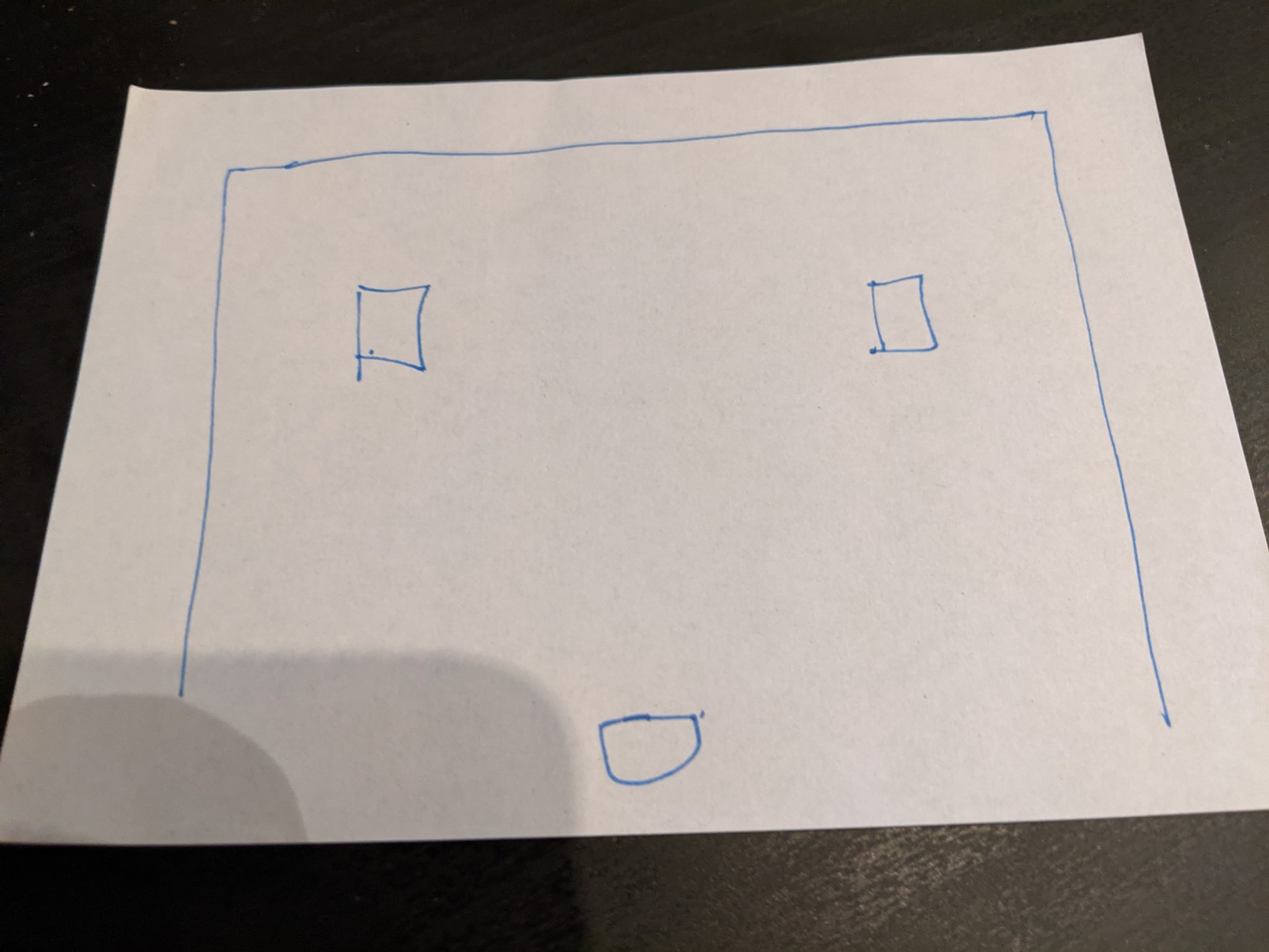

I had to look up the 1/4 and 1/8 space terms.
So... the "corner" you're thinking about in 1/4 space is the corner between the rear wall and the floor? And for 1/8 space the side walls would be closer than farther away? Not like a Klipschorn is a corner horn that has an intimate relationship with a two-walls-and-a-floor corner.
I've seen it observed that the FHXL needs careful placement. How much tweaking and/or fine tuning should one expect to do? Maybe consider renovating the rear wall to achieve the corner "space" that works best (rather than toeing in?

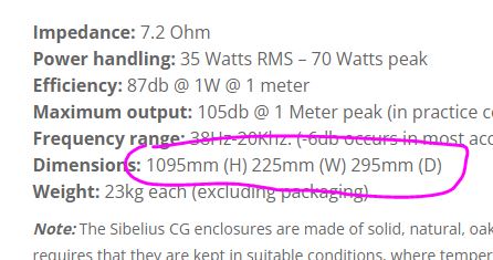

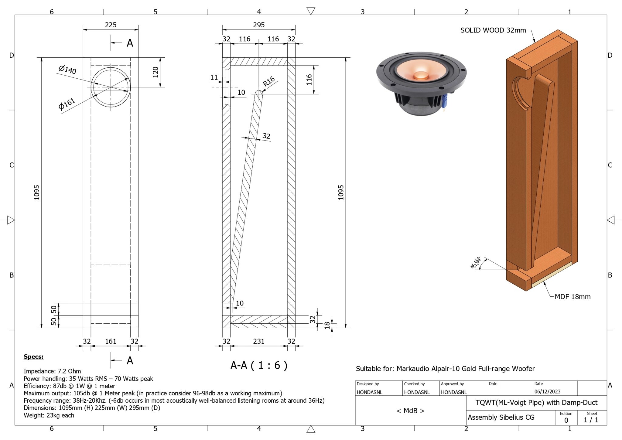

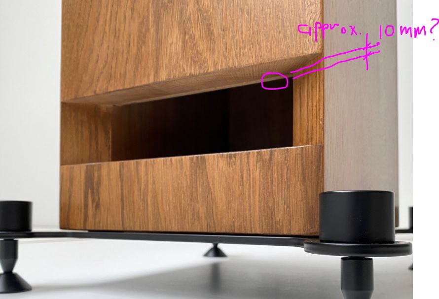

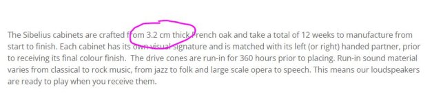

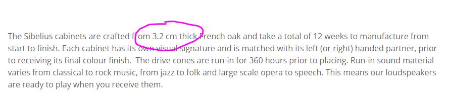

I think this should be the correct cabinet drawing for the Sibelius CG.
Edit: the location from top of cabinet to center of driver exactly scaled and measured from my computer screen, exactly 120mm.
Also done with the bass opening on the bottom, exactly 2x 50mm.
