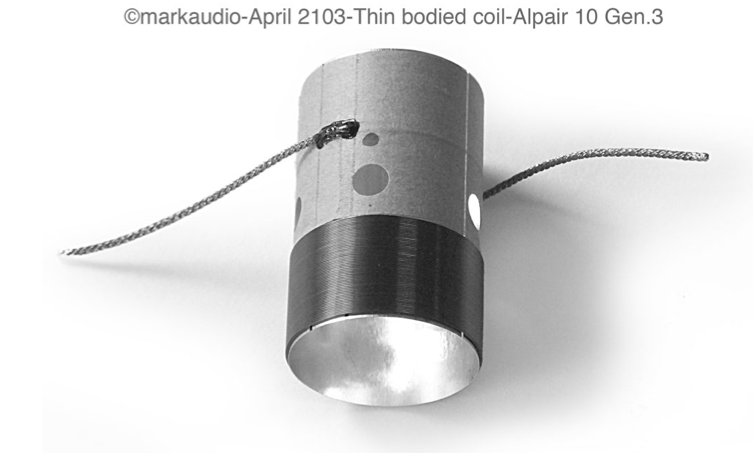

switching to a square wire for the voice coil...
I believe that is the only chnge from A5.2 to A5.3.
dave
The current (final) generation Alpair 10s both run round section wire.Wonder, did Mark use the square wire in the publicly available gen 3 version ?
No change in form-factor; the 5.2 ran a CCAW coil, 5.3 runs pure copper. The drivers are identical apart from that though.I believe that is the only chnge from A5.2 to A5.3.

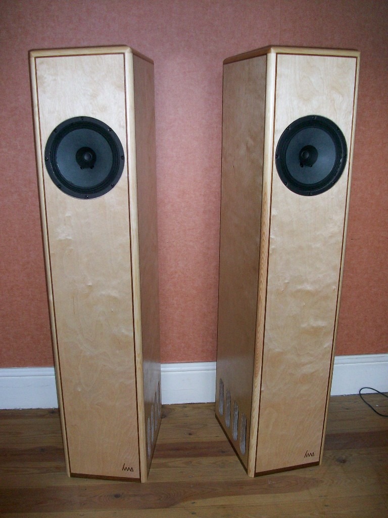

Also I noticed the Pearl's speaker looks higher in the box or is this just the photos?
Sibelious is a folded ML-Voigt, the driver will be near the top of the box with the fold right behind it.

I’ve not been paying much attention recently but stumbled on this thread. To address the original post, these were quite popular in the past, particularly amongst diyers in New Zealand. I sold a fair number of pairs, even right up to 2016. Judging by the price of the Sibelius I’ve just seen, these presented a bit of a bargain ready made at £750. I’m not sure I could make them for that right now though, based on the price of Baltic Birch.

The wooden box is one thing, the driver you put in it is also important.
1/ Looks like an FA22 in the box above, they need phase plugs: http://www.planet10-hifi.com/downloads/B200-phase-plug.pdf
2/ FE206 is not really suited to a Voigt
3/ It has been shown that a Voigt gets much better (way less ripple) if you mass load them.

Nice work on the boxes, I like the way you addressed the edges, walnut? What's the finish?I’ve not been paying much attention recently but stumbled on this thread. To address the original post, these were quite popular in the past, particularly amongst diyers in New Zealand. I sold a fair number of pairs, even right up to 2016. Judging by the price of the Sibelius I’ve just seen, these presented a bit of a bargain ready made at £750. I’m not sure I could make them for that right now though, based on the price of Baltic Birch.

thanks,
Rob
So... less like a Pensil than a bent over Metronome that looks like a Pensil?Sibelius is a folded ML-Voigt, the driver will be near the top of the box with the fold right behind it.
Actually, if you zoom in a bit, it look just like a Wild Burro Betsy.Looks like an FA22 in the box above
jeff
Like a folded Festival. Metronome won’t fold as neatly, but they effectively have teh same load.
dave
No, it's not a pensil (which are MLTLs that use an alignment of my own) or any other straight MLTL alignment.
