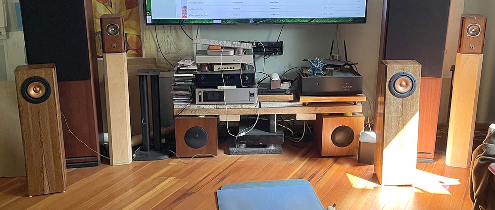

Some gratitous pictures.
Black Locust
Oak?
Douglas Fir (Bernies 70 year oild floor) with a walnut insert.this is one of my personal pairs.
Not all these are Bernie’s and i can olny guess the wood in some of them. The first is my Yew pair, the last Chris’ black walnit pair. 2nd one is Oak, 3rd is Western Red Cedar
These are in Yellow Cedar (the first ever Compact FLoorstander build)
dave
Black Locust
Oak?
dave
