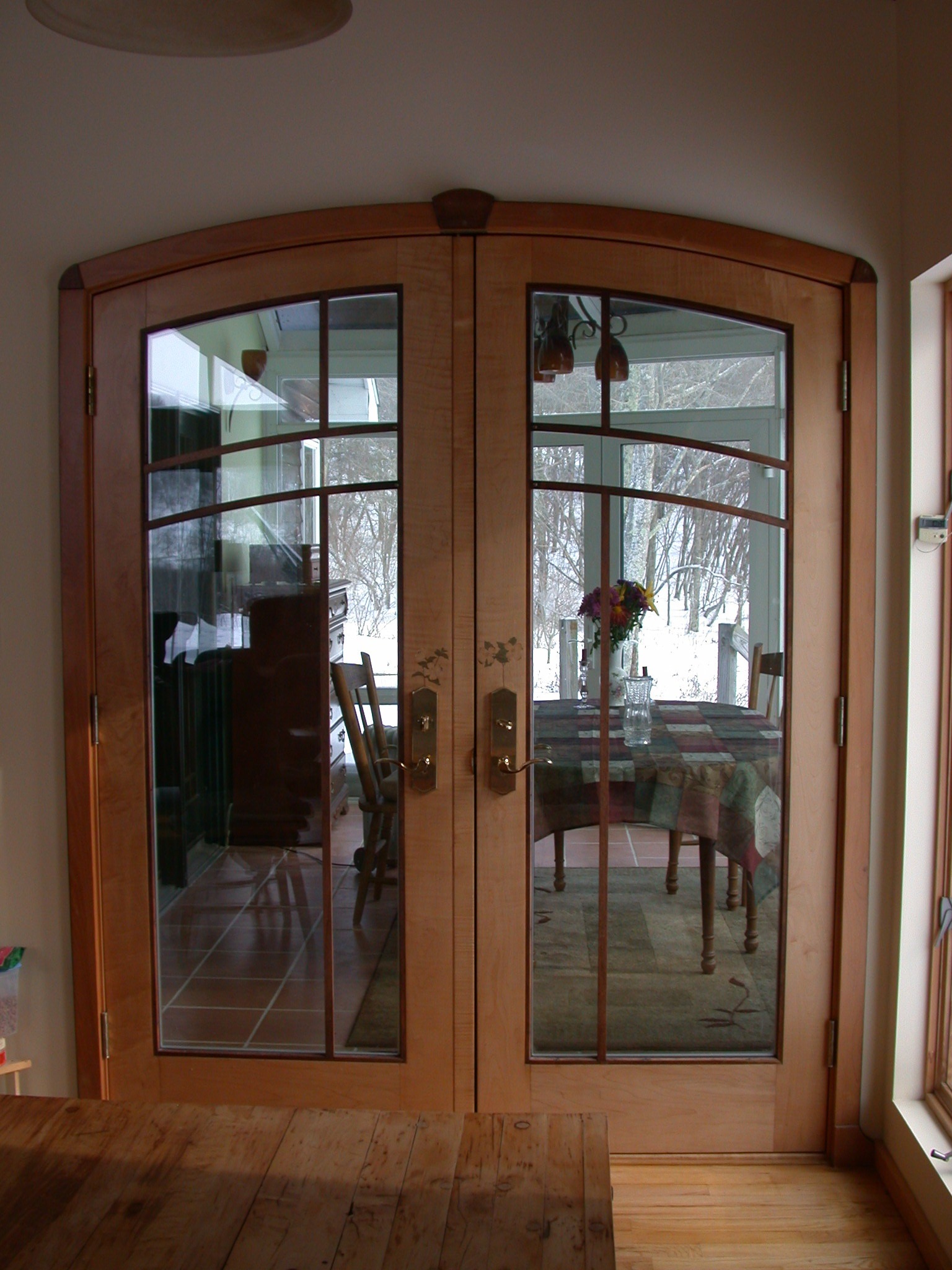

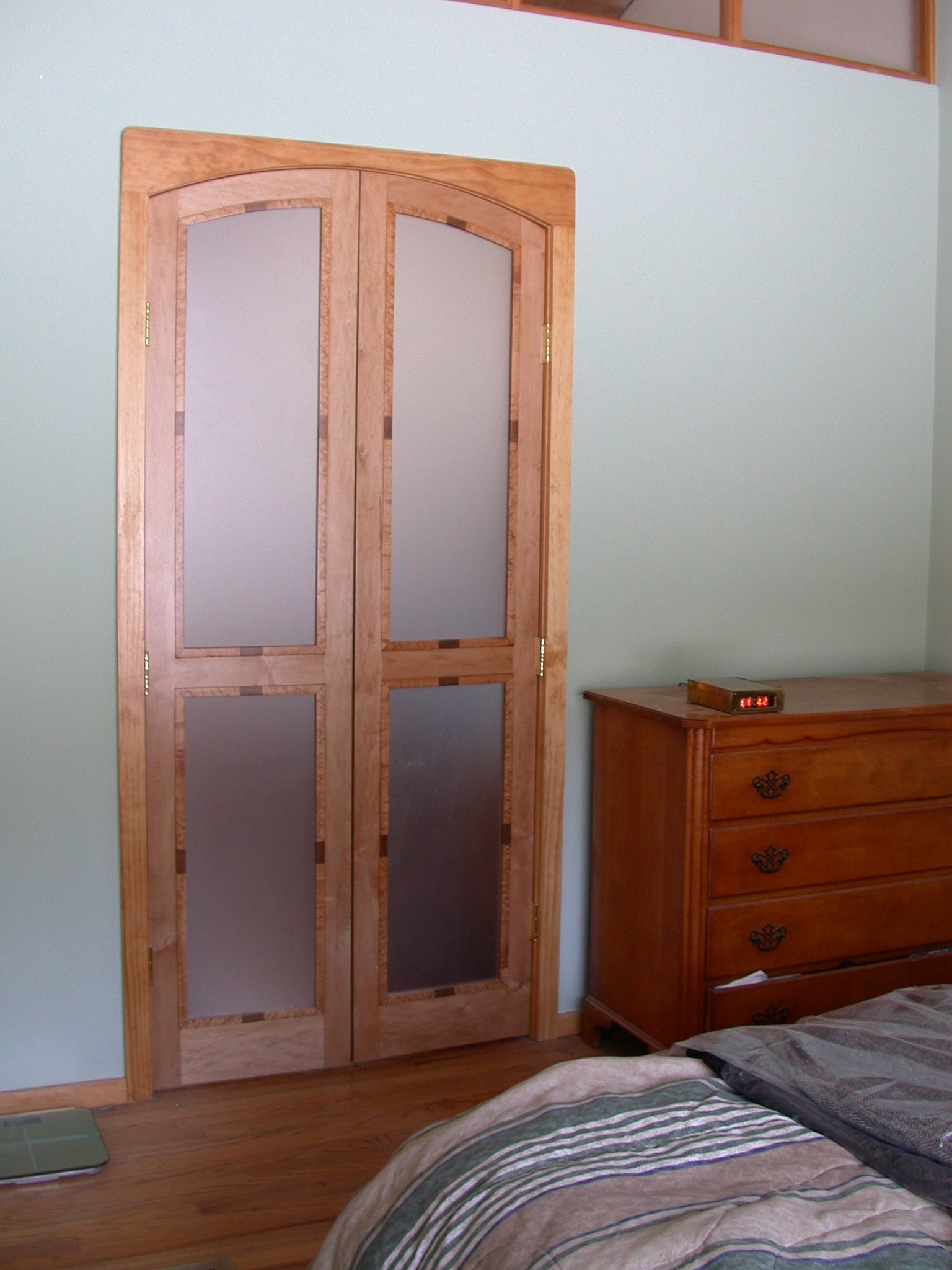

I walked around the house this morning looking at the doors I built, some I did over 25 years ago, to refresh myself and check for cracking. The large French doors were built over 25 years ago out of 8/4 maple and for about ten years before I put in the sunroom they faced harsh northern winters in NY's Catskill Mountains. While they were mortise and tenon joints I only saw slight cracking on the outside of the doors on the bottom where snow sat on and off for years. The width of the bottom panel is ~8-3/4" the glass is double pain thick glass that the glass place should have used 1/8" glass on but use 1/4" so each glass panel is a good 50 pounds if I remember so there's a lot of weight on the bottom plate.

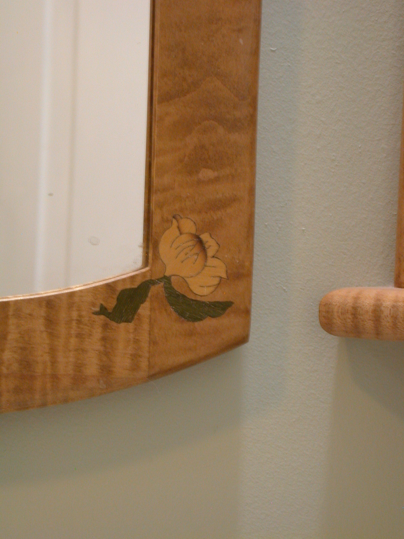

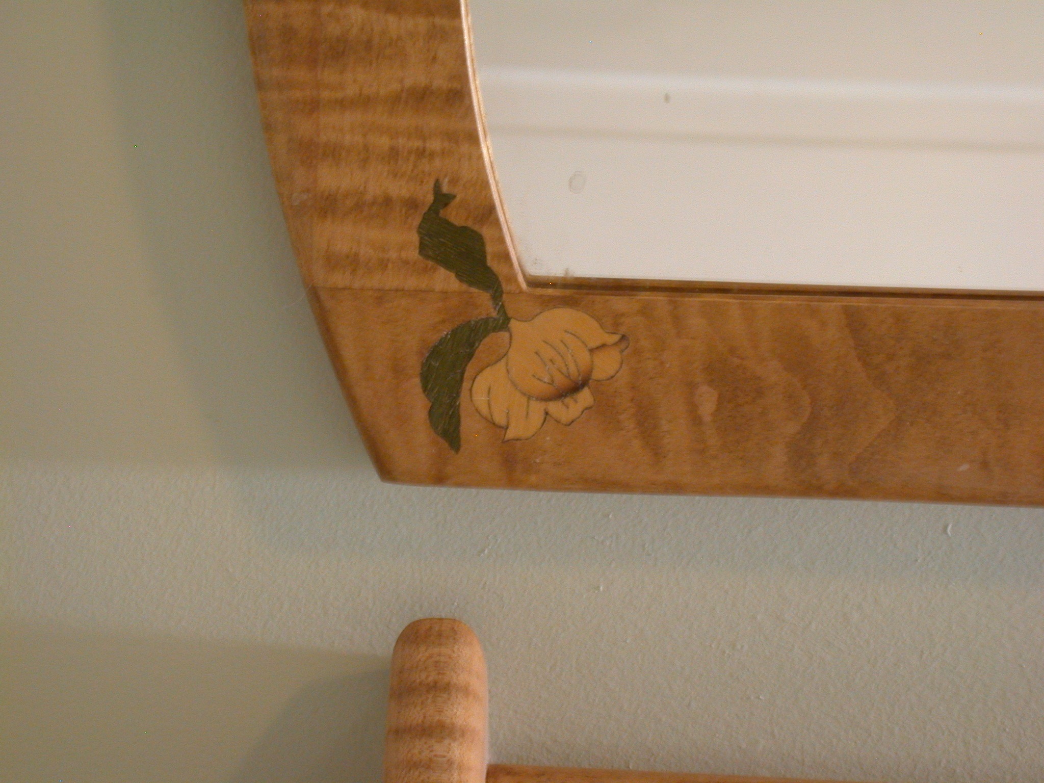

Even the photo with the inlay never cracked but it is a shorter grain difference.
I think I can reliably get up to about 9" of grain difference before I start to see trouble, I'll have to think about joints and gluing.

Thanks on the doors.

Yeah those arched glass doors are really cool.
