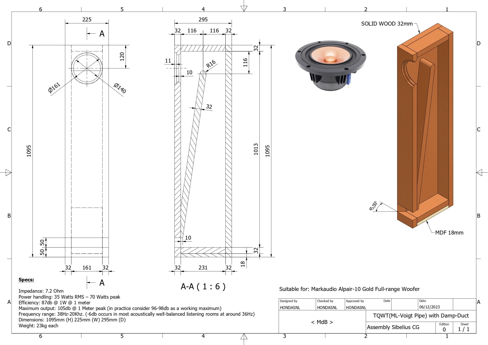

I think I will be very dissapointed

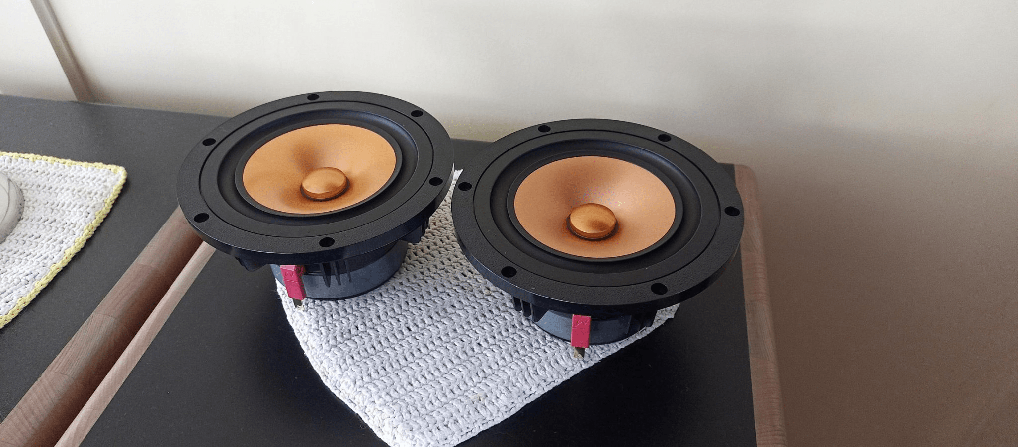

I think I also will be very dissapointed after listening to the Sibelius with the "original" Alpair's 😉👍.Will there be a big diffenrence in sound by using the original markaudio alpair-10 gold?
Maybe someone likes to build a cheap test cabinet? 😀 👍
Er -Sibelius doesn't use the "original" Alpairs, which were launched about 18 years ago and share no components of any kind with any later versions of the driver apart from the basket. Operationally speaking it was a very different drive unit to the second and third generation models & the custom units based on those, with more emphasis on employing bending modes in a softer alloy cone than the resonant modes and direct-bonded central cap in later units (which required a complete redesign of the motor and suspension for obvious reasons). The first generation Alpair 10 went out of production about 7 years before the Sibelius was designed & launched.
There seems to be a bit of logical fallacy going on here. For example, it's not possible, from a quick look at external front / rear photographs, to tell anything about the details of the coil material and form-factor; the coil former, its materials & form factor, the T-yoke / pole-piece, its materials & shape, washer (ditto), what is plated (if at all), where and with what etc., or the precise grade of the magnet material. All of these affect behaviour, sometimes subtly, sometimes significantly. But without disassembling the drive unit -you don't actually know what's been done.
The Alpairs pictured by CIndra could be Alpair 10.2 or Alpair 10.3 or Harley’s version of the A10 just ferom the outside.
dave.
dave.
Agreed -but since they aren't the original Alpair 10, it's getting a bit difficult to follow exactly what's he's referring to. Granted, I'm not at my brightest just now so it's probably just me being more than abnormally dense...
This.I think he means current 10.3 model as "original", not modified for Pearl
jeff
Its not my picture, its posted by Hondasnl in post 141, I really dont know how and why we ended with Alpair 10.1. As I understand, he took some time and effort to recreate plan for boxes like Sibelius and asked will it work good enough with stock Alpair 10M (which version he have I dont know) and than things go a bit sideways because Pearl work with modified Markaudio drivers
