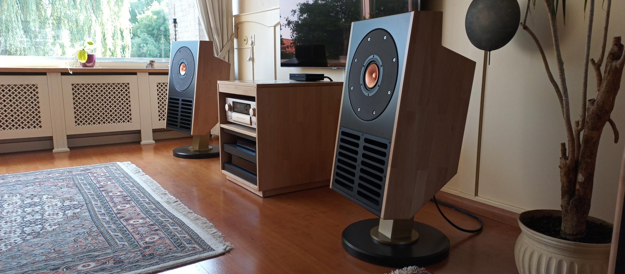

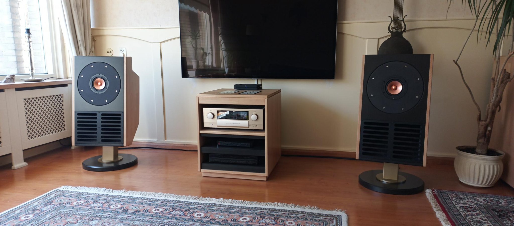

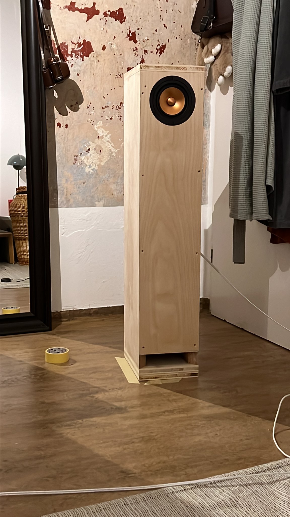

I used my last weeks to build some cabinets based on @Hondasnl 's plans, with little changes.
I got an great deal on the 10.3 Drivers and the Sibelius-style cabinets fit sizewise much better in my room than all the others.
Long story short, the first listening-test wasn t great, they sound a little harsh and ear fatiquing, so I decidet to give them a good amount of break-in time. After 50hours playing under a blanket i tried them again and they sound great.
Realy holographic, with a lot of depth, no harshness and a lot of controled bass.
I m sure the originals will sound better, not talking about the craftmanship.
But for what I paied, these are some great sounding speakers.
For now I put them back under the blanked for a little longer to break-in, the whole 150+h markaudio recomends.

In our experience the A10.3 will keep getting subtly better even after hunreds of hours.
Kepp on listenin’
dave

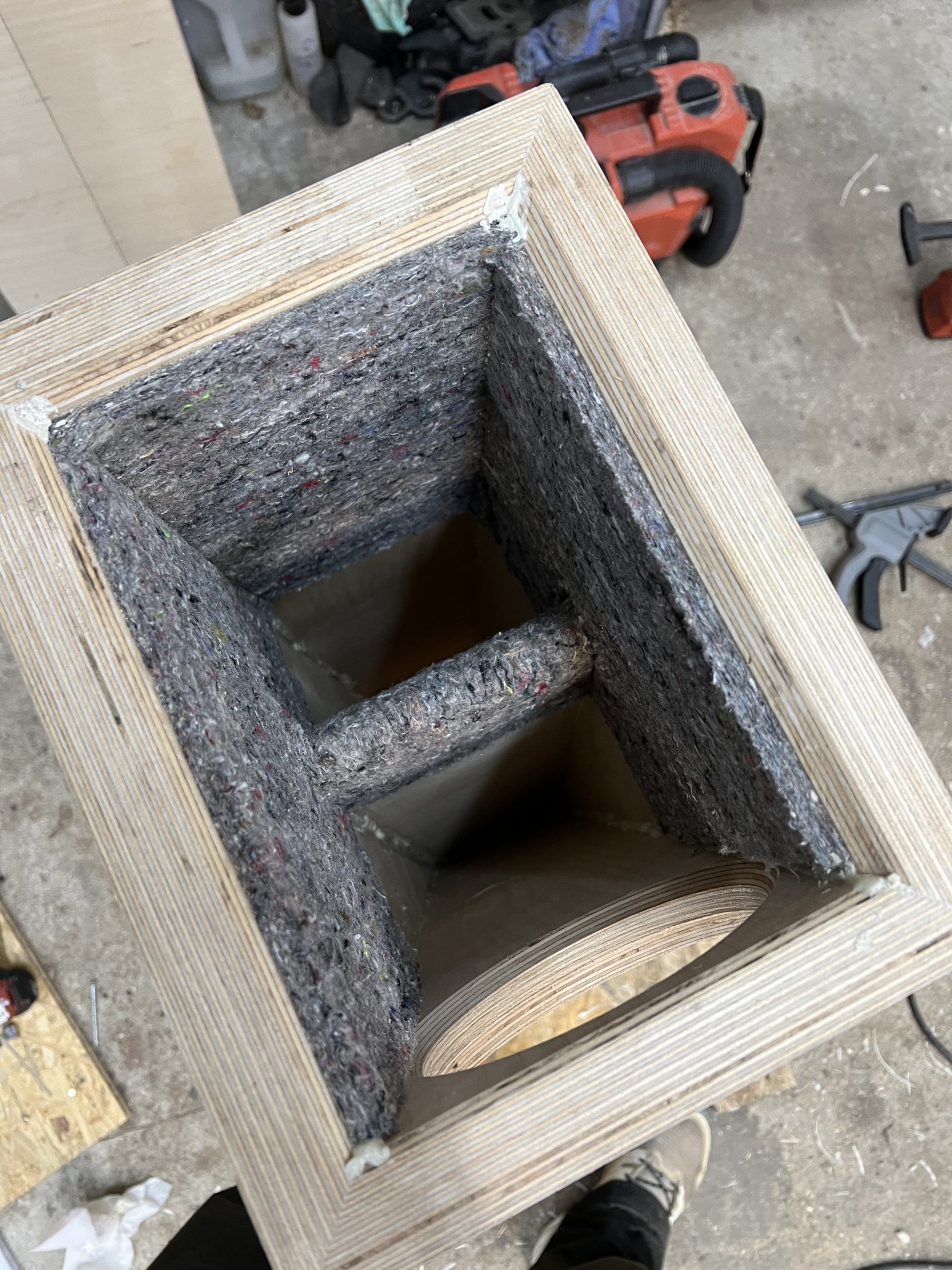

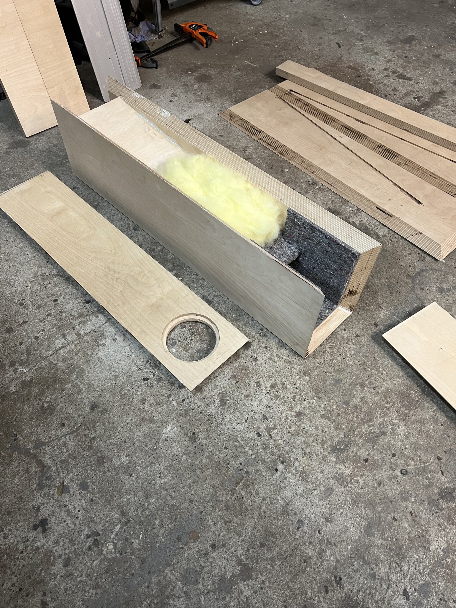

I tried to mark it in the picture.
For damping I used 45g Twaron Angelhair and a Damping10 mat to the depth of 29cm in the rear part and 23cm in the front.

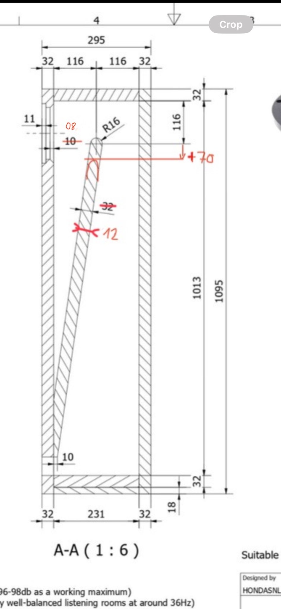

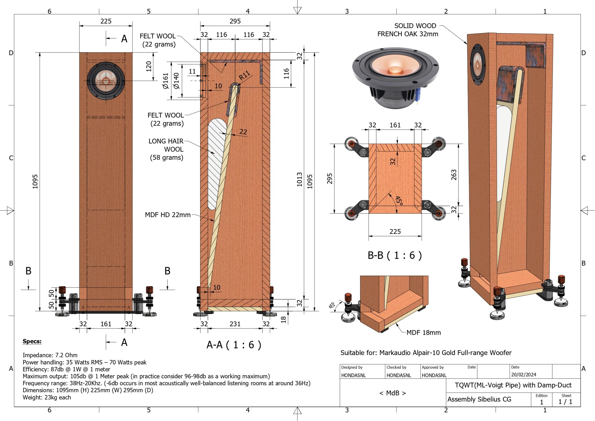

When I first want to start this build I didn t fully read this thread, I just found the sketch and compared to several pictures of the originals, where it also seem to be lower, so I changed.
Later I also want to try how the sound change if I build this part a little higher.
Please correct me if I m wrong, but to lower this part could tend to higher port resonances ?!
To be honest, I dont know, but seems to me that you changed driver position regarding pipe lenght. More experienced members will know how would that change response if that 7 cm matter at all

Nice work Qualle! In the future I also like to built them.
I like the Markaudio's 10.3 drivers very much.
Nice to hear that also a clone version of the Pearl Acoustics Sibelius CG sounds satisfying!

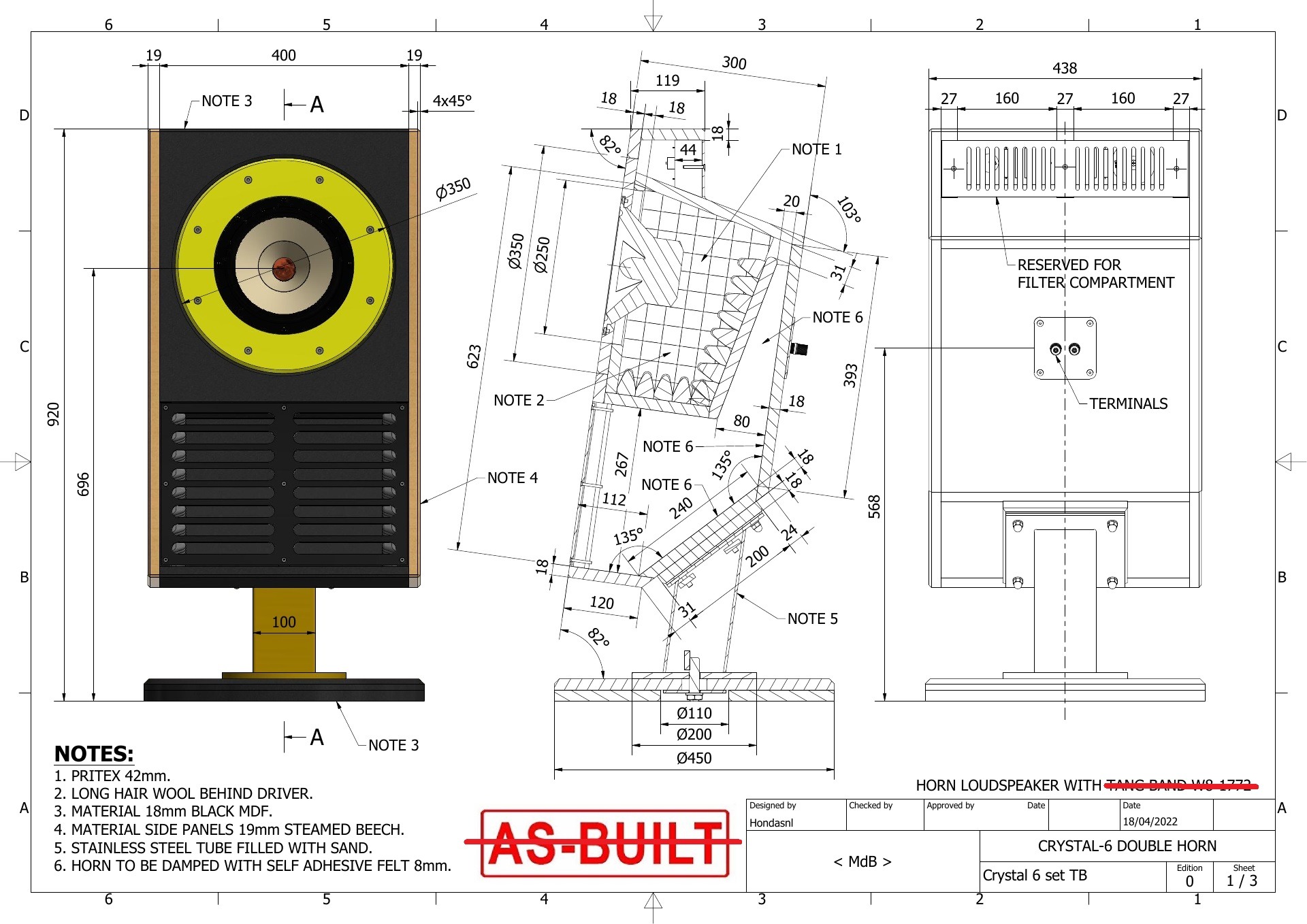

They also performs very good in my already sold "Crystal-6 Double Horn luidsprekers with Markaudio Alpair-10 Gold Full-range Woofer".
The new owner is very happy with them.
Today I ordered another pair of the 10.3's and I like to use them in my cloned Sibelius.
I really like to know how the 10.3's sounds in the cloned Sibelius to compare it with my previous built "Crystal-6 Double Horn luidsprekers with Markaudio Alpair-10 Gold Full-range Woofer".
Updated the drawing and lateron playing with some damping.
