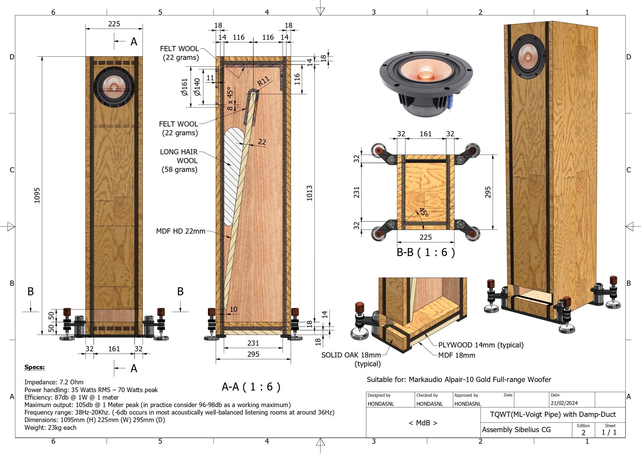

Again a small modification.
I'll use sandwich panel consist of 18mm solid oak wood and 14mm plywood all properly glued together.
Because 32mm solid oak wood is hard to find.
Sandwich panels are very good to use, very strong and dimensionally stable.
Also a nice effect the plywood in combination with the solid oak panels.

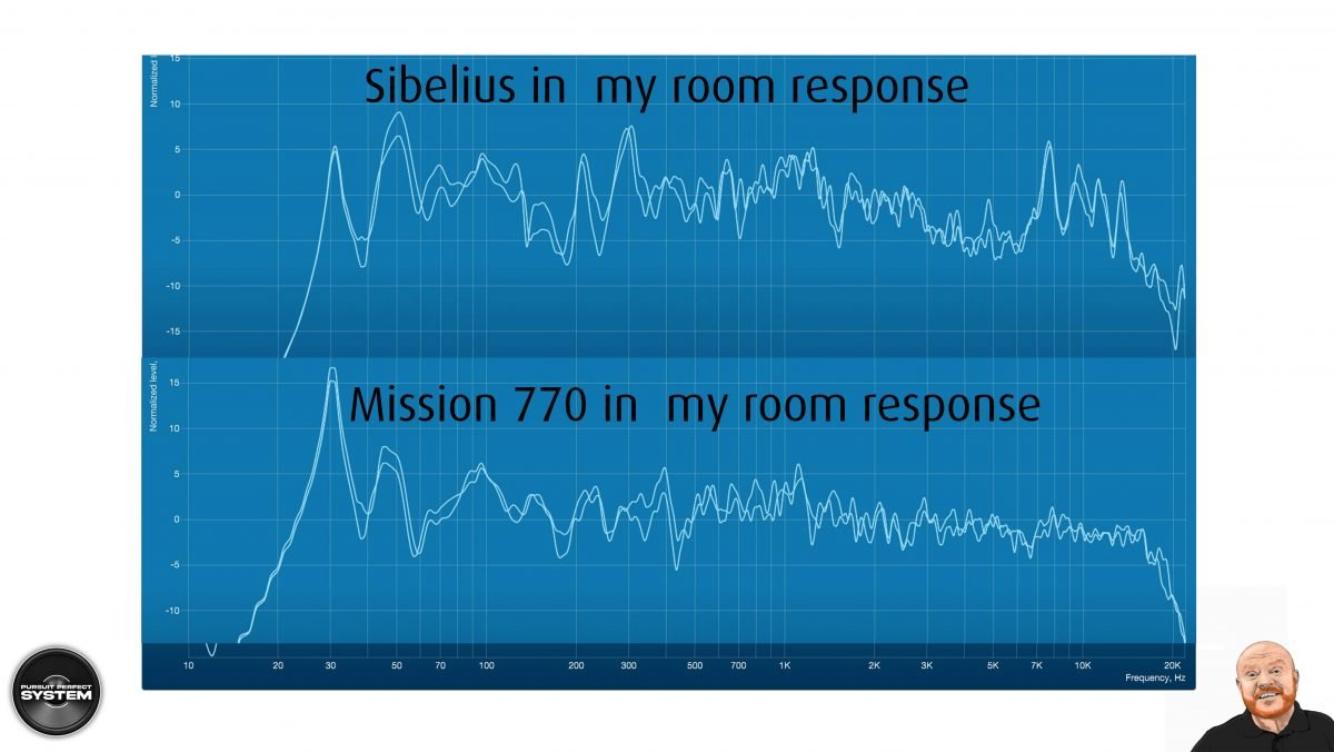

Also ordered the Gold Gen. 10.2 version and will compare it with the Gold 10.3.It would be interesting to see some measurments when you finish them, if you dont mind posting them
I can't measure the clone version myself, but I can outsource it.
Edit: Can you show me the measurements of the Sibelius?
This shouldn't be a secret.
Then we can compare these also.

My first speakers I made were from American black walnut engineered floorboards that I bonded to MDF, it was 4mm solid wood on birch ply core that I glued to 6mm MDF, worked very well on small bookshelf's.I'll use sandwich panel consist of 18mm solid oak wood and 14mm plywood all properly glued together.
Can you get 300mm+ wide solid oak? I know Dinesen flooring have some beautiful wide boards (up to 500mm!)
it looks like Pearl use glued up boards, you could just buy full stave oak worktops, they come in 32/40mm as standard. If you can't get solid.
If your not so keen on all the laminating I use oak veneered birch a lot for projects, looks great, finished easy and void free birch, you can get it in 25mm.
Yeah, it's just down the road for me, going tomorrow.Anyone going to be there? Thread and (many) pictures please.
dave
Pearl's set up and new amp...https://www.instagram.com/p/C3qVhgqNoIv/
Hi Vermouth I can easily buy solid 32mm max 200mm Oak here in The Netherlands but I don't want it in one piece. https://www.houthandelvangelder.nl/eiken-plank-32x200-mm-fijnbezaagd.htmlMy first speakers I made were from American black walnut engineered floorboards that I bonded to MDF, it was 4mm solid wood on birch ply core that I glued to 6mm MDF, worked very well on small bookshelf's.
