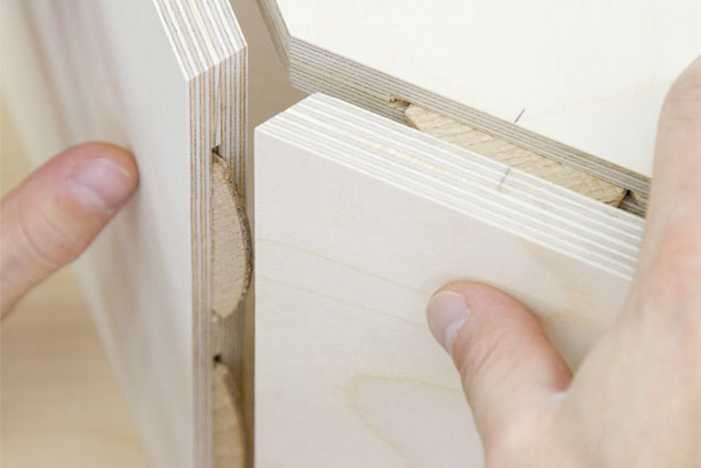

It s a little complicated, so first they need some wood which is dry enough, so it won't shrink anymore.
The next you can see, also at the pictures you uploaded, they didn't use one solid piece, they use several.
There will be a maximum of movement in every wooden slat, also it could bend over time, the wider the given piece of wood is, the more it could bend over the time because of humidity and so on. -> But it will just bend with the fiber direction, not against.
If you use several and glue them together you will minimize the range of this movement.
The brace would also help a lot and what also help to strengh the bonding are so called lamellos, I also used them, they help a lot to keep the wood in its place.

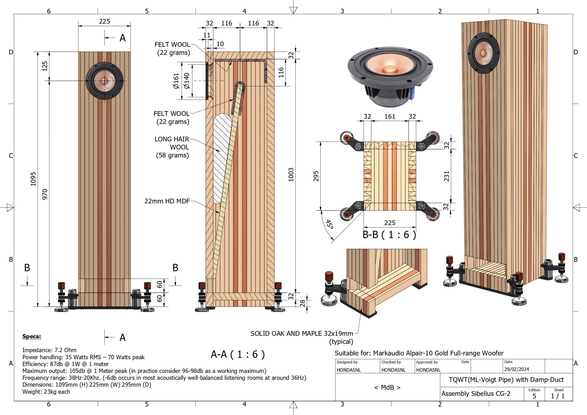

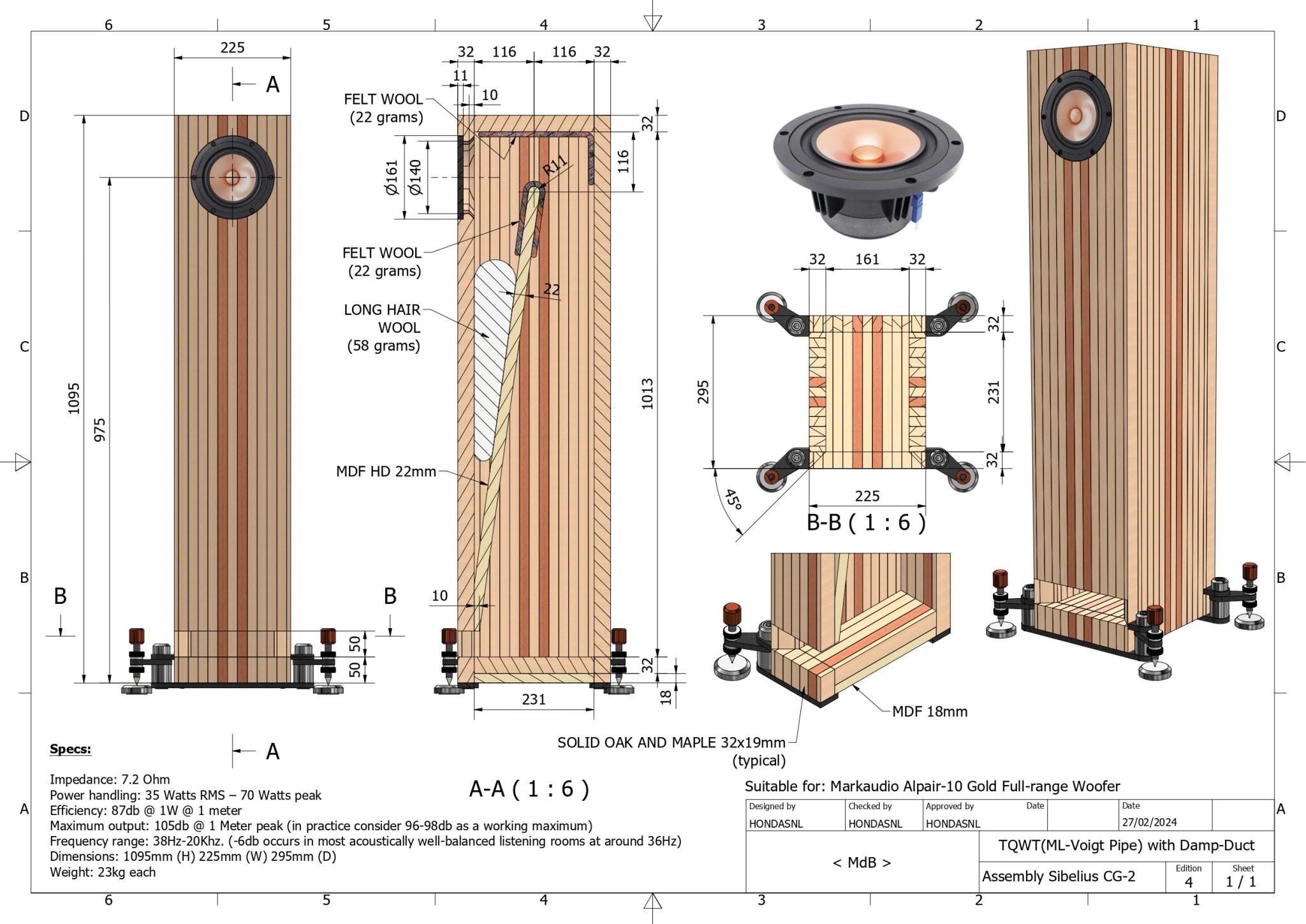

I'm thinking to order the wood for 1 pair of cloned Sibelius CG.
Thinking of a combination of solid Oak and Maple.

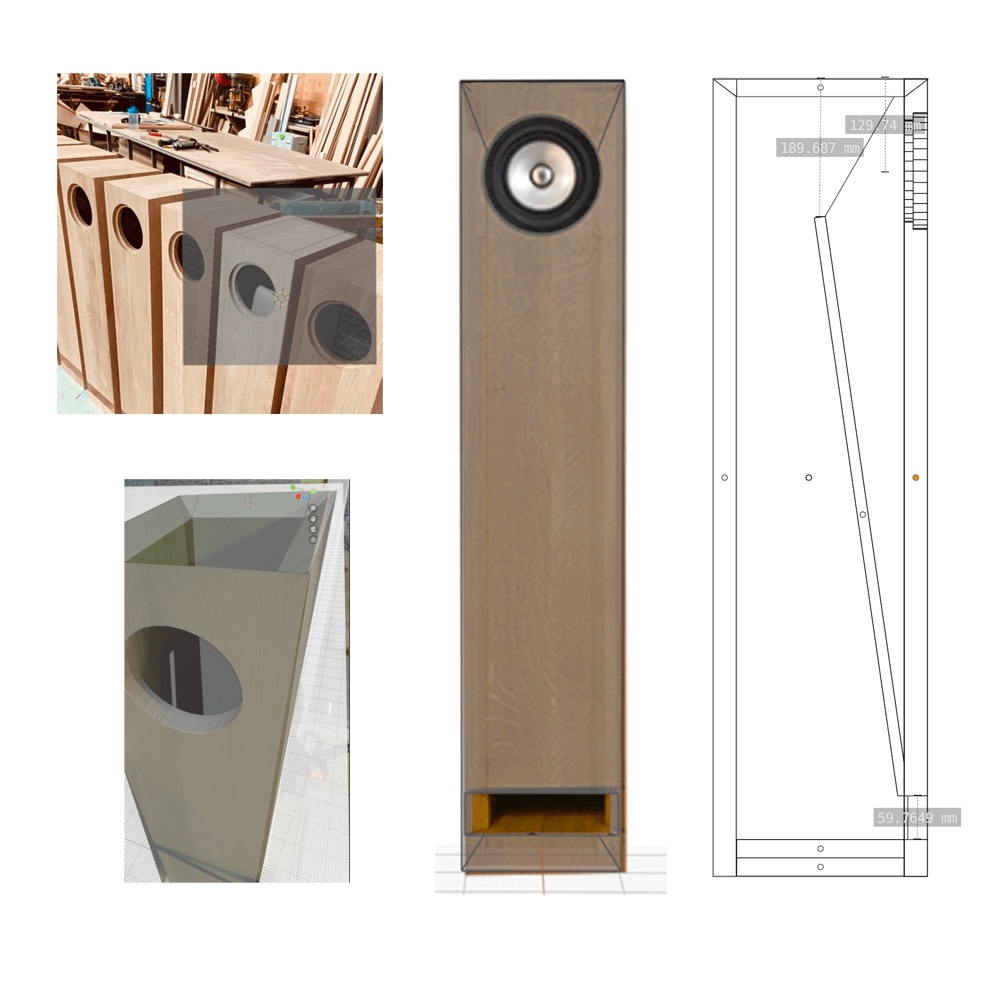

@Hondasnl I believe some of your distances in your initial design needed updating. I created a Blender object and tried to match the orientation of some of the Sibelius pictures.
I came up with the following changes:
1. Woofer needs to go lower 1cm
2. Bottom opening needs an increase of ~1cm
3. Internal wood divider needs quite a bit of lowering.
I can share the blender file if you want, but bellow is an overview of the overlaps & distances.
I think I will build it with 25mm plywood panels, use wood screws to stabilize the whole box and glue 8mm plywood panels to all the sides (other than the bottom that is 2X 25mm) to increase the thickness to 33mm.

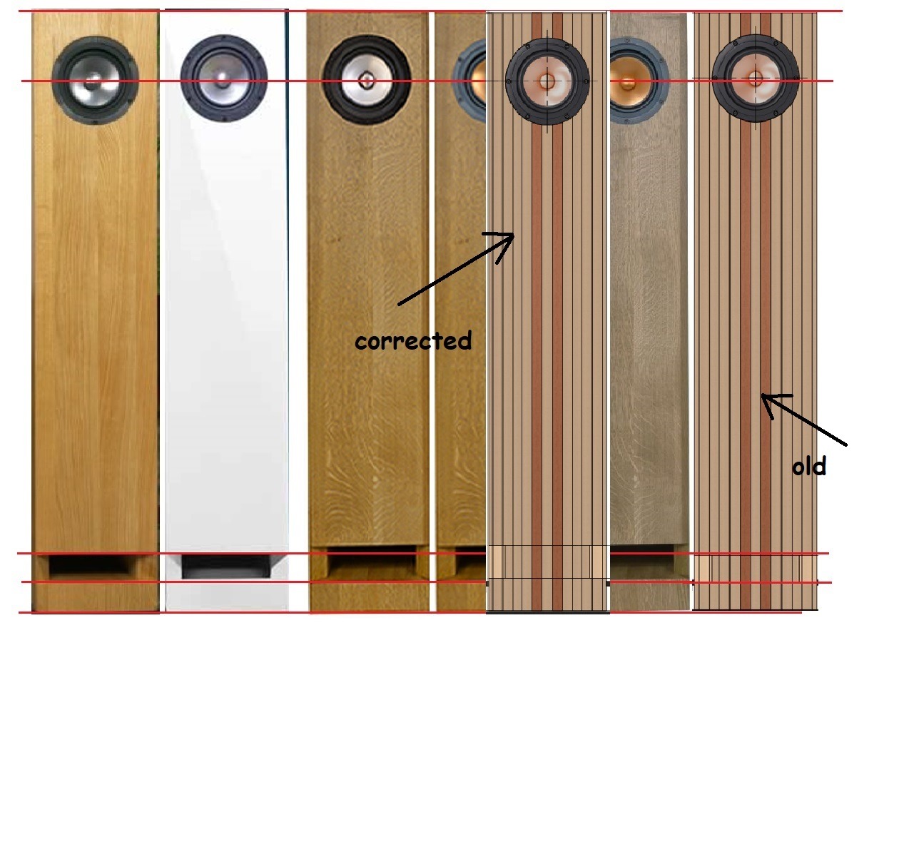

When I first want to start this build I didn t fully read this thread, I just found the sketch and compared to several pictures of the originals, where it also seem to be lower, so I changed.
Later I also want to try how the sound change if I build this part a little higher.
Please correct me if I m wrong, but to lower this part could tend to higher port resonances ?!
For some reason I had missed your posts. Great work!
In my modified design, I had to lower it about ~40mm (but I also lowered the woofer by 10mm). Not sure how it will affect the sound...

Hi Kotlos,
Thx!
I also checked again.
It seems that there are 2 versions with different heights of the opening..
The bottom opening are different I can see on the comparative photos below.
I have changed it to 60mm and 60mm from the bottom.
The driver I have lowered 5 mm.

That's interesting with the two versions... The Sibelius -L line also looks like having a smaller opening?
Do you think the internal wave guide will have a big role in the response? How did you find out its position in your current design?
Also do you have a part# for this amazing metal base?
