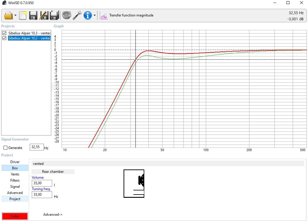

Hi Dave, can you simulate the original 10.3 and 10.2 for us?
No. When i need a quarterwave design i ask Scott. @Scottmoose.

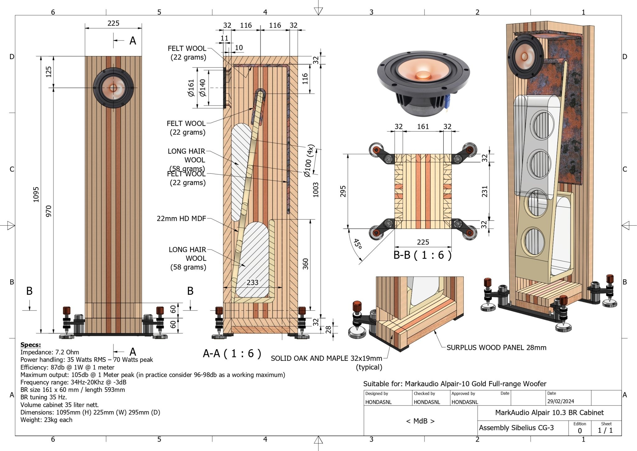

Given the access to stuff that hasn’t been published i would fold an A10.3 Festival into a rectangular box.
dave
WinISD won't give you an accurate simulation of a TL or TQWT.35L nett, transform it to a BR Cabinet with exactly the same "looks" and dimensions of the original Sibelius.
jeff
Just a box with slotted port and some inner panels. Nothing is accurate but give you a good beginning.

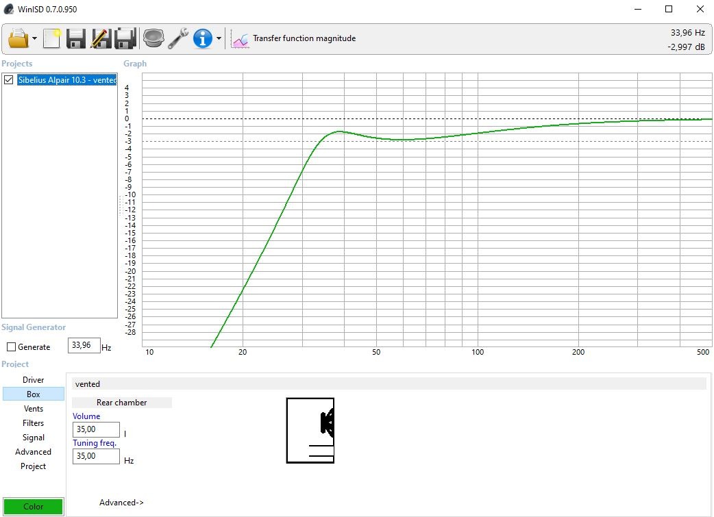

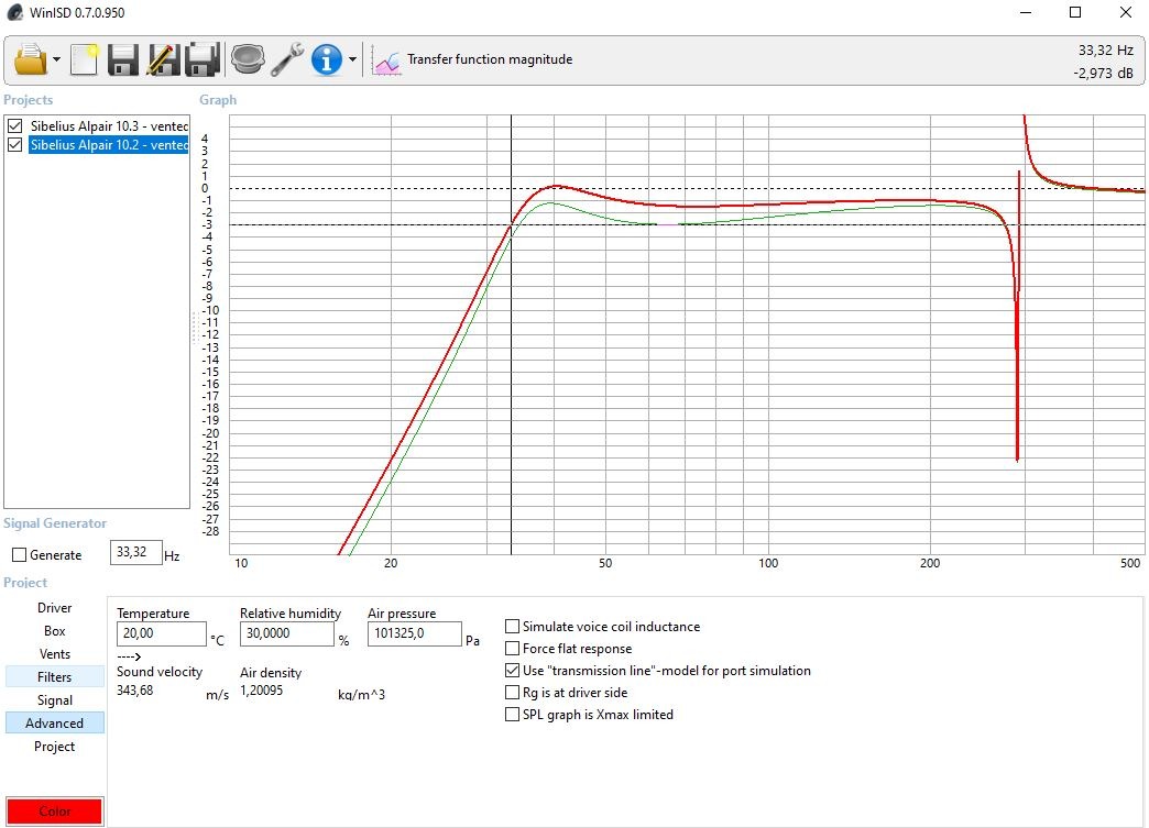

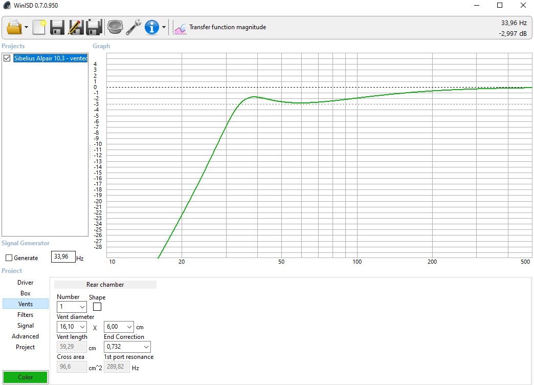

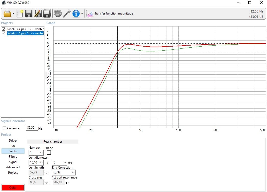

Here the simulation with the 10.2 in same BR cabinet.This will work for the 10.3 I think.
It will go nice and deep.
Red 10.2 / green 10.3.
Simulations looks very nice.
Note that given the aspect ratio of the (so-called) BR box Hondasi posted will make it an ML-TL and WinISD can’t handle that.
dave
dave
Not even same line od MA drivers...no one will ever make Sibelius at home so best try to make something that will look alike with Alpair 10.3. Dimensions of Sibelius are known, so sims with stock driver than playing a bit with numbers to get something optimal if needed
