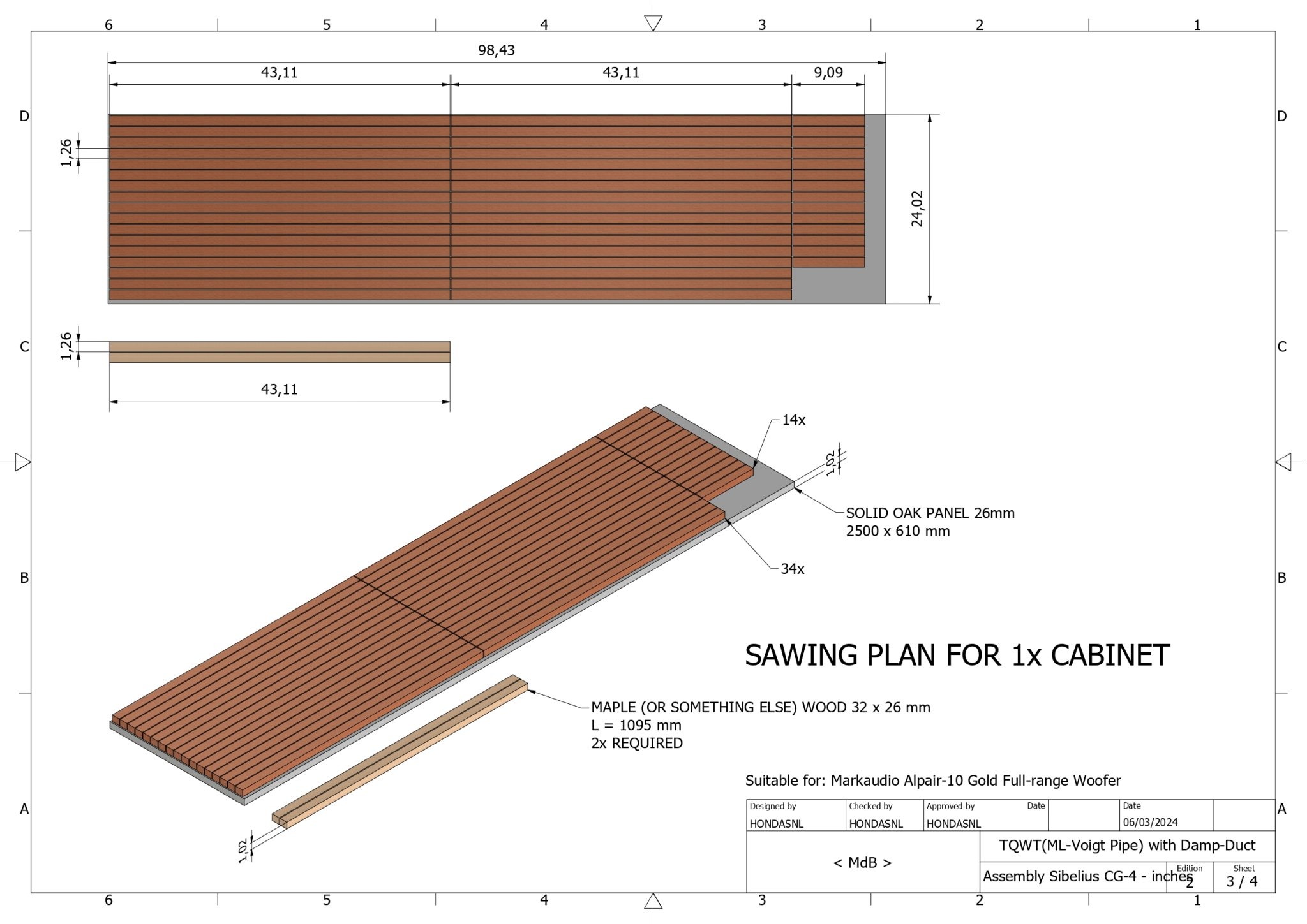

No worries Vermouth. I always uses solid panels with 2 different grain directions.

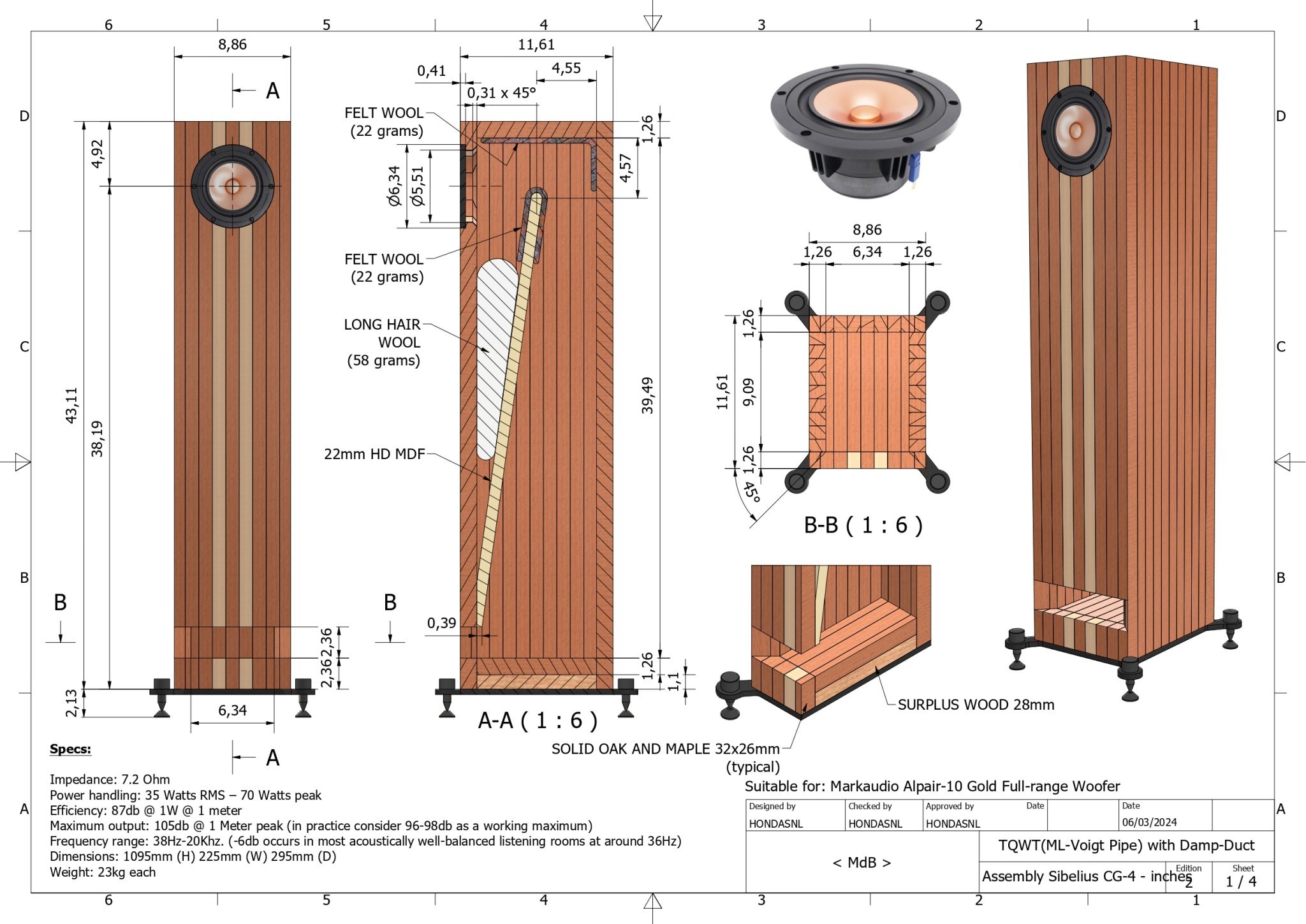

I am glad that someone is seriously pursuing this build project!!! I was working on a similar concept using the Pensil diagram with similar Voight mods.

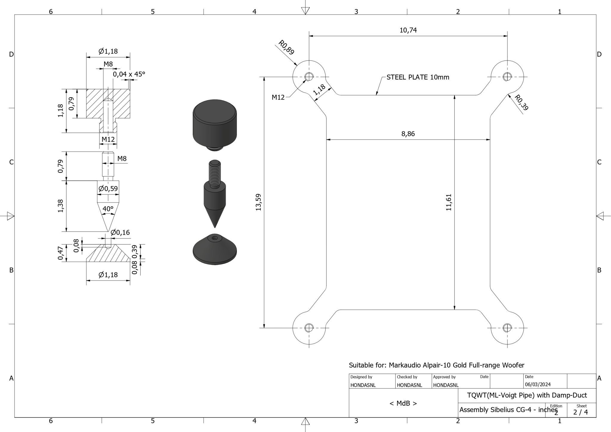

For those of us who live in the USA that want to build a pair of cabinets, how much trouble would it be for Hondasnl to convert the dimensions to English instead of Metric on his assembly diagram?
With all due respect this is a rather strange request as there are plenty of free Imperial to Metric Calculators over the net.

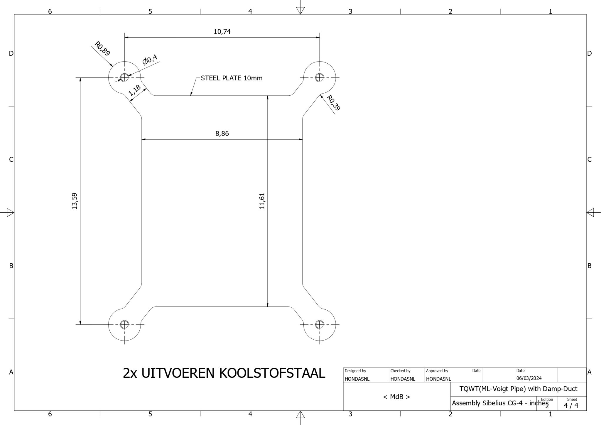

Hi a700256,I am glad that someone is seriously pursuing this build project!!! I was working on a similar concept using the Pensil diagram with similar Voight mods.
No problem.
Here the most main dimensions in inches, others still in mm.
Hope it will help you.

Understood, but the reason why I ask is because it makes things a lot simpler to attach the drawing when submitting an inquiry for a speaker cabinet build , for cabinet makers in the US.
I was thinking of how this was done on the Pensil / Altair 10.3 plans and doing a similar layout in both metric and English parameters.

Any cabinet maker worth his salt can work in any dimensions. And the ones i have dealt with have no issues with metic drawings (most of mine althou the CAD sw allows me to automagivally add imperial approximations to the metric.
And the sheet sof ¾” quality ply you buy are very likely 18mm thick.

Yes I saw the Hondasnl revision and I thank you for doing the conversion, although it looks like the baffle board is still listed in the metric size?

Since I have the floor for now anyway, I am curious as to how Hondasnl came up with the exact specs?
Did he have access to an original Sibelius cabinet to measure and make observations from?
I made a lot of guesses on my approach to duplicating this design for myself, based on Youtube video observations and information found in the different related audio forums.
I used the Pensil 10.3 plans as my initial starting point and found several Voight pipe designs that seemed to be an accurate modification as compared to the limited pictures of the Sibelius cabinets that were in different stages of construction.
Educated quess based on pictures. Not properly modeled for the driver used. A10.3 is a different driver than used in Sibilus so the box likely should be different.
