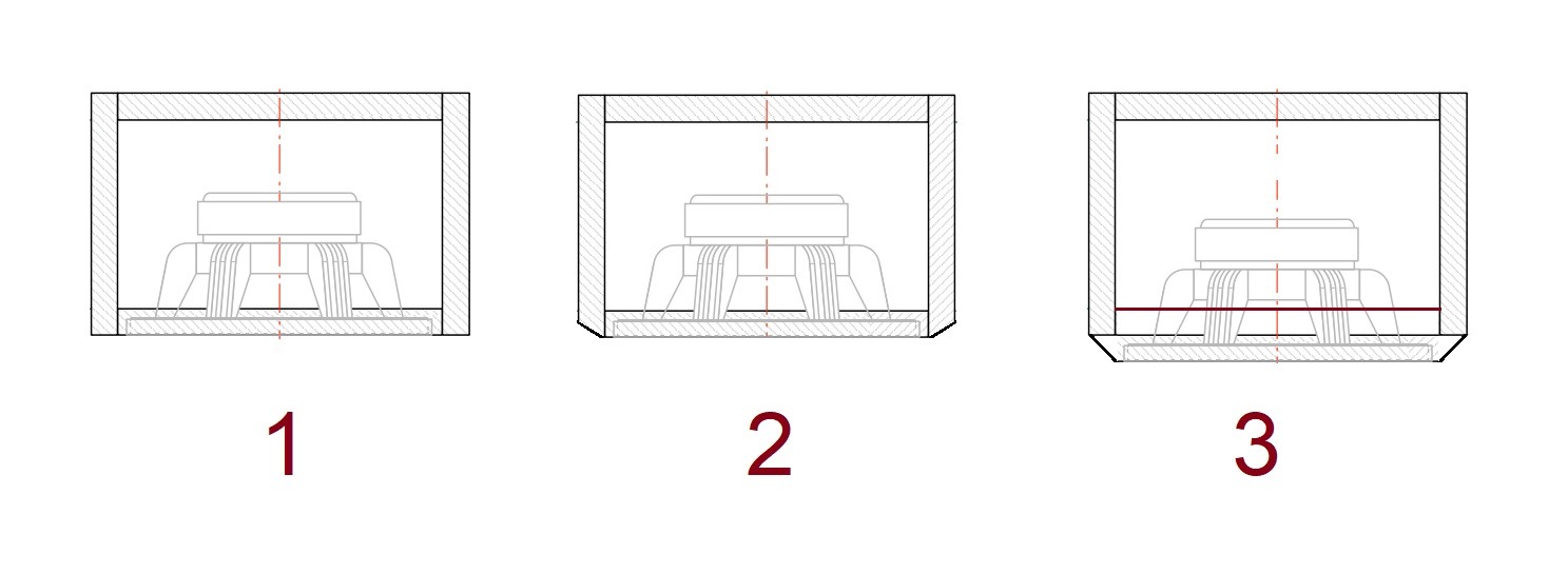

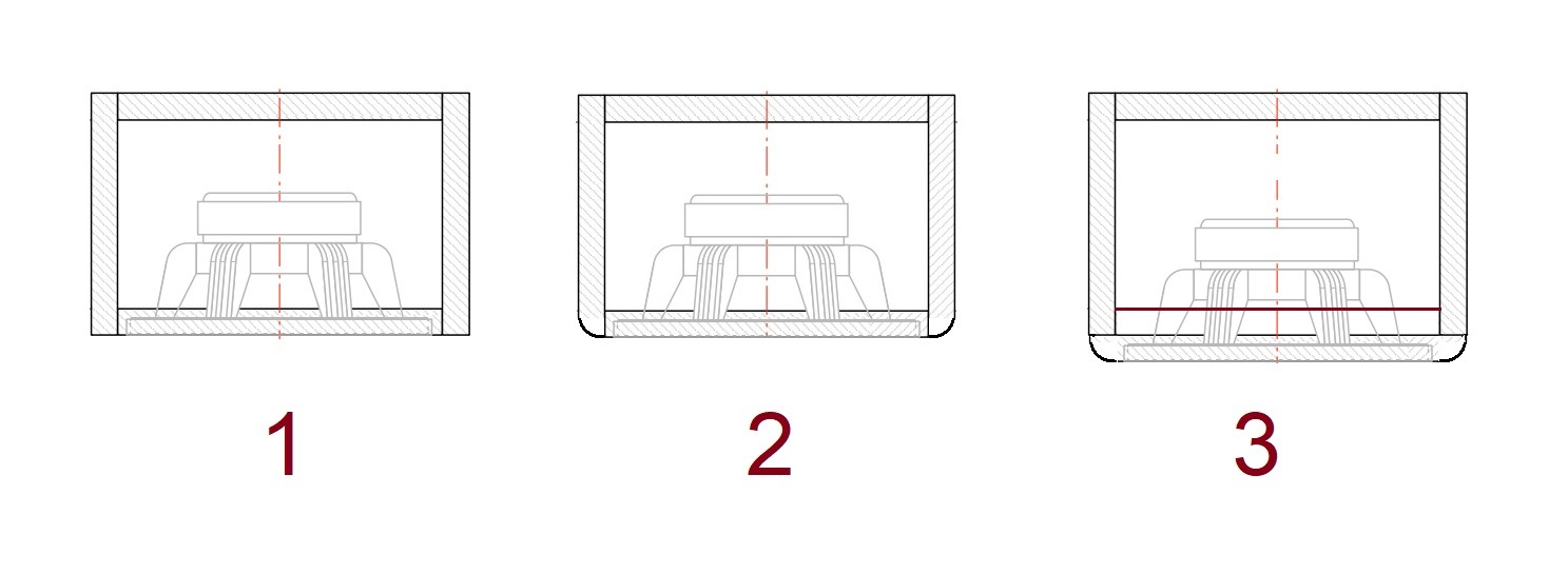

On page 5 of the FHXL build you show a section that is odds with the front elevation drawing beside it. The section clearly shows that the edges of the side, top and bottom panels expressed on the front of the enclosure yet the lines of the inside of these panels are shown dotted on the elevation indicating that they are behind the front baffle.
So which is it?
I assumed the section was correct which is why I've been contemplating adding a solid piece that would cover the edges and be "round-able".
I take it you applied edge veneer to the chamfer regardless?

There should be a section designation in the front view. You can reagrange the baffleas you’d like, or even double the baffle to give lots of charger/roundover room. If you do, i’d put tha inner baffle on the inside of the sides, outer one the full size.
dave
dave
more or less but I'm proposing to use a parabolic profile roundover bit -- called a thumbnail -- instead of the chamfer.
