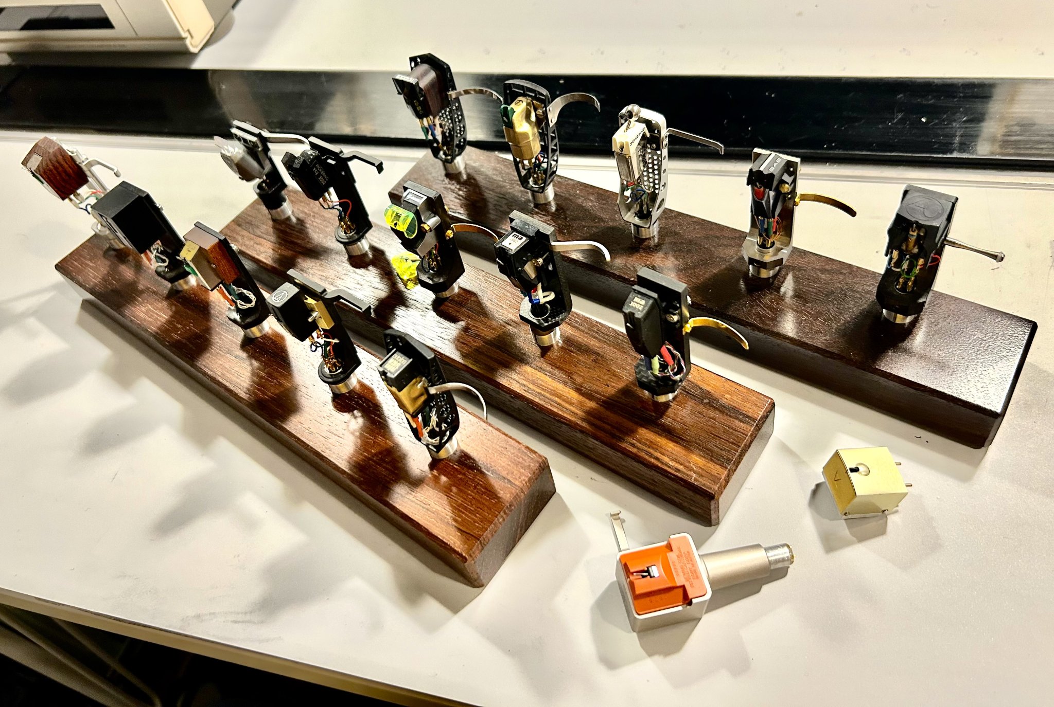

You lucky bastard 😊Going to have some fun testing things out!! View attachment 1261873
No Hanas in there though. Really want to try one…

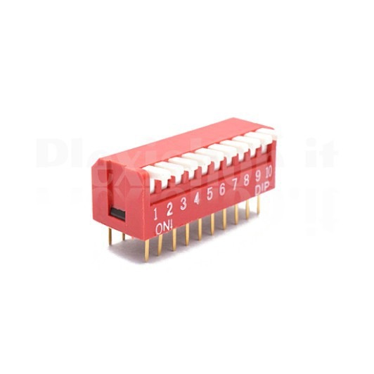

Sooo, I'm just thinking about the load selector. Wouldn't it be nice to have access to it without opening the top cover?
Why won't we mount the switch on the bottom of the PCB and have a cutout in the enclosure? So you can flip the whole thing and change settings in 15 seconds. Then add some descriptions to make it easier and we're good.
@Gianluca @6L6 @wayne what do you guys think?
That's something doable! 🙂 It would be required to substitute the steel bottom cover with an aluminium one otherwise it cannot be drilled but other than that I don't see any issue

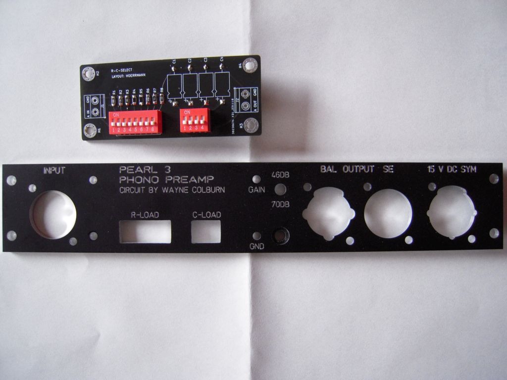

Or why not, since the dip-switch is already on the edge of the pcb, just make a hole in the back panel and use these???That's something doable! 🙂 It would be required to substitute the steel bottom cover with an aluminium one otherwise it cannot be drilled but other than that I don't see any issue
Hello out there,
for those PEARL 3-builders, who want to seperate the R-/C-load - switches from the main pcb...
I offer here my gerbers from the R-/C-selector for free.
It has to be stuffed with SMD 1206 - resistors (I like the PANASONIC and the SUSUMU), the Cs have
a pitch of 15mm. So you can use CornellDubillier SilverMicas, Styroflex, WIMAs, KEMET-foils and more...
You have to order the pcbs on your own. I have tried it at JLCPCB - worked. And I will be in no case responsible
for any damages!
Have fun!
