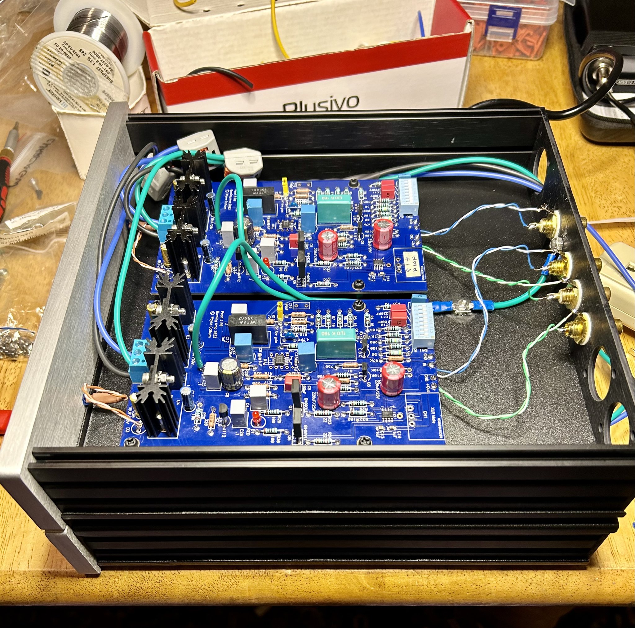

First test power-up picture. All good so far. I made a temporary +/-19VDC supply with two Dell laptop bricks while I wait on power supply parts.
I will finish the build this evening.
I was the trigger happy lucky one :devilr: to get the completed boards from Jim.

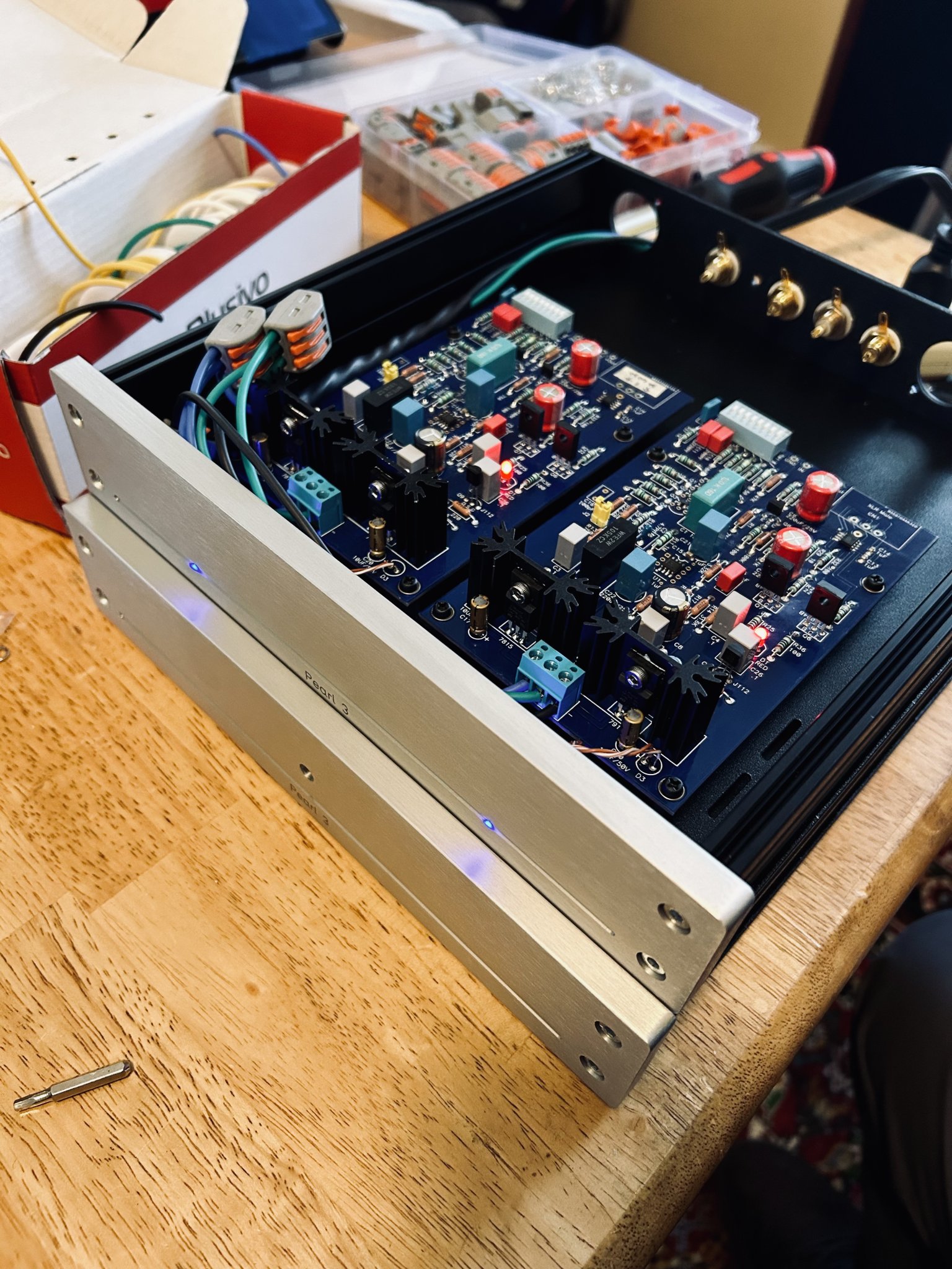

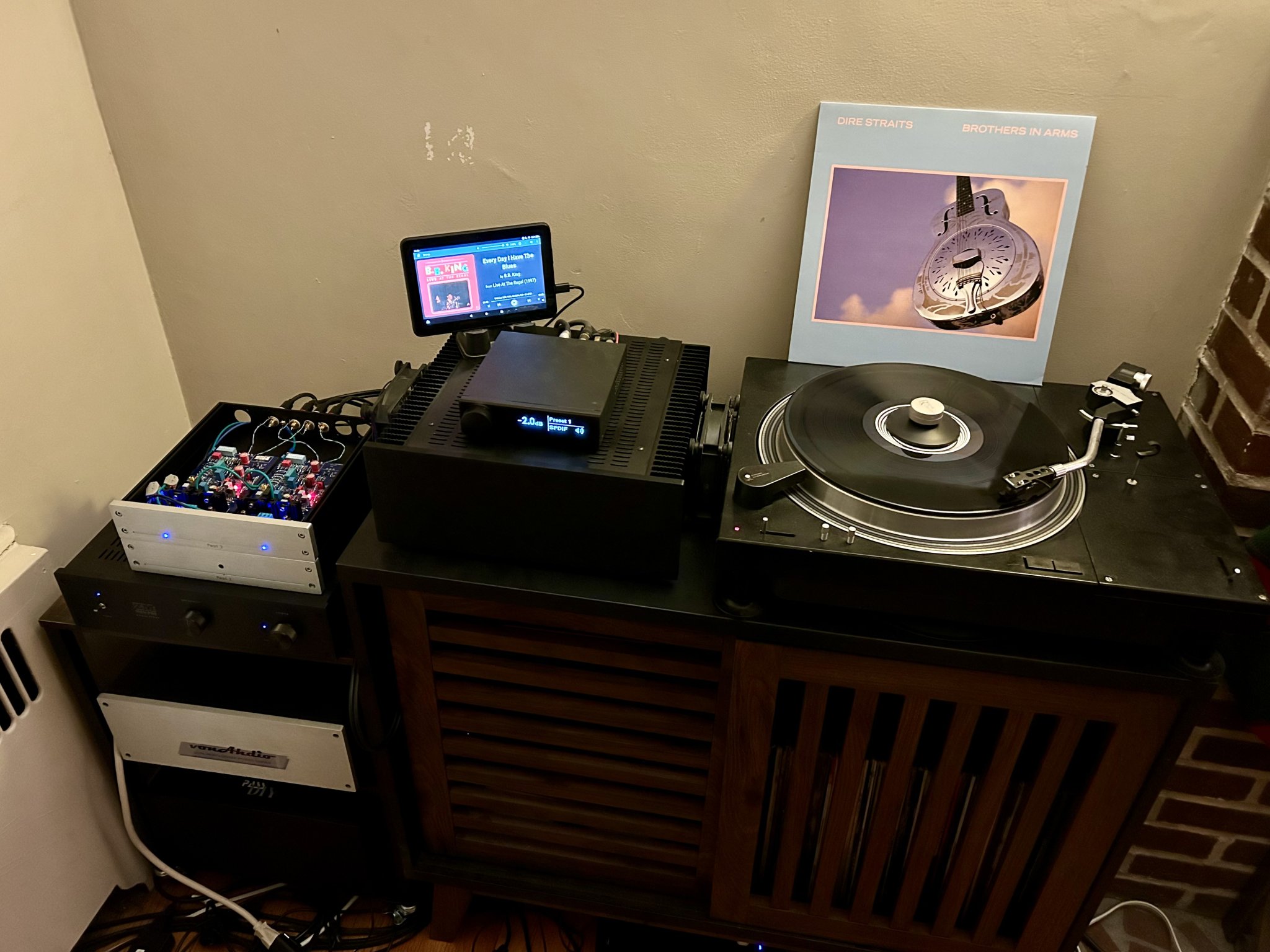

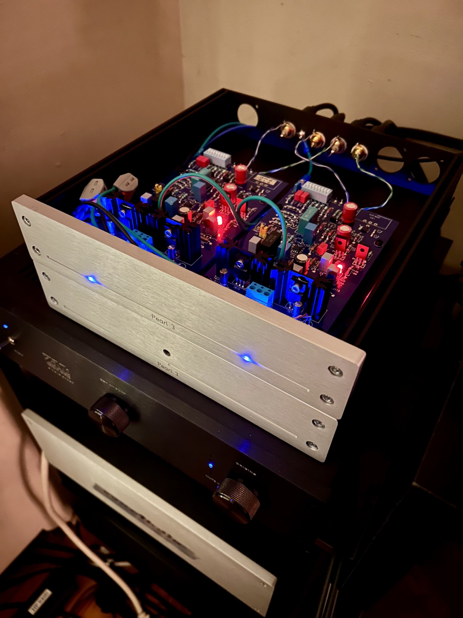

Temporary setup done.
Oh wow. This is EXCELLENT. Not a hum nor a hiss with sub-optimal power supply and sitting on top of the Iron Pre.
Wayne, you knocked this out of the park! [Insert effusive audiophile praise language regarding resolution, clarity, texture, etc.] :yes:
Thanks to the whole team for making this wonderful machine come together for the diyAudio community. :cheers:
I’m gonna be up late with this warm glow.
