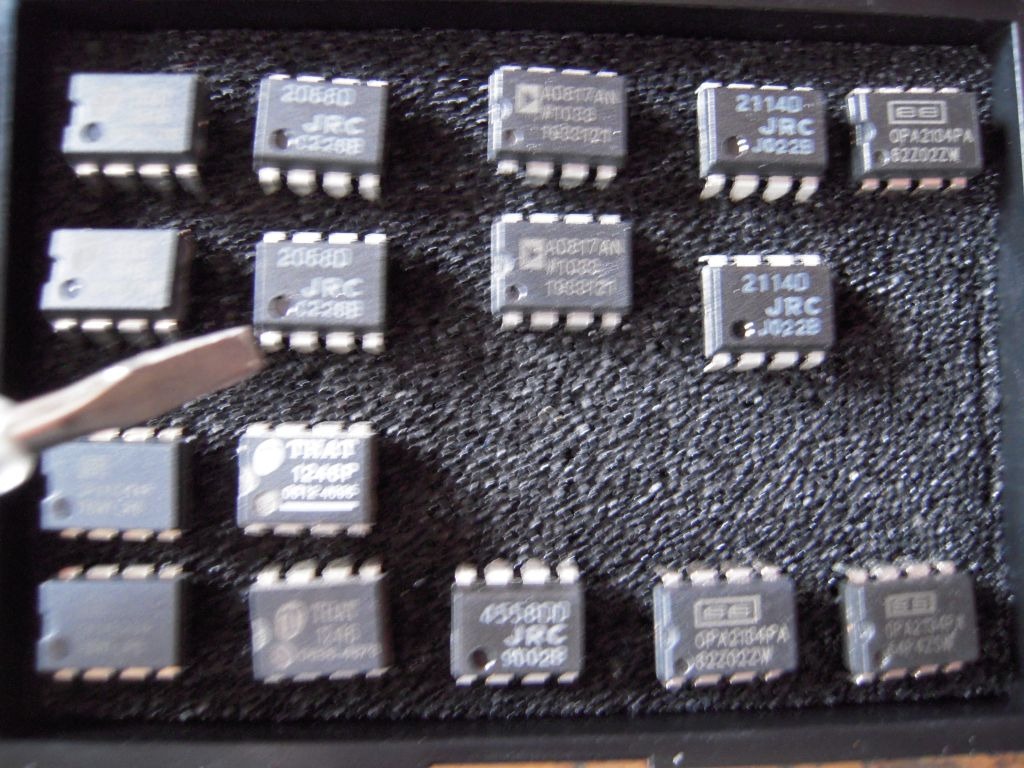

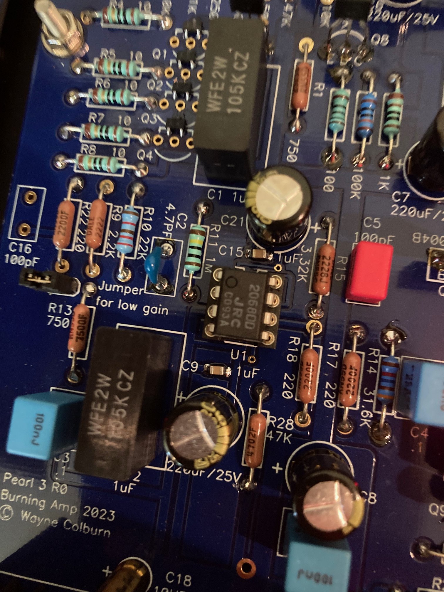

I received this (pictured below) mystery-to-me op-amp as a gift from @6L6 in my Pearl 3 build kit and I couldn't resist trying it as my first op-amp roll. I still don't know what op-amp this is.
First impressions on a classical record were of mellowness and smoothness, almost slowed down compared to the OPA2604's I started with. That led me to a not-great jazz soundtrack and later some more difficult modern records, as I wanted to challenge the playback a bit. Despite the somewhat recessed sound, I didn't feel like this op-amp called attention to the mastering or recording of the records I'd chosen in any way that bothered me- Jack White's complex orchestrations were plenty separated & balanced. Alabama Shakes sounded quite good, and this is a recording that can sound a little narrow or skewed in places.
Tonight I decided to roll amplifiers, swapping the F6 for a non-lottery lottery Sony p-channel VFET. While the midbass whoosh (I don't know what else to call it, it's a VFET/SIT thing) was there, the treble extension was even more muted now. I'm listening to different stuff tonight, as I do, so it's not an A/B but even still, the mood is there. Just goes to show it's worth playing with amps while also playing with op-amps.
This is a super cool Christmas present, by the way. Happy holidays everybody. :santa2:

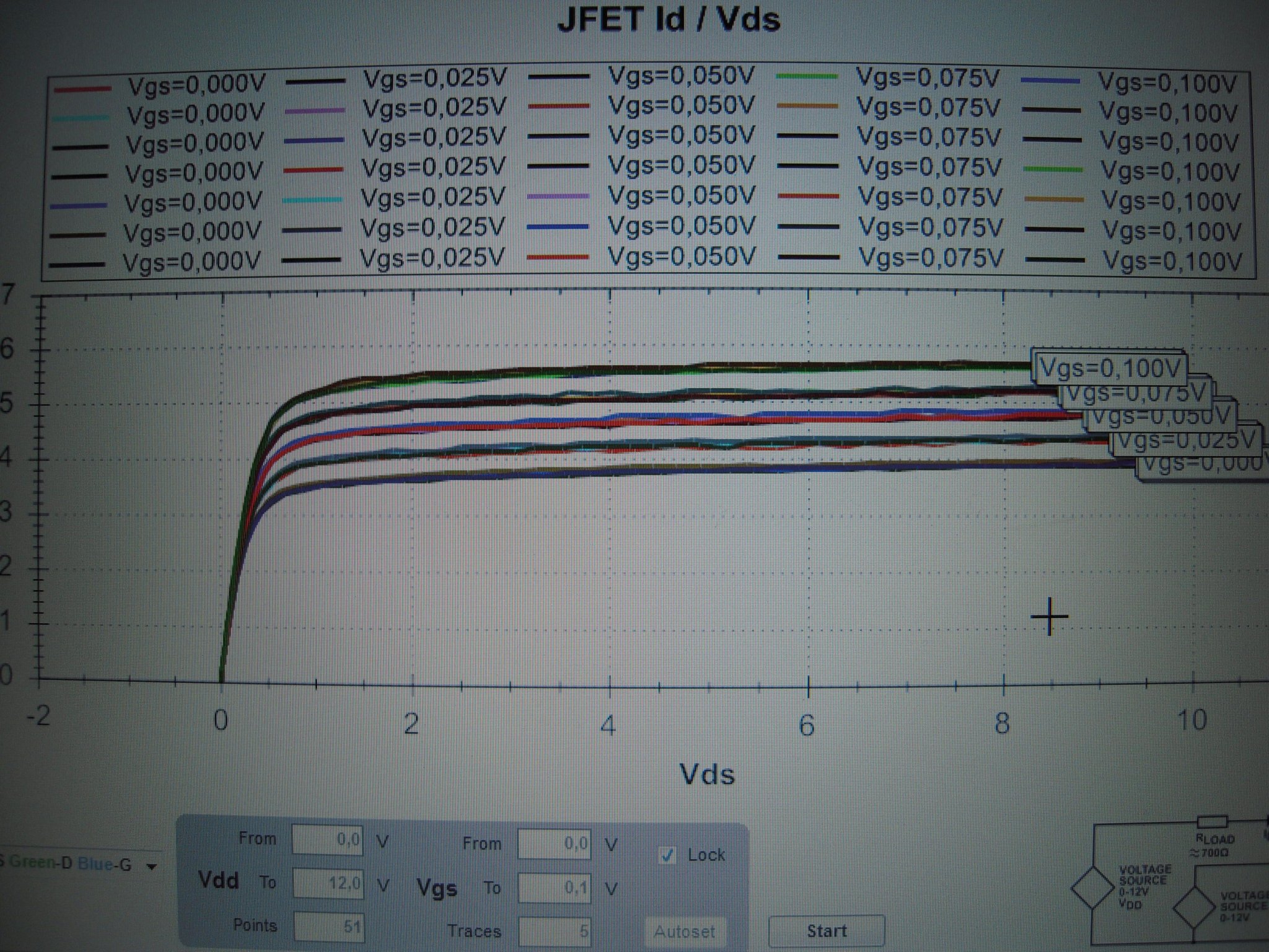

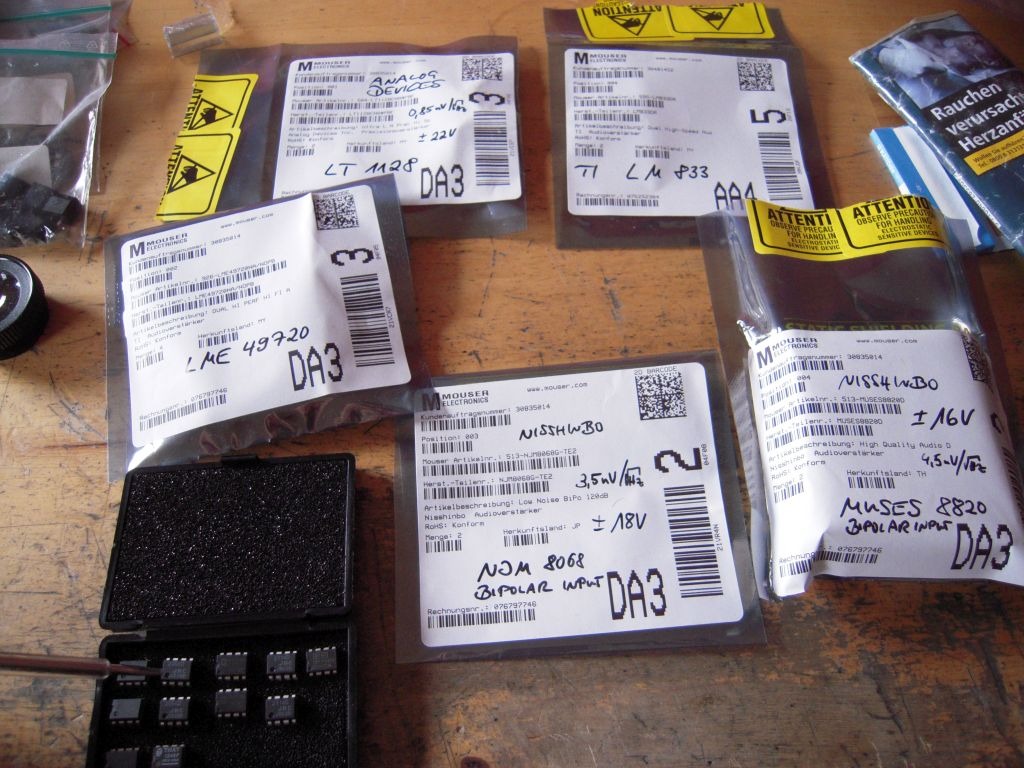

Started to stuff a second set of my PEARL 3 -pcbs... This time with the TOSHIBA 2SK209GR as input-JFets.
Matched an octett. Needed only some more than 20. They are pretty close off the role - as Wayne mentioned.

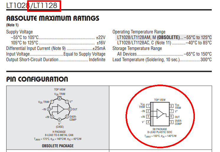

And still playing with the OPAmps. Some of my favourites till now: TI OPA1656, LME49720
The ANALOG DEVICES LT1128 didn't work. Don't ask me why?
Have fun!
Cheers
Dirk 🙂

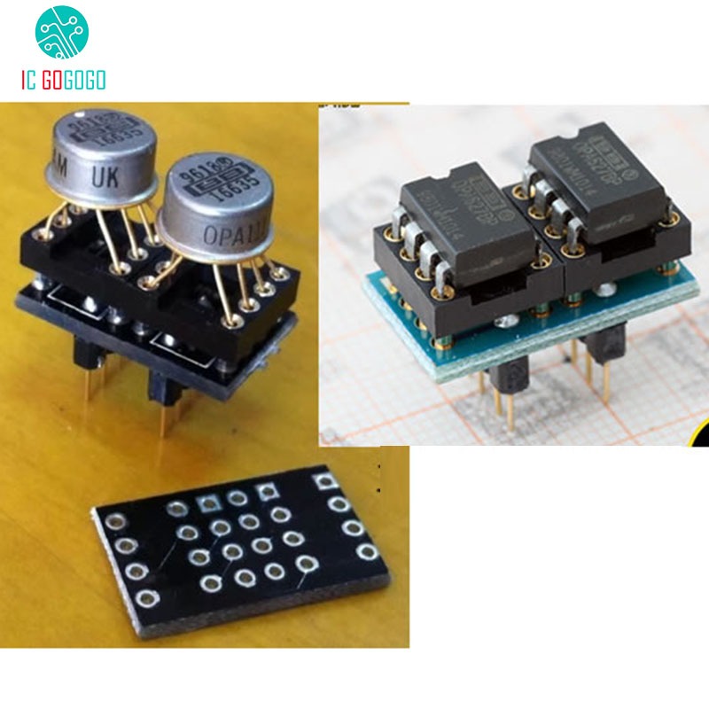

The Analog Devices LT1128 appears to be a singleton. Its 8 pin package only contains one opamp circuit. However the Pearl 3 PCB laid out by W. Colburn requires dual opamps, having two amplifiers per package.
_
Yup,
silly mistake... 🙄
But I still have adapters from two-single-OPAmp to dual-OPAmp. Will see if there is enough place around the DIP-8-socket.
Thanks for the hint!
Cheers
Dirk 😆
