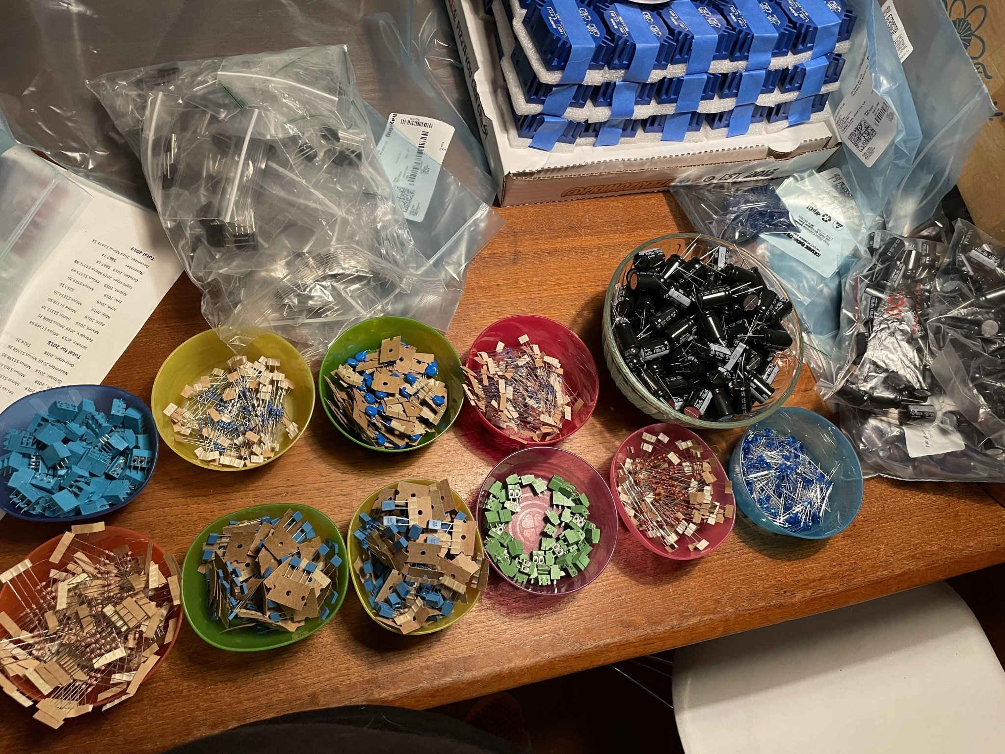

@brianco Yes, there will be more kits as soon as I get PCBs, and there will be a ‘regular’ (non-pioneer) version at some point.
Standard gain is 46db / 70db and you get an extra 6db if you use the balanced line driver. You can, of course use whatever resistor value(s) you like to have a gain in the 40-70db range.

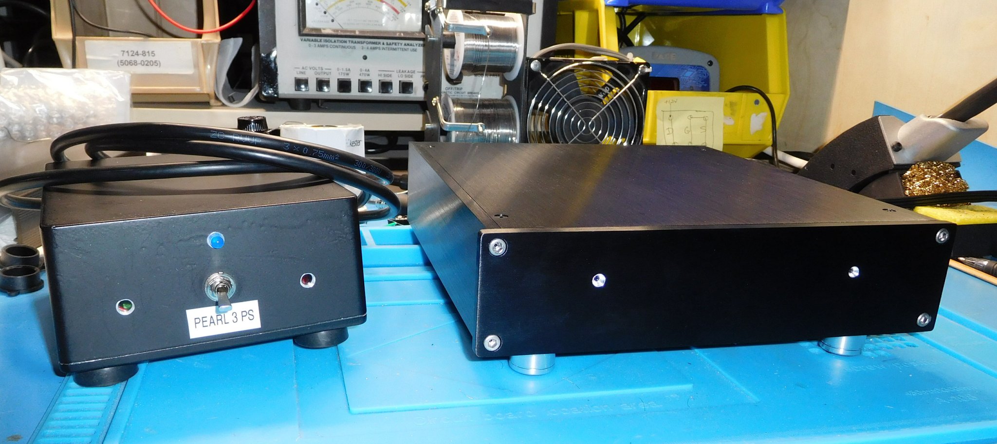

I will also observe that the preamp box should far removed not only from its mains transformer, but ANY mains transformer. It would be a shame to do a careful job and then set it right over your Iron Pre. In my present system there is a remote PS box with Independent supplies for the preamp and the Pearl 2, each fed over its own umbical.

I am glad for those who got kits. Is there a time frame for more stock?

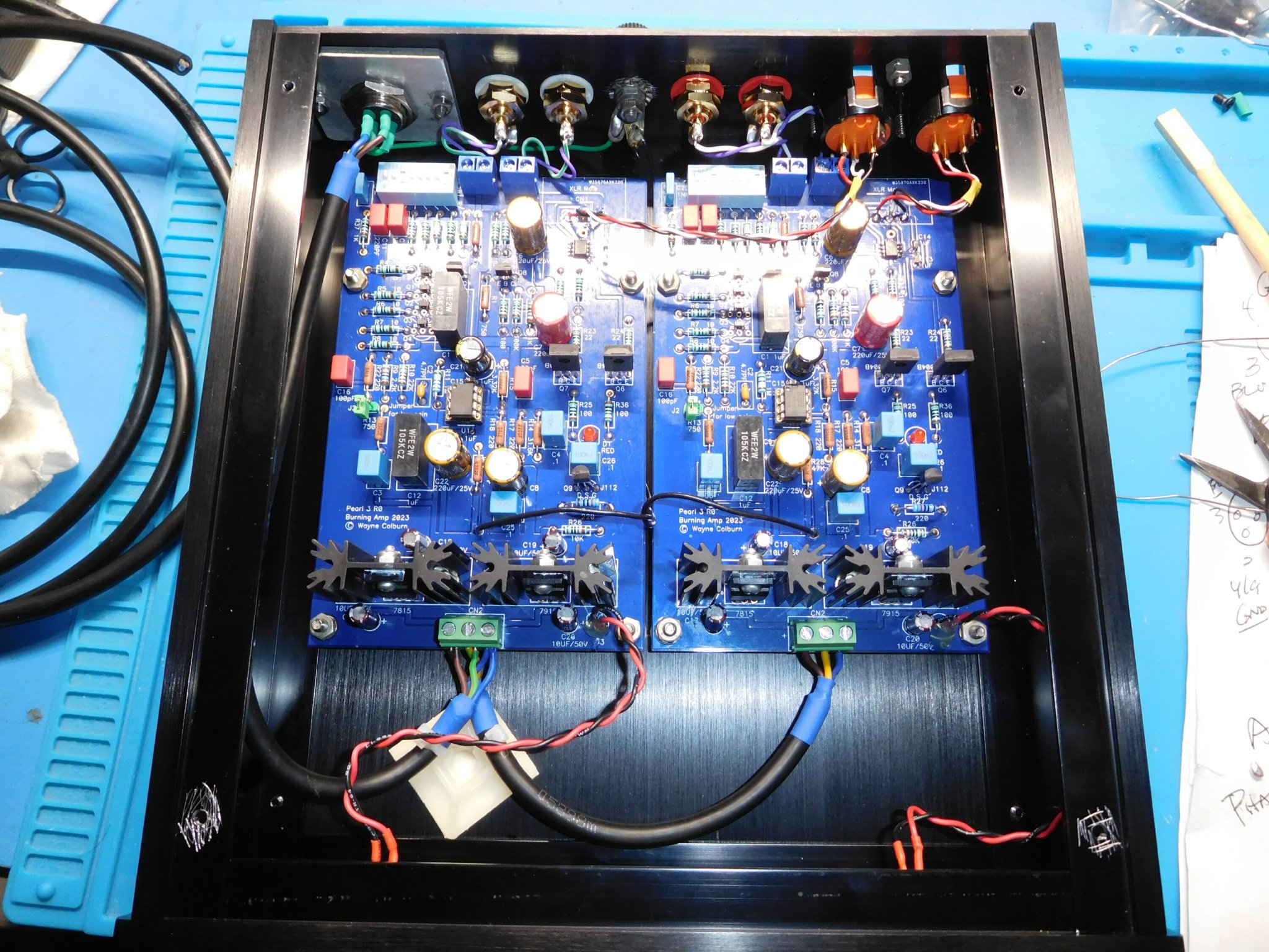

Got up early and re-wired and re-terminated the power supply umbilical cable - shield now grounded at both ends. Had to get it done right away - Santa is bringing a lot of new vinyl!

Did you use the small cap solution that Wayne suggested?shield now grounded at both ends
No, wanted to start with direct connection as baseline. It is still really quiet, and we've been using it for 2 hours already this morning. Looks like Christmas Eve and Day will be all vinyl days!
There is no audible difference in noise/hum with the shield connected at both ends, but at least now I don't have to worry about other negative effects of my previous arrangement.

Thank you so much!Beautiful workmanship!
Have to admit, though - nice to have a lathe/milling machine and proper measuring/layout/milling tools.
By the way, have I mentioned that this thing sounds reeeaaaly good? 😀

My Luck. (bad) I just realized that I should have stayed up all night... How long before the next batch of pearl 3 kits will be available? Can we pre-order? I hate getting sniped on ebay also...
There will be enough for everybody. I promise.
I read page 7, figure 7 as the overall shield is tied to the equipment case, I.e. chassis, so yes, tie shield to chassis. GND by itself is an ambiguous term.
