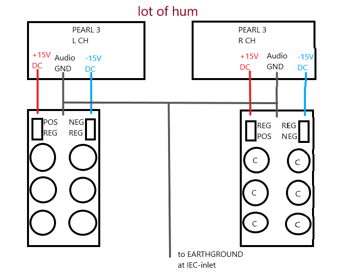

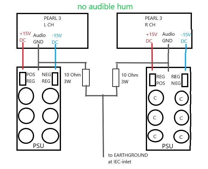

Hello PEARL 3 - builders
I put 10 Ohm - resistors between ground-output PSU (where audioground from PEARL 3 is attached) to earthground at IEC-inlet.
This slight groundlift has taken away all hum. It is deadsilent. So, I had pretty sure a groundloop. It was 50Hz-hum...

At least for my tone arm, Grace 707MKII, the arm is floating metal, grounded only through the cartridge ground wire. The turntable plinth is insulating. So my ground post will be at shield/chassis ground, which will be isolated from the signal ground. Board grounds go to signal ground, not shield/ chassis.why does it make sense to connect the circuit board grounds to that "shield" terminal rather than run them back to the signal side of the bridge in the PSU? Or ground via the power supply?
If this was a one box design wouldn't they be wired directly to the bridge while the post would connect to the earth/chassis side of the bridge?
I must add, this is only a going in proposition. If it works, great. If it doesn’t some tinkering will be required. It is a best practice, not the only practice.
I think the reason some cables are directional is because it can be hard to tell if all boxes maintain chassis isolation unless someone imposes that requirement. As I noted, I bought a very nice digi attenuator only to find that it tied chassis to signal internally. There are many situations where partial chassis isolation can be worse than none. But if you build all the bits you are master of your destiny.
