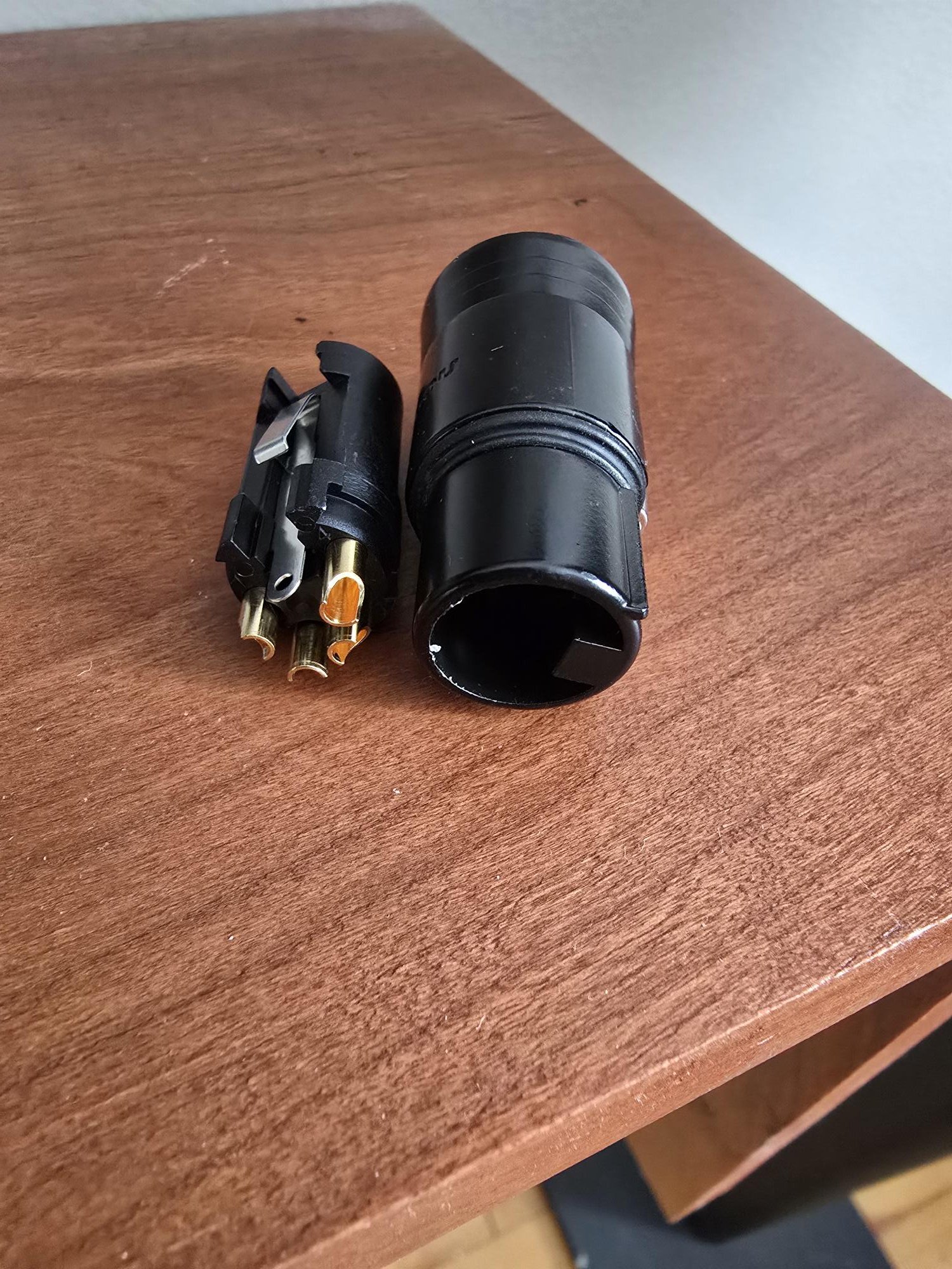

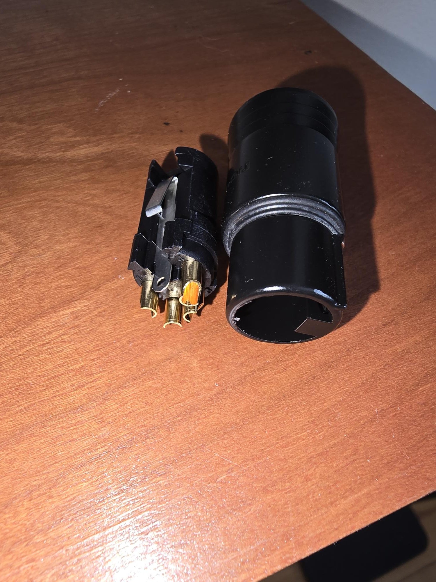

@raduschka - are you talking about the plug or the jack? If the plug, they disassemble so you can solder the wires to the pins. Which plugs are you using? Post photo or part number, please.
If you are talking about the plug, you can also buy assembled 4-pin XLR cables and cut off one end.
Never a worry. That's why I like photos and part numbers.I guess I am talking about the female end of the umbilical.
The female end of the umbilical does need to be disassembled.
568-NC4FXX-B
Unscrew the wire retention / strain relief (if it came assembled)
Push here... (photo) to remove the insert.
Solder to the cups on the back...
Slide it back in.
Reassemble...
Edited to add -- make sure to slide the strain relief / wire holder over the wire before soldering, particularly if there is anything attached already to the other end. 🙂

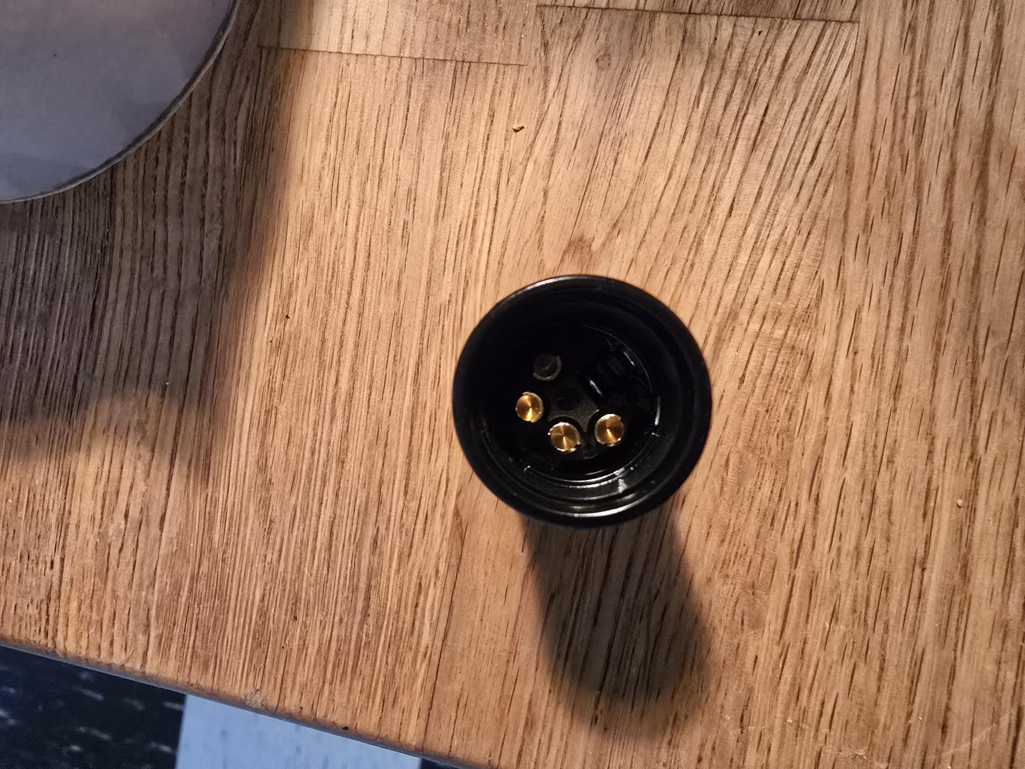

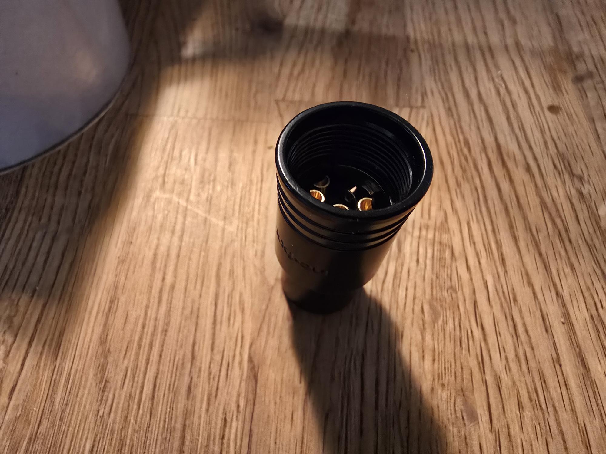

aaah, relief! So that's how it goes. Thanks a ton. I was about to upload pics, why not go ahead anyway

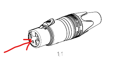

Assembly instructions from Neutrik -
https://www.neutrik.com/media/8050/download/xlr-xx-series.pdf?v=1
And pay very close attention to the pin numbers when soldering, particularly the jack, as from the solder side they are mirror image.
thanks. I am now struggling to put it back in place, it slides right out, I have to figure out why.

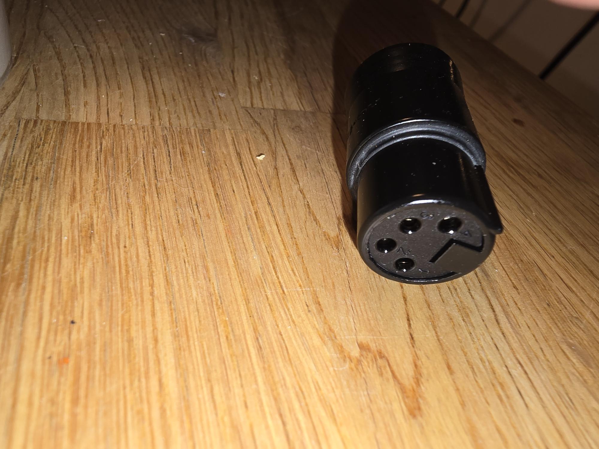

The inside of the barrel is keyed. It’s mentioned in the linked instructions above.
From the 'real' instructions from @6L6.
It only goes in one way... you'll get it. The "guiding key" is the key.

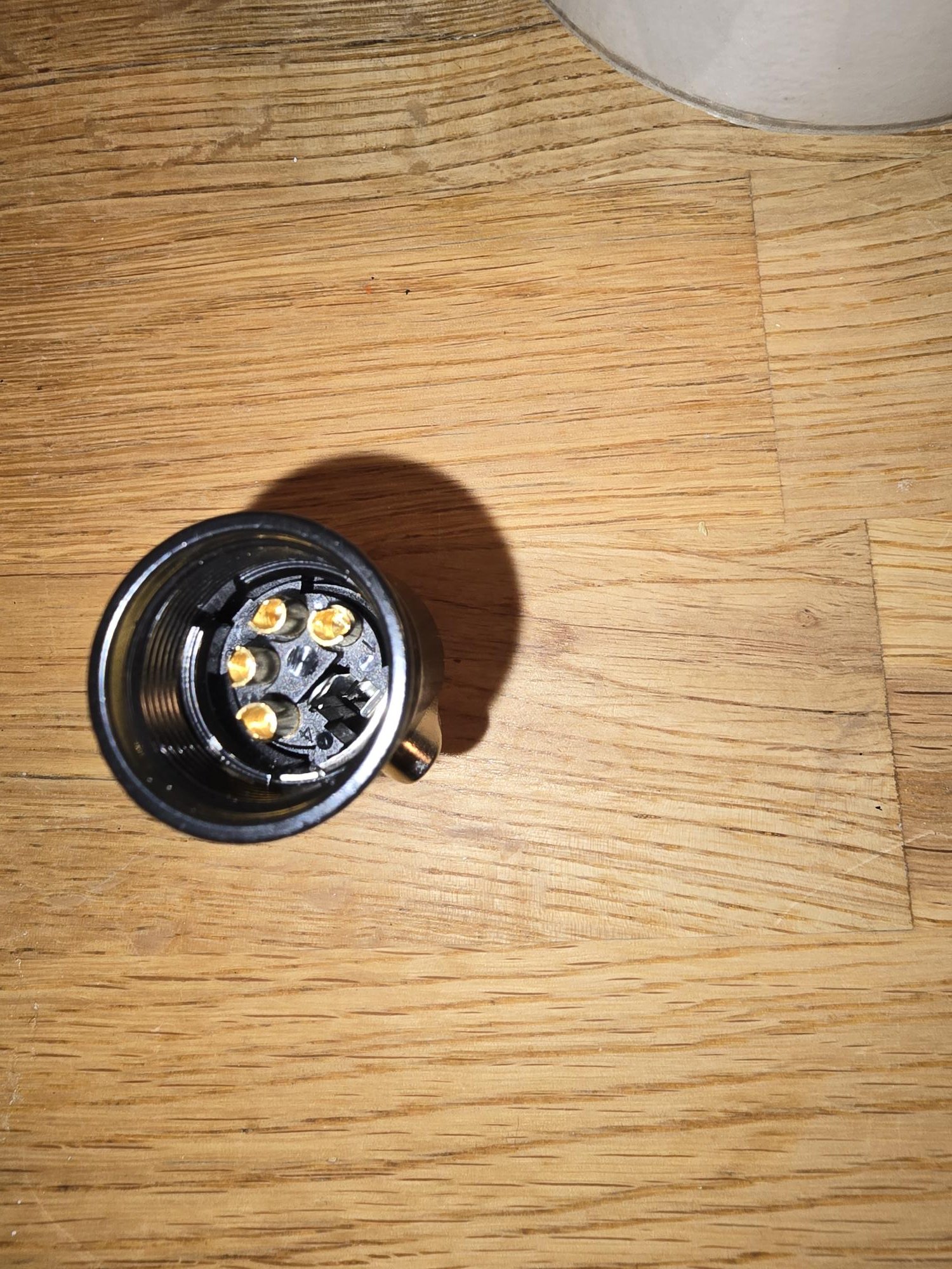

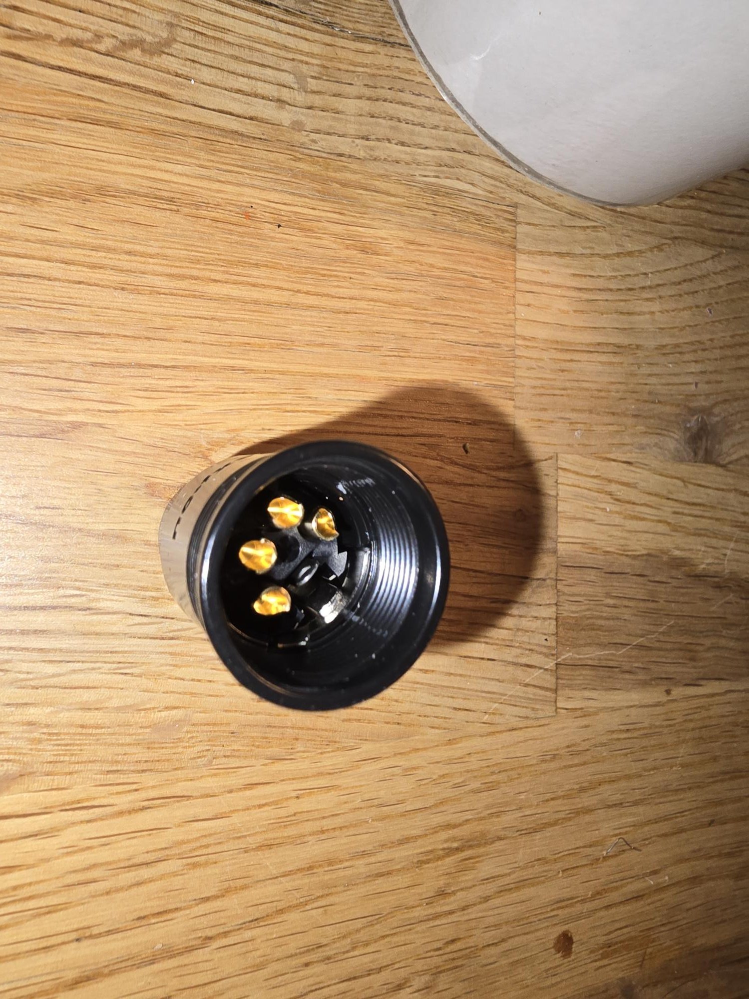

I m embarrassed to keep you busy with such a trivial issue. It goes in all the way alright, up to its place, but then it comes right out if I push it, whereas before the procedure it was solidly in place. It doesn't seem to be the tension in the metal lever attached to the inside bit, I raised that up a bit and still nothing.
good to know, because no matter what I try I cannot get it to stay put. I wonder if it was like that in the first place.
i m starting to think so. The little springboard on the inner piece only serves the strain relief button, it has no retaining purpose.

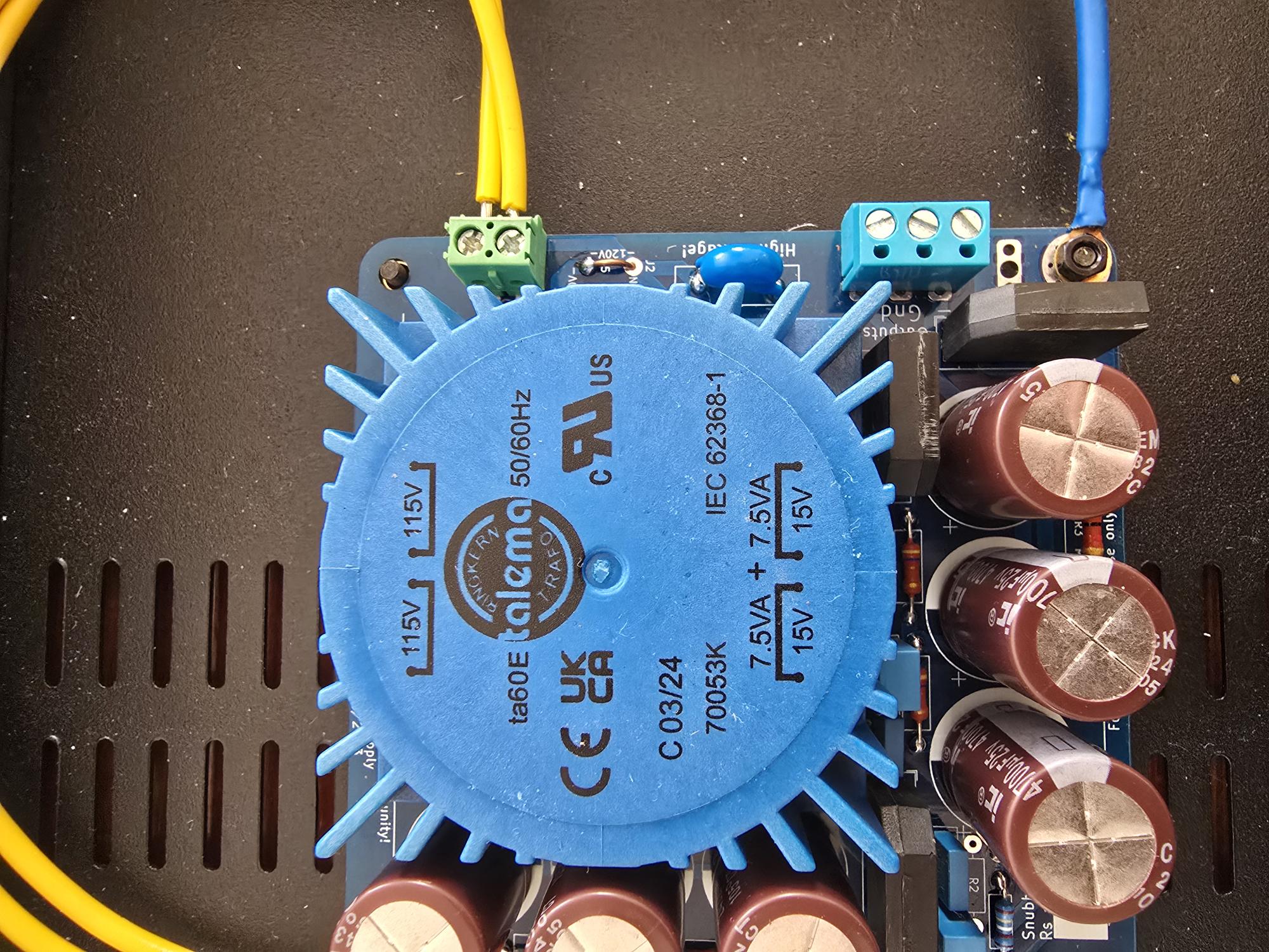

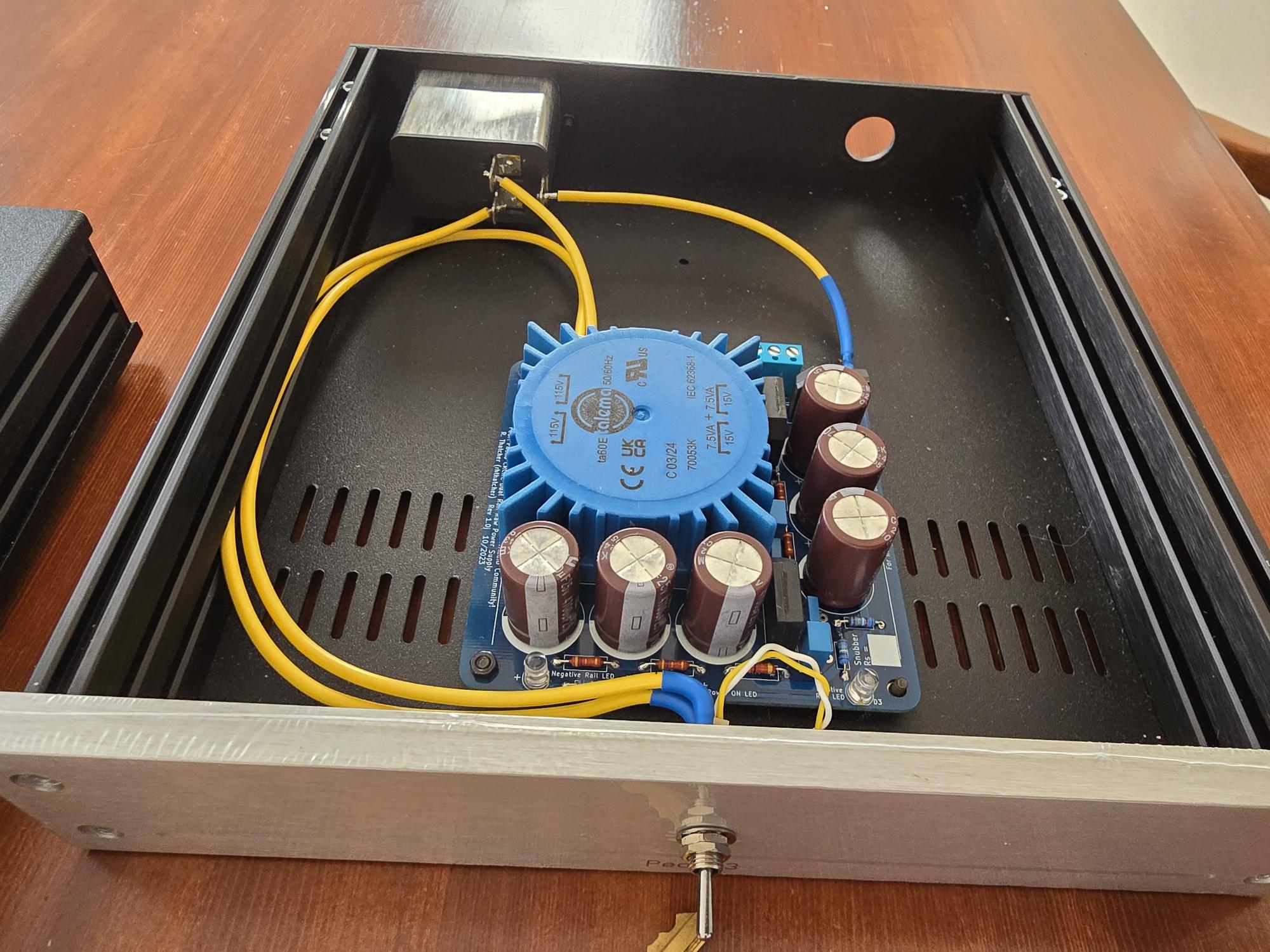

Seemed somewhat difficult to source the Amgis or Talemas in Europe atm but this beast looks like it’s gonna do the job right?
Electrically that should work. If you're using the modushop chassis that might be too tall. 15 and 25VA have the same footprint, but 25VA is taller.
I am not, so I have to diy something, thanksElectrically that should work. If you're using the modushop chassis that might be too tall. 15 and 25VA have the same footprint, but 25VA is taller.

Please make sure the metal standoff at the chassis ground corner is touching bare metal on the chassis. Scrape paint as necessary to ensure this.
