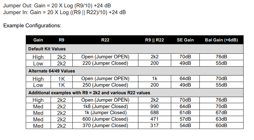

Thanks Mark, so if I configure the ADC input to 300mV rms FS it will cover most of the expected levels? e.g. following something like attached specs

Output_Level = Input_Level * Gain
Gain is constant, and its value is written on the Pearl 3 schematic. Input_Level varies from cartridge to cartridge and from one recording to another.
Not quite
This is the schematic, from post 1... the gain is confusing.
70db gain with 2.2 Kohms,
49db gain with 220 ohms
or
46 db with 2.2 Kohms.
Which is it?
And how about if you need a gain in between, say for a 1 mV Grado cartridge?
If my gain calculations are correct,
, for a 2V output, given an input, the desired gain is:
5 mV = ~52 db
1 mv = ~66 db
0.5 mv = ~72 db
0.3 mv = ~76 db
So, what is the correct resistance value for a 66 db gain? Is the gain equation ( in terms of resistance ) linear? -in which case I can figure it easily.

@tonyEE Yes, the gain equation is linear.

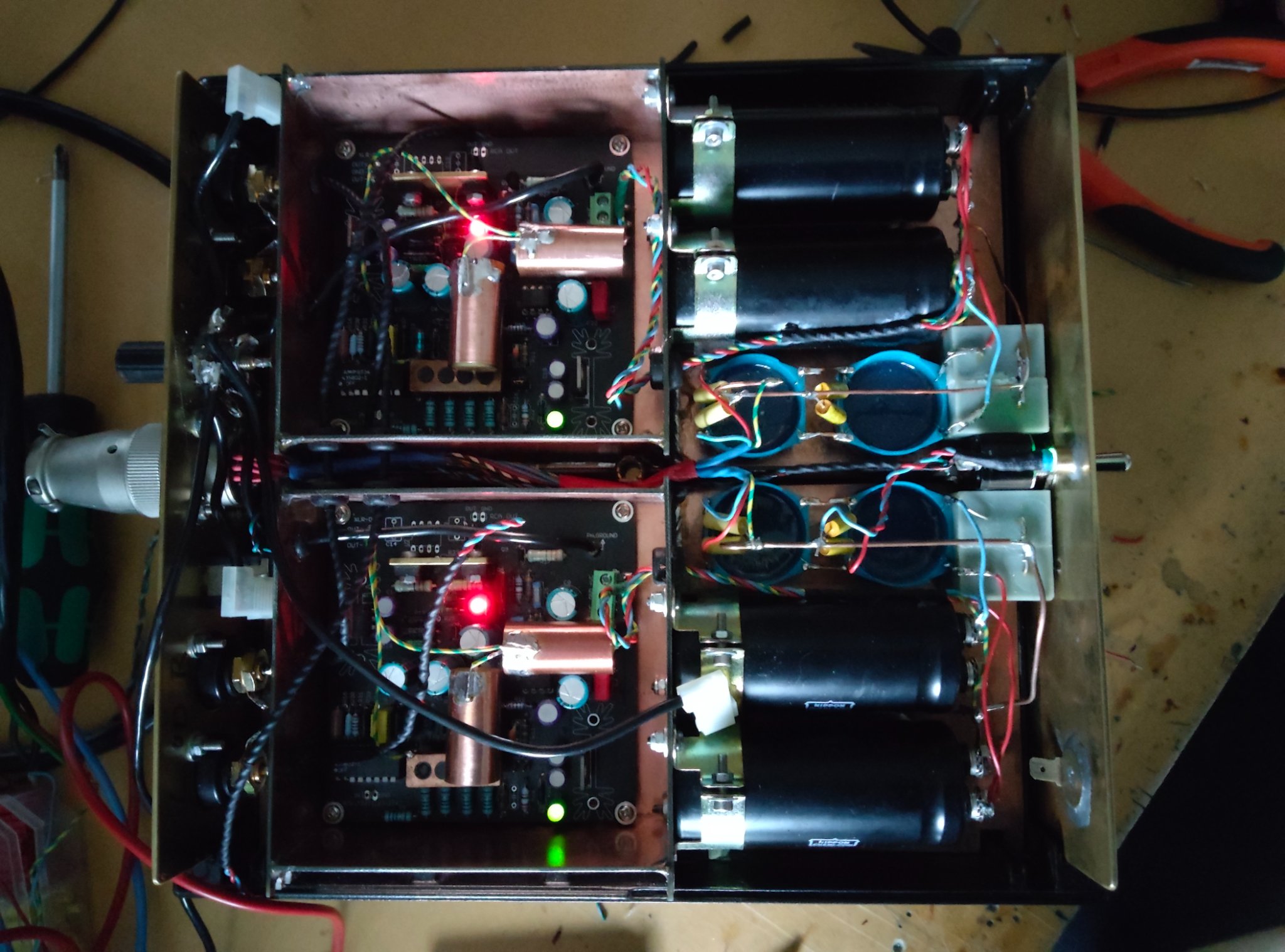

Regarding power supply for pearl3 what do you think about my approach.
The external psu consists of dual toroids, dual regulators sigma22 regulators, theese feed through umbilical cable to phono,
Phono has two per side common mode ckokes and decoupling, this then feeds four 10000uf capacitors, they are bypassed with film type caps, this again feeds the pearl board regulators.
I chose a chain of filtering, and choose large capacitors for low impedance.
This is done by heart , im no engineer, the sigma22 regulators seem happy about the large capacitors, no oscillation, total dc resistance from reg board to pearl board is 7 ohm, mostly the chokes.
I have tried measuring af noise, but levels are to low for my gear. Could be rf and other stuff
