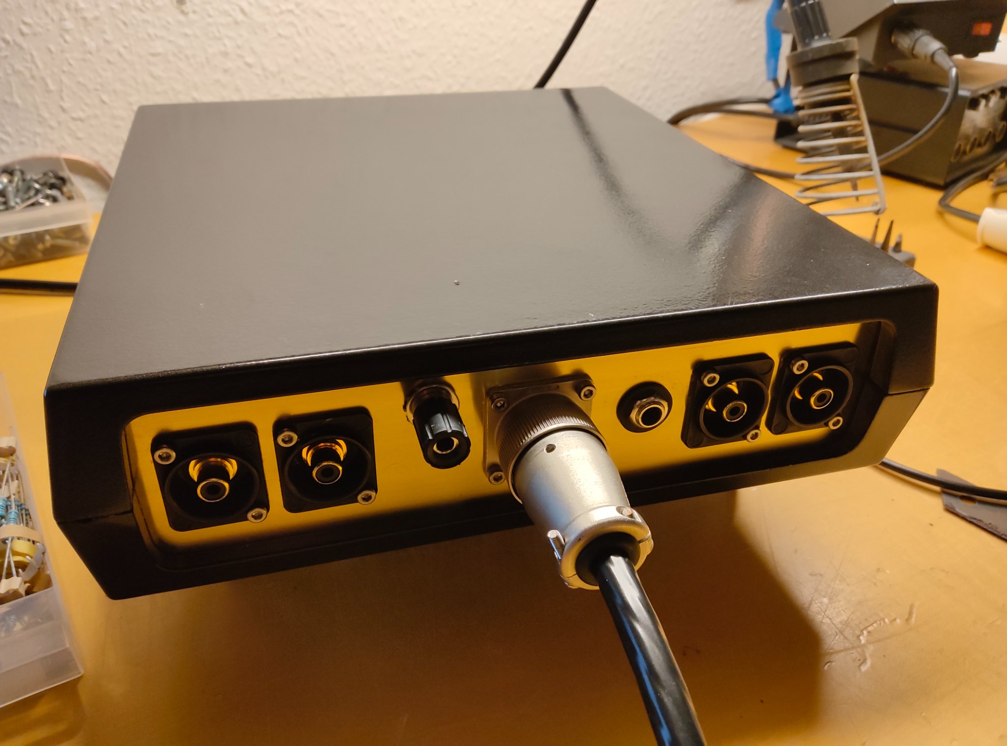

Hello. I am stuck at the umbilical wire gauge and cable model. I can t find a suitable mogami cable,
There is one listed in the build guide as used by the author, but I am not quite certain that it's the cable shown in the photographs.
There is also another Mogami, and a Canare cable listed in the build document.
26awg. is that sufficient? thanks
I personally wouldn't give it much thought unless I was intending what I'd consider a VERY long run.
I used a umbilical cable for use with car and trailer, 1mm2 and 7 cables, full dual mono, did i mention cheap?
Ohms law still applies, even for dig high end diy, 120 miliamps.
Ps, wanted screened cable but had to buy alot, impedance is ridiculous low so who cares about 1.5 meters.

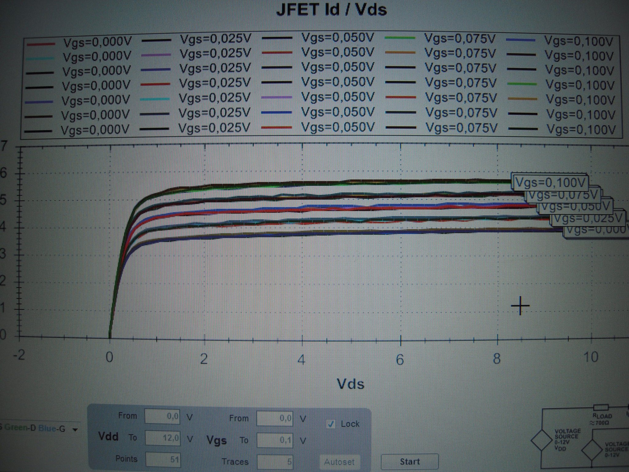

@amplidude @Boydk In order to match the channels, would it not be preferable to measure the betas of the transistors at their operating points, and vary the resistors to shift the operating points around to achieve similar operating betas?
That´s why you have "Curve Tracing". Similar/matched transistors need similar/matched resistors to draw similar current, versus
vaired resistors, cause transistors are not equal/matched 😉
Reactions: integra
For my project i used two octect af matched jfets from punkydawgs, then i matched theese together myself once more.
I used my agilent 6.5 meter with pc software, did less measurement of of, meter did 15000 readings after 1 minute warm up ,and the i used the average as guideline
