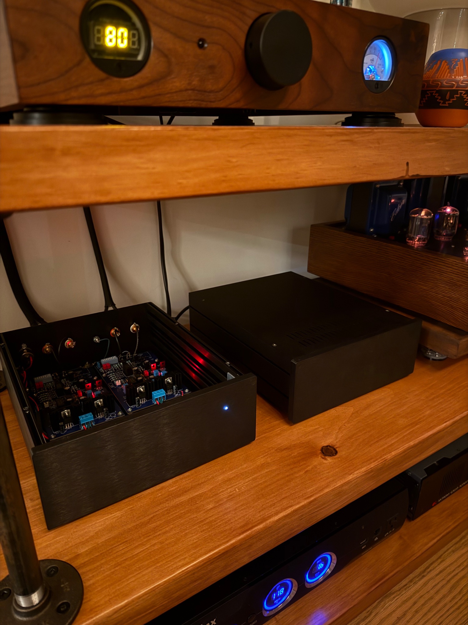

This was quick project, swapping the guts of my Pearl 2 for the new Pearl 3. I built the Pearl 2 in 2021, and have really enjoyed it’s sound in my system.
Now I am not sure if the slight gain increase of the Pearl 3 vs the Pearl 2 (61dB vs 60dB) contributes at all, but right away from the first listening of the Pearl 3 I was impressed! I won’t get in to using audio words but I much prefer the Pearl 3.
Looking forward to trying different op-amps, and experimenting with the cartridge loading DIP switches.

It's been a few months now since I got my Pearl 3 running. Opamps are Burson V7 Classics. I'm using a SoundSmith Carmen moving iron cartridge. I have lowered the gain to 40db and I'm really, really enjoying the sound I'm getting. Previous phonostage is Pearl2. Many thanks to all the folks that have put in some much effort here for all the group buys and the EXCELLENT documentation. I'm building a second one for a buddy now. Thanks!!

@Boydk : I'm interested in your findings with regard to the 2SK2145. Do you notice lower noise due to double the amount of jfets? Did you use Y-grade devices with low Idss?)? Any changes in resistors around Q5 to keep the voltages correct? (R4 to R7 are still 10R I see). Ralph Stens does something similar with 2SK2145's in his XONO 2019 and mentions changing resistor values.
Well....... I received the missing components ahead of time, and I finally did it.@Wellerman
I still need some components to finish this build. Will respond to the Q´s as soon as this is done, and I have listened
for some days.
Around Q5 I´ve kept the original values (for now). Same with R4 to R7. When up and running, I´ll measure the voltage drop
over the resistors and probably consider alt. values for R4 to R7. Around Q5 I´ll need to measure first.
And regarding the IDSS...... Not "Y". Went for "GR"´s.
Am a bit busy at the moment with other stuff, so this will come along mid/late february.
Unfortunately, this kind of builds leaves you with an excess/overstock on components 🤣
As to the component valuse, I didn´t change anything. I measured the voltage over the input source resistors.
31 mV for the 2SK209´s and 40mV with the 2SK2145´s, so found no need to change anything,

We´ll see. Take R27 for instance. Perfectly matched down to 0,1ohm, I started with 681ohm.
Left channel measured 2, 883 volt. Right channel?........... Look and behold..... 2,883 volt.
That equals 4,233mA. To not be on the "hot side" I swapped them to 815ohm.
Now we have 3,53mA, and this is where I left it.
The thing I wondered during these different builds, is that the depth of the soundstage varied a bit from build to build.
So what now??
This is absolutely immaculate, and this build is here to stay. This is not just minor. This is obvious. The depth in soundstage is huge (when
provided in the records).
I can´t think of any other reason for this, but the time consuming immaculate matching of every component betwenn the two channels.
There you have it guys. My 5 cents.
