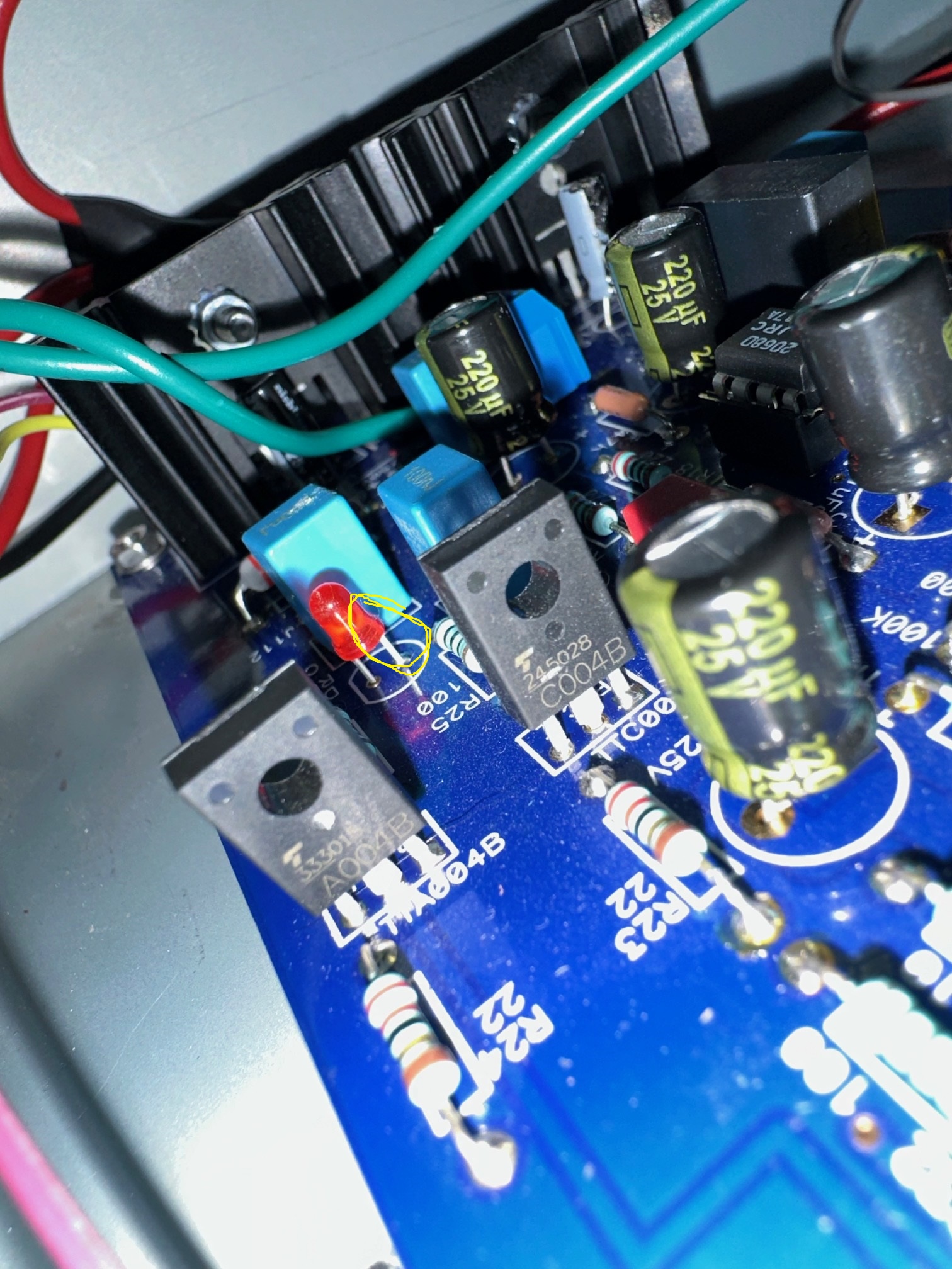

Looking closely at one of your pictures, it looks like you have installed D-1 wrong.
Might be bad resolution/blurry pic., but looks like the "flat spot" on the LED on the wrong side??
That is...... if the flat spot marking is indeed in the yellow circle. Please check and tell.
I'm pretty sure I got those right. They do light.
Reactions: Boydk and 6L6

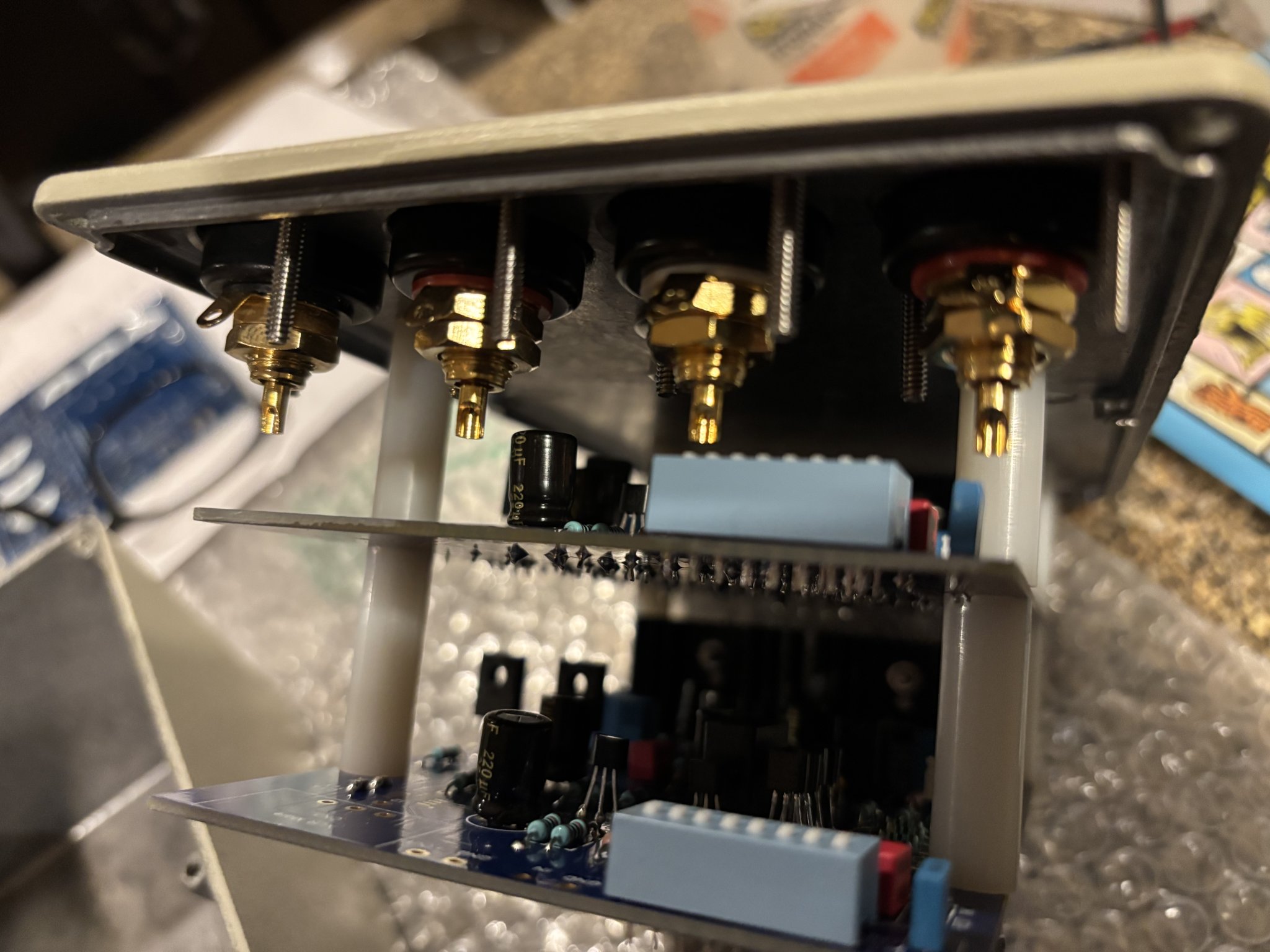

I've made a lot of improvement but it's still not great. I found that when I switched the D3 LED on the left board I shorted it out and the LED blew. I fixed that and It god rid of the loud screeching. I then stripped a good RCA cable and used the shielded wire to rewire the In and output connections as suggested by grataku. Still it sounded real bad. Could barely hear any music for the buzzing. I unscrewed the boards from the case. The screws were going through the case and the buzzing stopped. I can actually listen to music and sounds ok but not great. Still a bad hum at higher levels.
I'll try some more things tomorrow. Thanks for all the help.
@maxellfullmon
you mentioned undoing the screws holding the boards and I noticed that you had scraped the paint off the chassis under these screws as if to make good electrical contact...
these boards are not designed to be grounded through their mounting screws. This shouldn't matter but you may have inadvertently grounded R4 or R5 via these fastenings.
Just sayin'

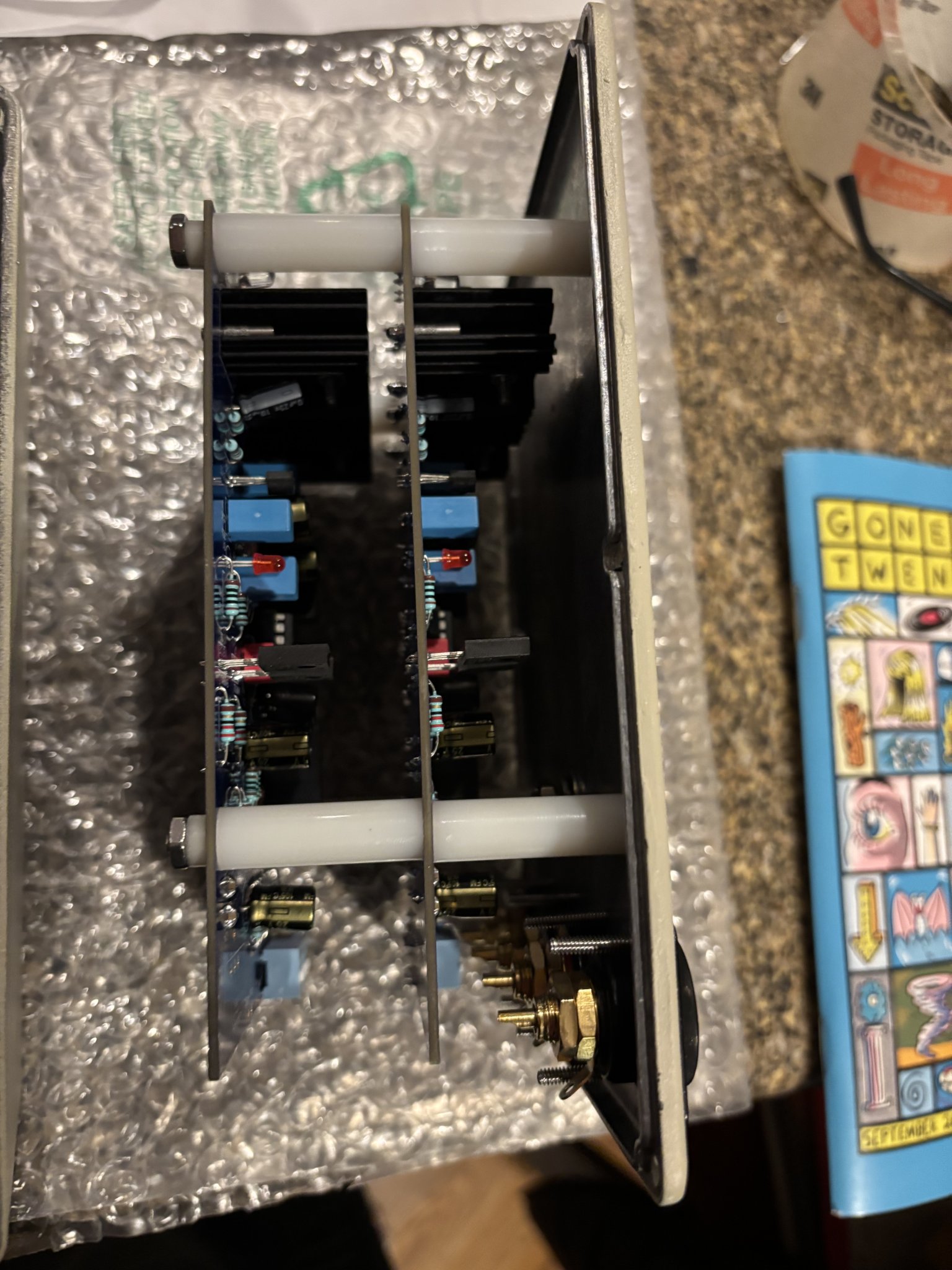

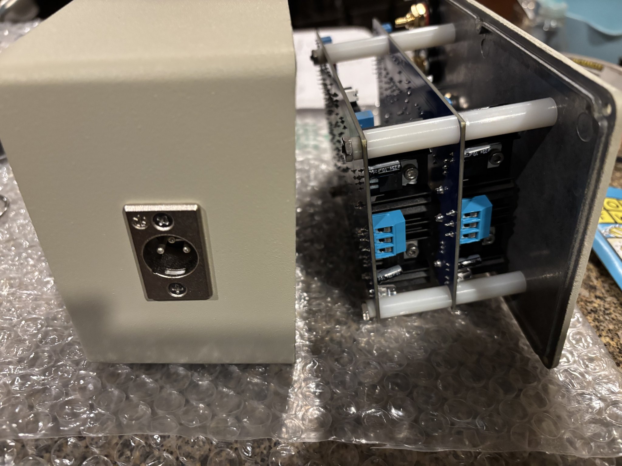

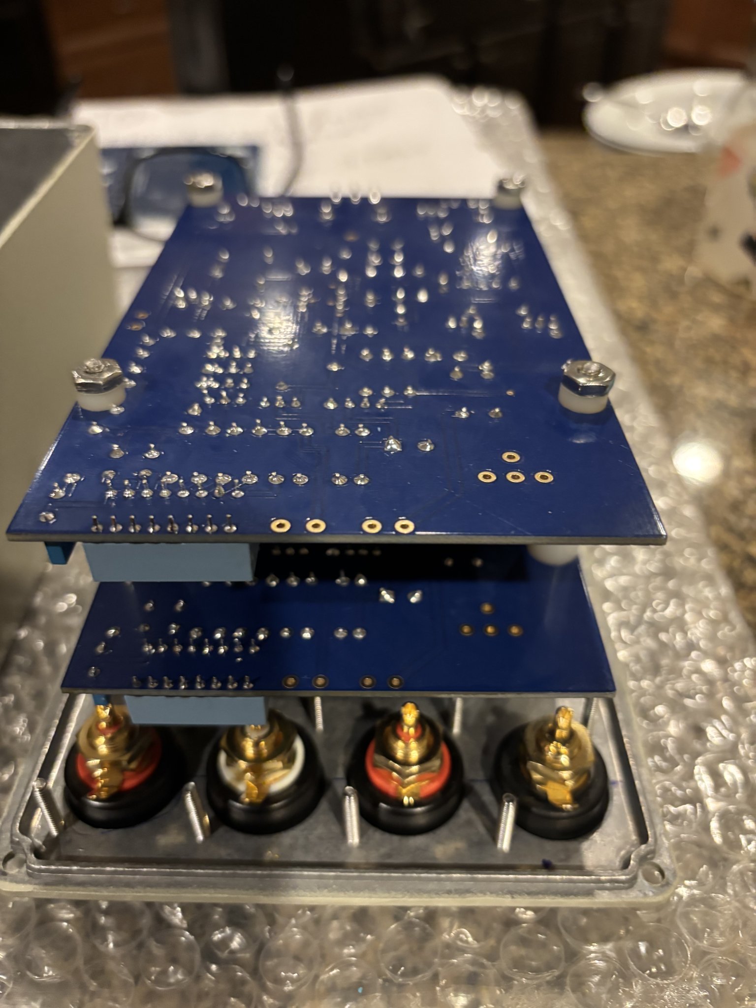

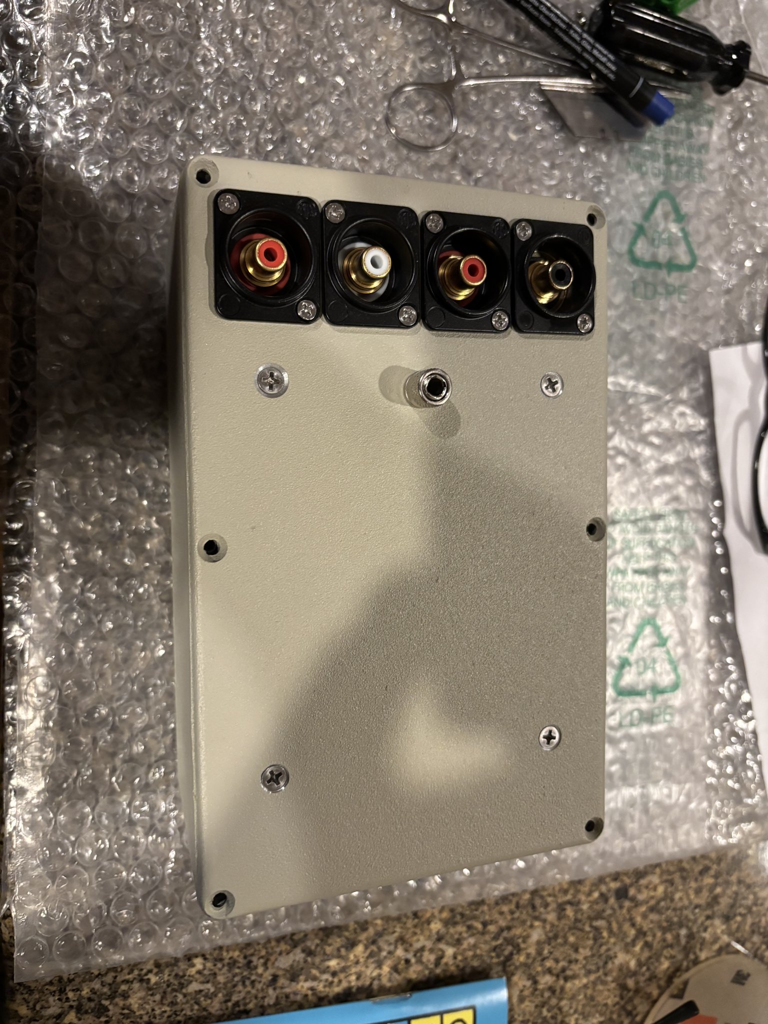

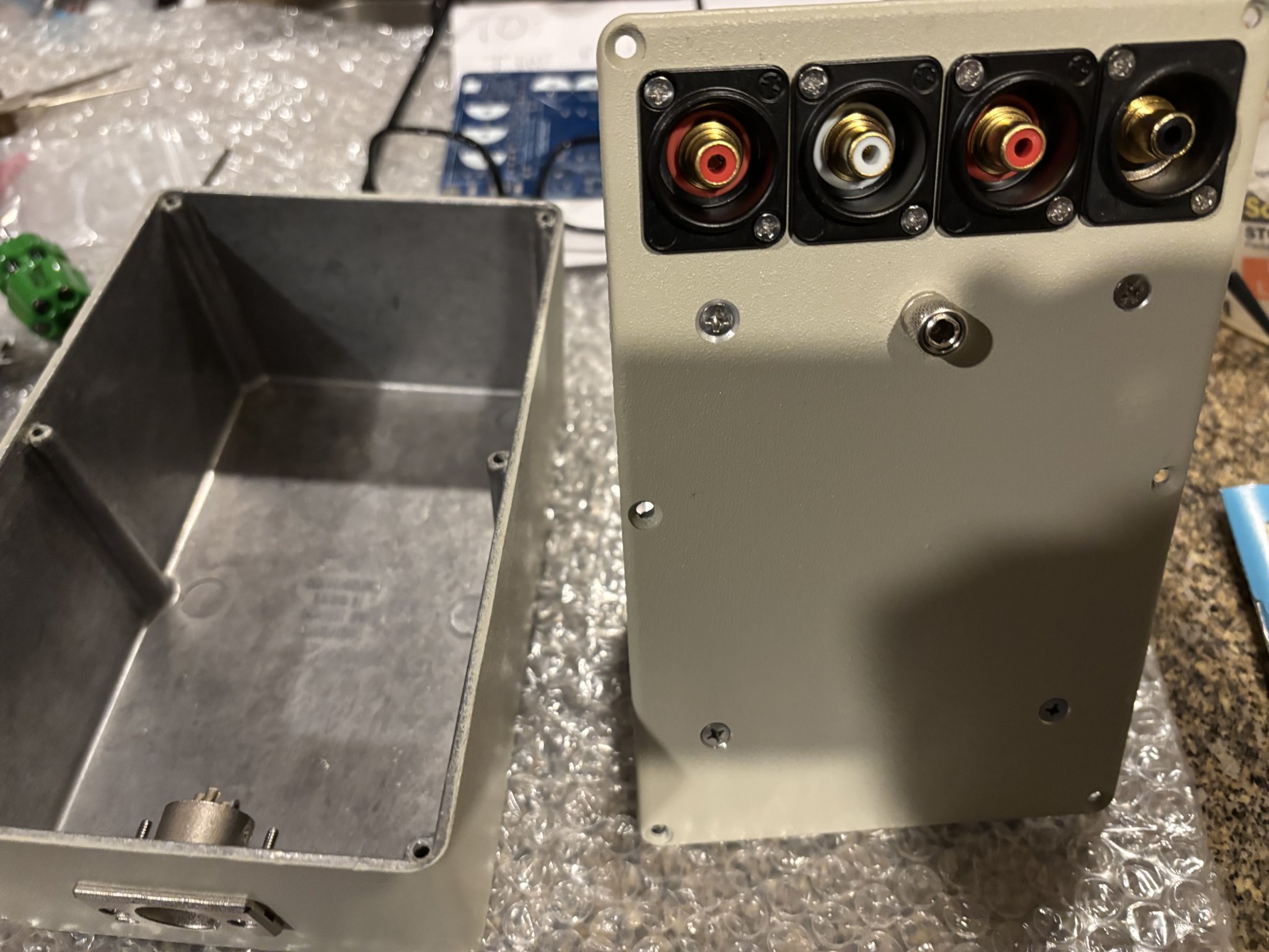

Part 2 mechanical done. I m satisfied with the results. I ordered shorter screws for all the neutrik plugs.
Tomorrow: wiring.
Picking up on mhenschel point: l had to add nylon washers to isolate the board from the 4 nuts. Below the parallel fets, two source resistors come close to the mounting hole.
Hopefully this board actually works without issues! That would be nice!
If they do light up, you did them right 👍
These boards are not designed to be grounded through their mounting screws. This shouldn't matter but you may have inadvertently grounded R4 or R5 via these fastenings.
Just sayin'
Yes..... that´s another possible error. If standoff´s or screw-heads are too wide, it´s possible to to make some unwanted connections.
Solution: Put plastic washers between pcb and standoff´s and betweeen pcb and screws.
Seems grounding can be different from build to build. My builds have ground terminal isolated from chassis. 10ohm from eaxh
ground point on the pcb to the ground terminal and 10ohm from ground terminal to chassis.

I am only using the neutrik rca because I am out of reg rcas. Way too many holes to drill with these! Not interested in having bal output and no need for the extra gain either. Bal only makes sense to me if you have a full balanced amplification chain and native balanced riaa. Sonically, I see no advantages. IMHO all the extra feedback loops in the drv135 are only going to make the thing sound more 'op ampy'.

Pearl3 episode 3: wired, tested and playing.
R27 were replaced with 500 and 620 ohm from 220ohms, to get 4.8 and 4.7mA. Q: what is causing this huge change in the bias current between boards?

Yeah, I was in a hurry to play it and I forgot to take pics. It's not a 'hot swap' situation TBS, but I am able to pull the lid off with the racked boards. I maybe able to swap opamps without further disassembly but obviously not the caps. I use masking tape to hold the screws in place and stack the spacers/boards back in place. The in/out is 22 or 24 ga solid silver coated Cu with teflon. Same stuff as Red Boy on hifihaven uses for his SUT boxes. For power 18 ga stranded silver/Cu teflon wire. I have 6-7in of it from the neutrik to the individual boards so boards can be moved independently.
I couldn't measure the power draw but the tta/ttc get warm to the touch. My Hypnotize RIAA PS settles down quite a bit. I need the proper PS!
