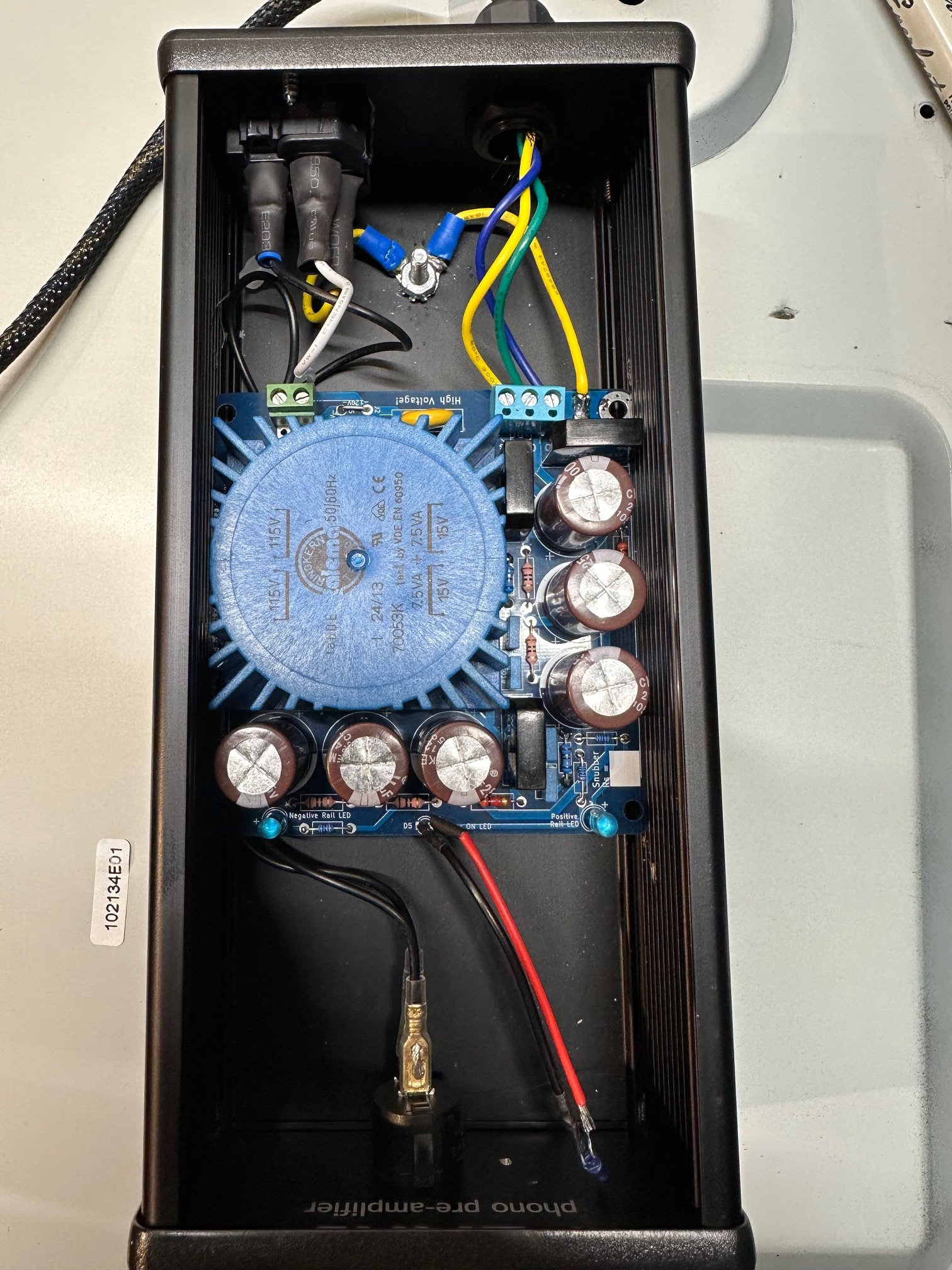

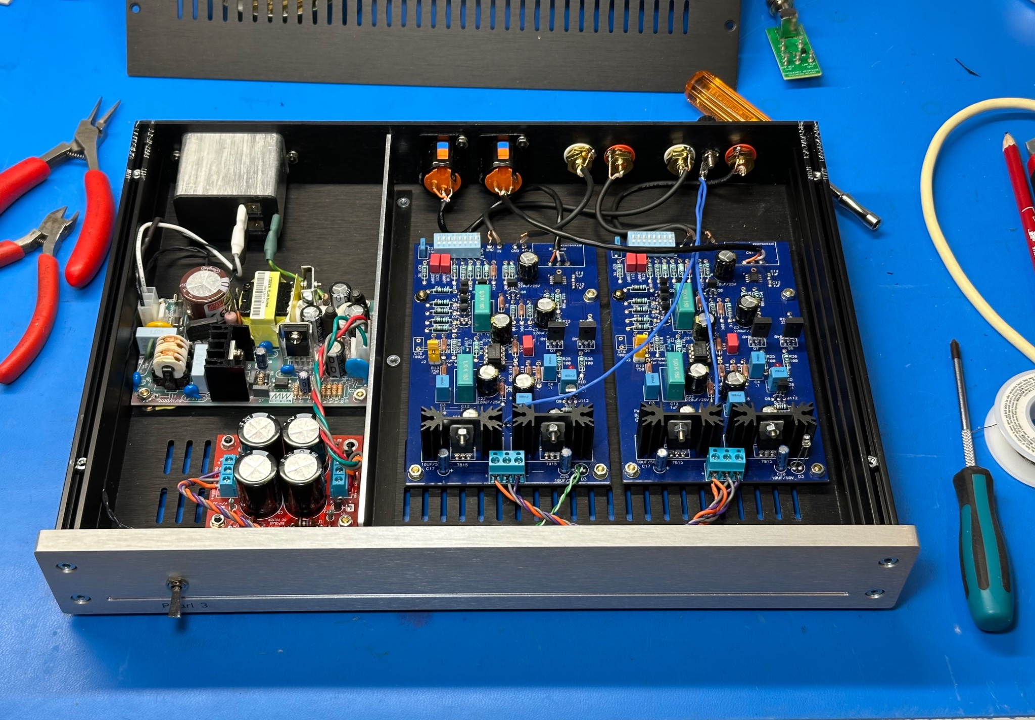

The PS looks different. SMPS? Can you describe what was used here?
Regular chassis from Gianluca?

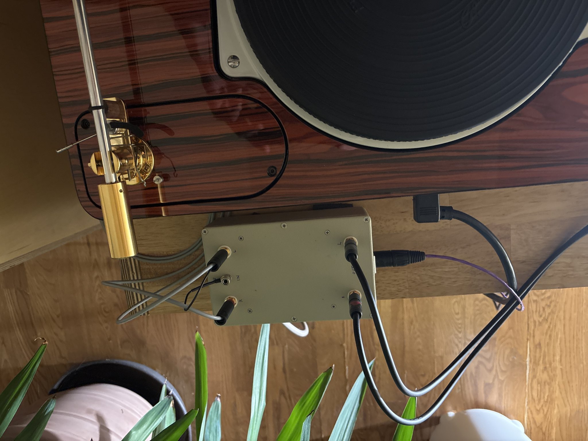

Ready to roll.. A two piece. Note I put those thumbscrews so I can move the cover easily for op am rolling. I wonder how the single power supply will fare vs the dual jobbie. The dual jobbie is bigger, has more parts and it sounds spectacular.

See, the screenplate is fixed by some kind of rivet. Readymade enclosure from Gianluca??
If so......... link ??
Hey look… a Pearl 3!!
Wow! It is a single chassis Pearl 3. On the left there is an AC mains power inlet module with RFI/EMI filter, a single SMPS board carrying the MeanWell logo, and a small red PCB with several large electrolytic capacitors. On the right there are two standard Pearl 3 PCBs with voltage regulator ICs mounted on vertical heatsinks, just as Wayne designed.
So it appears to be moving coil phonostage whose AC mains power supply in inside the same chassis! Not only that, the power supply is switch mode! That is a very aggressive design and an outstanding achievement. Eureka! Congratulations!
note to readers: most SMPS boards have a single unipolar output: +19V or else -19V but not both. It appears @6L6 has discovered a MeanWell SMPS with bipolar outputs. And it must be an amazingly quiet SMPS, for him to use with a very sensitive (super high gain) moving coil phonostage.

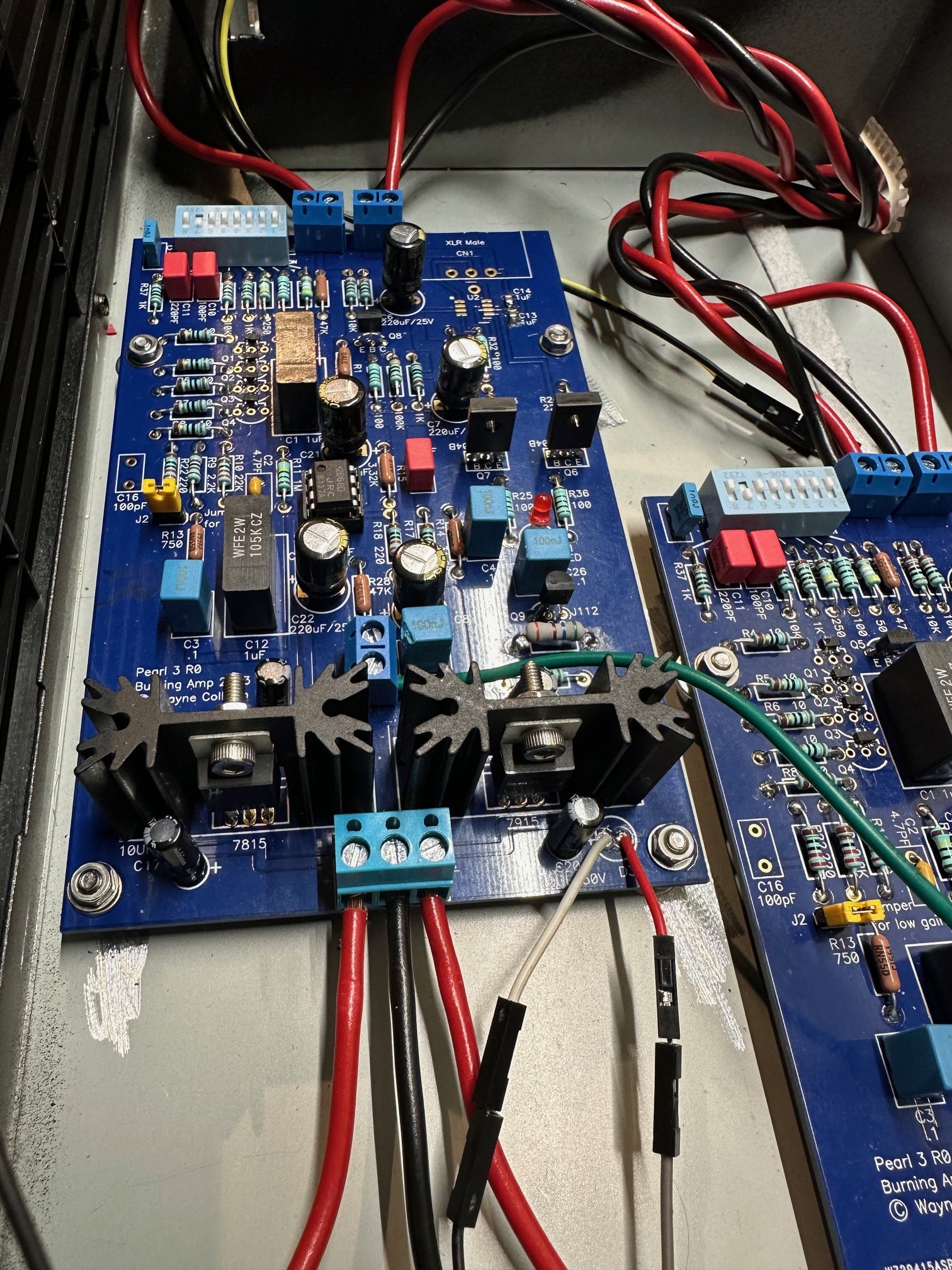

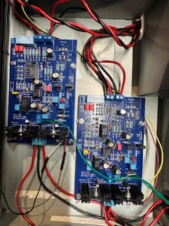

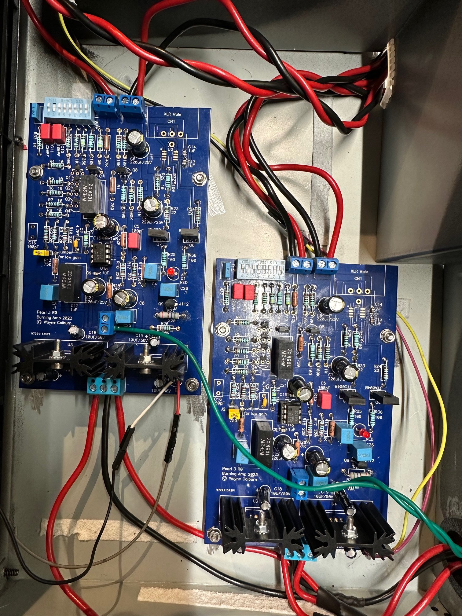

Guys, I could use some help. I have tried to work this out myself but don't know where else to look. I first fired up my P3 last week and it played but didn't sound good. It had a lot of distortion at med to high levels. I tried all dip switch settings and it didn't help. I checked the voltage of R27 and was getting 2.08 and 2.17V with a 220R. From what I calculated that's almost 10mA. I had a cheap box of resisters that I use for arduino projects. I changed out R27 with a 680R and when I fired it up I was getting like 1.3V across R27 and just a high pitch screeching sound. Also my LEDs on D3 would not come on. I checked the box of resisters and found they were 1/4W. I went today to a local electronics supply and got some good quality 1/2W resistors. I put some 560Rs in R27 and I'm getting the same thing. 1.4V on Right and 1.3V on left and the same screeching sound. I'm getting 22V from the power supply to the boards. Thinking I blew something? BTW I'm using a M2 Blue cartridge.
Thanks if anyone can come up with some suggestions of where to look next.
Can you post some images that are full-size? These are tiny.
1/4W resistors are fine.
If the LED isn't on something is likely installed backwards.
Don't worry, we'll help you get this figured out. 🙂
I did have LEDs at first before I replaced the resistor at R27 and I had music, just sounded bad.

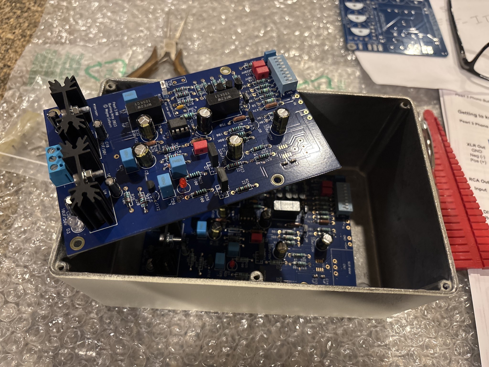

l completed the boards. They will go into this 1.5 height hammond box boards will be under mounted with nylon standoffs on the lid with in/ out rcas and gnd lug. There will be a neutrik for the ps umbilical.
I did the same for the hypnotize ad797 riaa (see photo) and that worked out well. I don’t have room for a big riaa box behind the TT and l m happy with the noise insulation provided by the hanmond box.
I only wish the boards would accommodate the good sounding Russian 1uF toilet paper in oil caps. 😉
I might play with the and lower the gain some. The hypnotize riaa gives 62db (measured) gain, even with my 0.25mv mc pickup is plenty gain for me.

Hello maxellfullmon,
what I can see on your pics - the parts seem to be oriented correctly.
What I can't see: the two TOSHIBA TTA004B and TTC004B are not mistakenly in the wrong spot? But this is impossible - then your outputstage wouldn't bias up.
The red LED is also correctly oriented - has to be or it wouldn't light up
Your bias is on the lowish side with R27 = 560 Ohm. You measure 1.3 and 1.4 V over R27, so you have 0,0023 A (2,3mA) and 0,0025 A
(2,5mA) as bias. I would change R27 to a value around 330 Ohm or 390 Ohm.
You can measure your voltages after the regulators. If you go in with around 22 V DC - this is no problem for the regulators.
Correct regulators on positive and negative side? - Should be - or it wouldn't work.
Most important for me: check soldering of JFets (Q1-Q4) - all legs in good contact?
Only some thoughts and assumptions.
Cheers
Dirk
