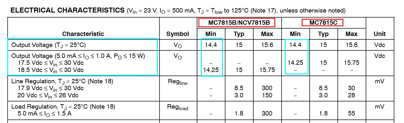

I received a batch of 7815 that only gives out 14,6 volt
Depending on which manufacturer of 7815's you bought from, and depending on the suffix (7815B , 7815C , etc) ... the datasheet guaranteed output voltage may not be precisely 15.0000 volts. Here's the output voltage guarantees printed on the 7815B datasheet from OnSemiconductor. Lucky for you, Wayne Colburn was extremely familiar with these datasheets when he designed the Pearl 3 circuitry. Wayne isn't surprised that some of your 7815's put out 14.4 volts ... he expected that.

Thanks Mark... and yes... I´m familiar with the spec´s.Depending on which manufacturer of 7815's you bought from, and depending on the suffix (7815B , 7815C , etc) ... the datasheet guaranteed output voltage may not be precisely 15.0000 volts. Here's the output voltage guarantees printed on the 7815B datasheet from OnSemiconductor. Lucky for you, Wayne Colburn was extremely familiar with these datasheets when he designed the Pearl 3 circuitry. Wayne isn't surprised that some of your 7815's put out 14.4 volts ... he expected that.
_
It was more to point out, that even with regulators giving +14.6 and -15.0 volt, the Pearl-3 works flawlessly 😉

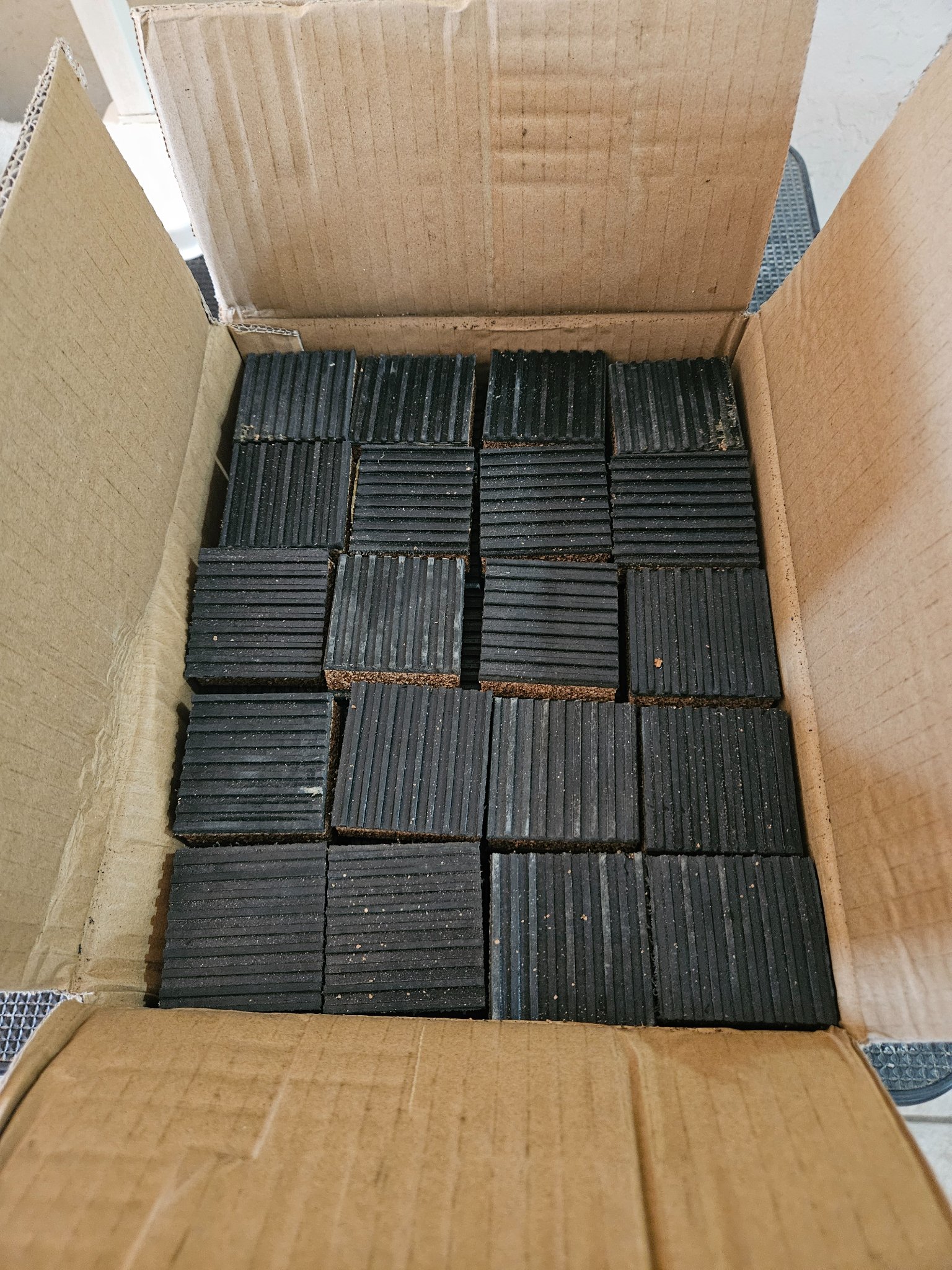

@bentconvert : On your advice ordered a lifetime supply of acoustic insulators from Supply House at their most reasonable price of $28 for 100. JPeg below shows how they come. Will be using these for three turntables, larger speakers, studio monitors, and on and on. Thanks again for your recco and knowledge. They are, btw, very slightly different from the ones on Amazon -- the rubber pads are just a bit less thick and the finishing a bit more casual. But for isolation purpose they look fine.
The rubber and cork isolation pads shown likely are very solid and unyielding under the weight of most turntables. They are designed to isolate heavy vibrating equipment like a 300 pound power transformer.
Think of the isolation pad or foot as a spring, to be effective it needs to squish or yield a bit under the weight of the plinth base and turntable.

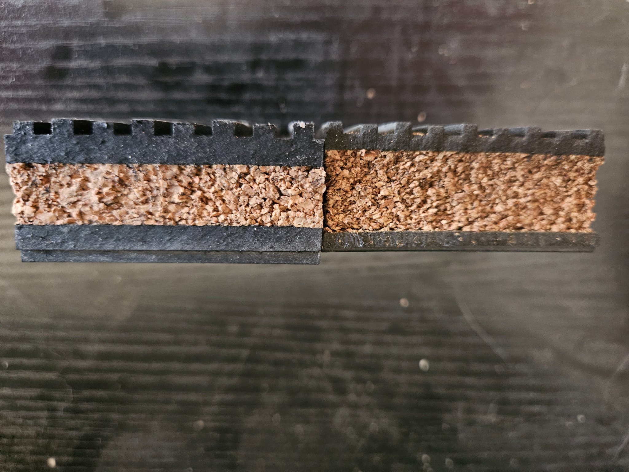

Yes, I had this same thought.Think of the isolation pad or foot as a spring, to be effective it needs to squish or yield a bit under the weight of the plinth base and turntable.
SO...
It's fairly easy to replace the Amazon ones with the Supply House ones and see the effect upon the problem: the VPI/Hana ML match that produces a very slight hum.
The good news is that both isolators remove this hum. To get the best result I tested with the very quietist vinyl I have ever heard (by a bunch) -- the new German pressing of Ronstadt's first 4 recordings for Asylum. This was offered as a Record Sale Day this year. Curiously, it has not been the hit I was expecting. Has sold well but is still available at the original RSD price ($100). It is so quiet that you keep thinking you are listening to a CD.
Attached is a photo showing the two isolators. More rubber and less cork in the Amazon one. For heavier speakers I am going to use the Supply House version. You can press on the cork and feel it compress in both. Some new speakers that will arrive next May are 250 lbs each -- this will be ideal for the Supply House isolators.
My conclusion is that both have value for audio purpose.
And, btw, the VPI TT is one heavy beast -- close to 80 lbs.
Another thing to try is to cut the isolation pads into smaller pieces. It is a pounds per square inch thing.

The VPI issue is discussed throughout the web and BoydK was kind enough to send me several references. All TTs deal with the motor/platter connection and potential noise resulting from those two interacting. VPI takes the approach with the Prime of separating the two. Some cartridges (not all) read the motor vibration as a soft hum that appears once the needle is dropped on the record.
In order to remove this hum, it is necessary to isolate the motor from the platter. The best way is to put the motor on one support and the platter on a different one.
A close second is simply to isolate the energy of the motor and, additionally, isolate the platter/TT.
The Supply House isolators do this splendidly, with no physical alterations, and at the attractive price of $2.24.
