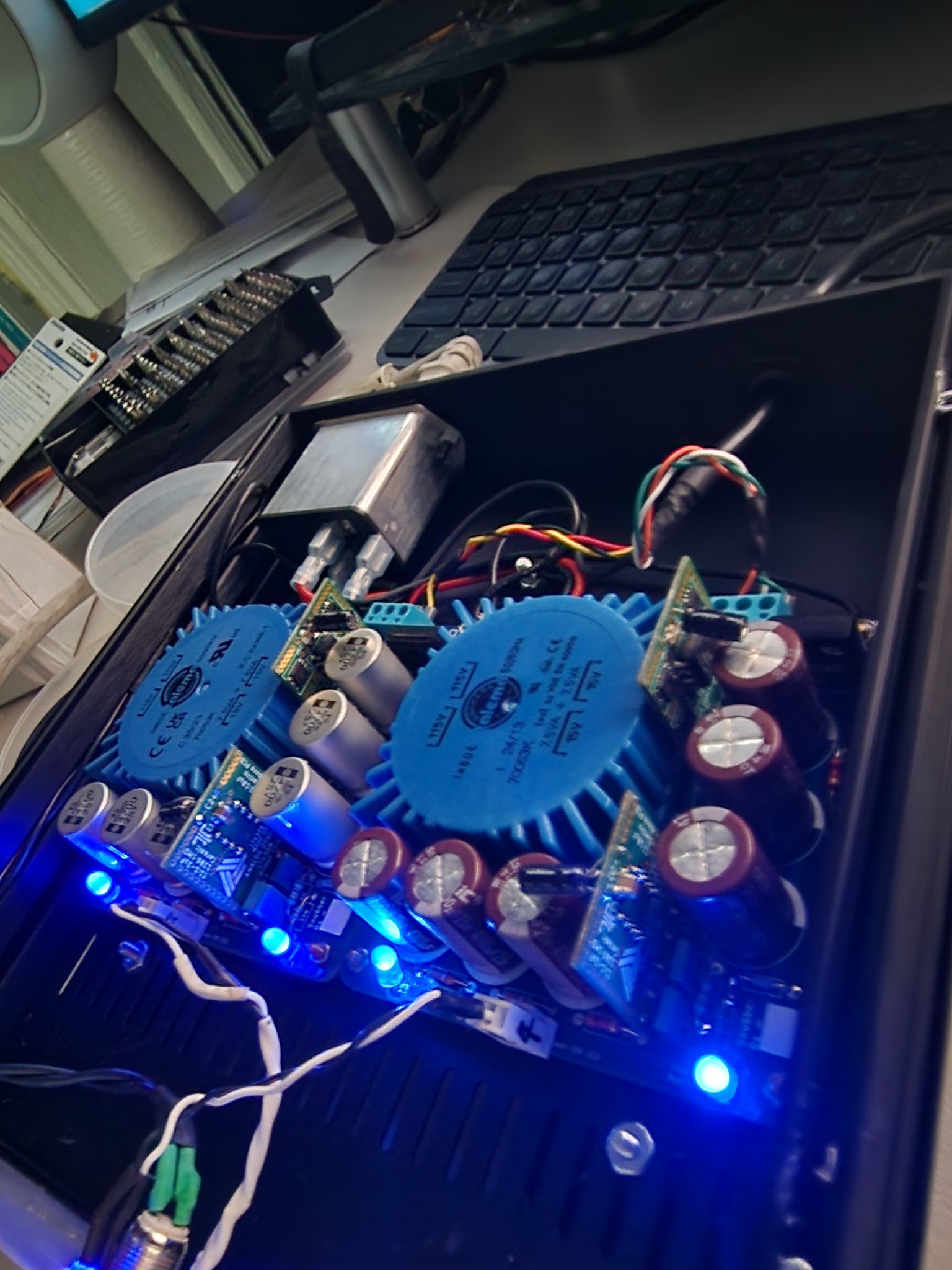

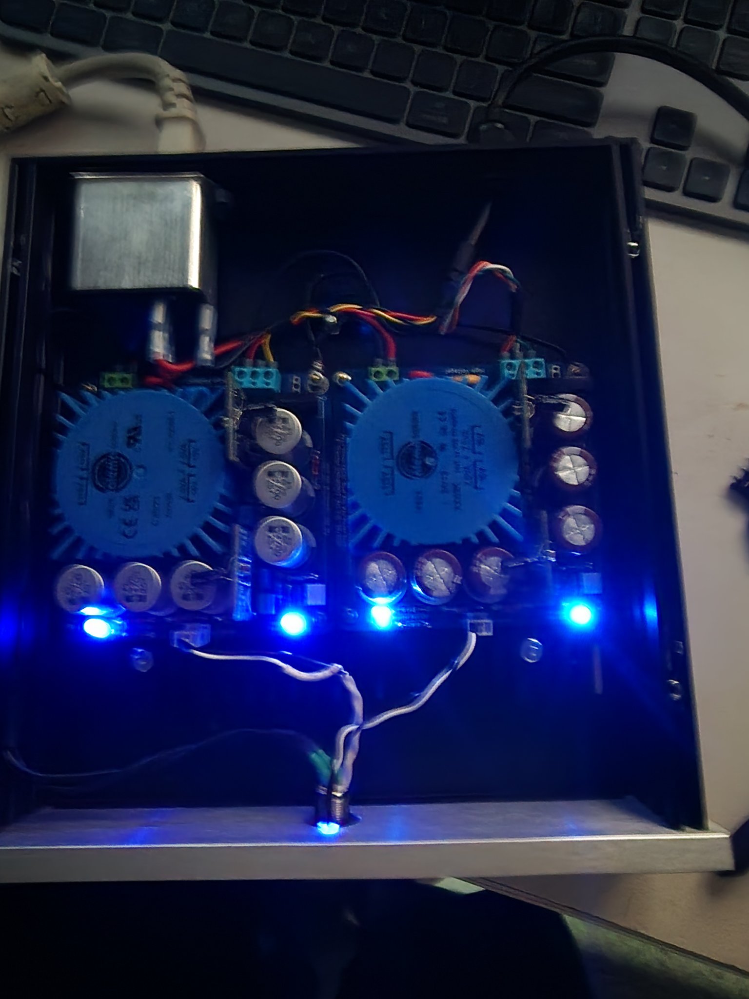

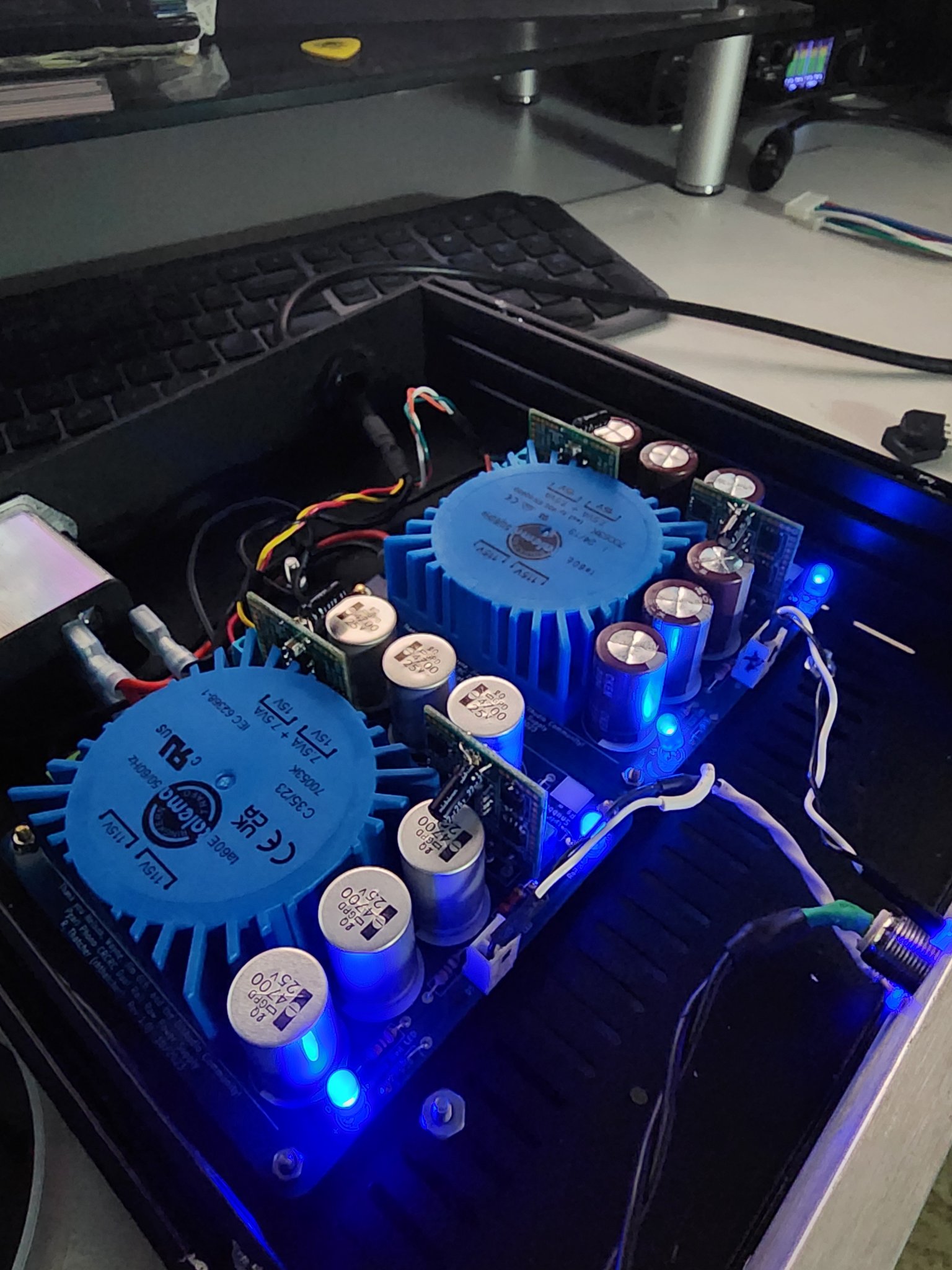

Continuing the build.
I decided to implement the active rectification modules to see if there was any difference. I replaced the KBL diode bridges with the modules. It was a tight fit, but it was okay in the end.
Measurements showed a voltage increase of about 2v, which I hope is ok for the rectifiers. I also wonder if the snubbers are now redundant per the other thread.
Sonically, I have not had time for a serious listen with my full rig, but I did have a session with the Whammy through my preamp, and after about 20 minutes, everything sounded natural and relaxed. The detail was very present due to the Burson opamps, and I was more aware of surface noise with older albums, but I will have a better sense of whether the active rectification makes a difference when I use my speakers.
