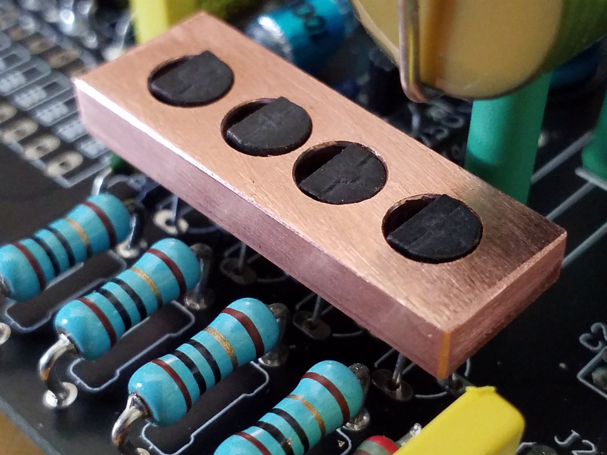

A little progress.. since I spend serious cash on genuine and lab matched 2sk170, I figured it would be better to couple them thermally together, photo is just for show, I will glue them in with thermo glue.

Hello,
As you say "just for show". Okay just for fun.
What do you expect to gain? How will you document it?
Heat moves very slowly. Voltage and current changes due to signal modulation are very low. There is very little, as in tiny, temperature change due to signal modulation.
Try using 0.1% resistors. A little over $1.00 each. The heat they make will not make any difference either.

Well I'm not a scientist, so I will not have to prove anything.
I still believe that coupling those fets together will make their drift more aligned.

Short of some serious cooling, I don't think this is going to be particularly significant. Likewise, the increase in wattage of the resistor, and lower running temperature is going to have a smaller effect.
My suggestion for noise would be ground plane and a faraday cage around the sensitive parts of the circuit to reduce the effect of EMI.
E=7.43√(R⋅T⋅ΔF)
So if you can lower T, you can reduce noise. 20C is 293K; 50C is 333K and the increase in E is a factor of √(333/293) or 1.066, ie 6.6% for a 30 degree reduction in temperature.Where E is the RMS noise signal in volts, R is the resistance in ohms, T is the temperature in Kelvin and ΔF is the bandwidth in Hz

I am aware that theese "improvements" have very little effect, perhaps not even audible, but heck, this is diy , and for fun, when you mentioned faraday cage I immediately came to think of old tuners and tv, those small mu boxes were a clever idea, and the guard traces also.

An added thought: always measure / test your assumptions.
By my measurements:
Vishay low PPM TC, PTF resistors, cost many times more, they are the best measuring through hole resistors. Vishay RN mil-spec low PPM 25-50
PPM, measure almost as well. The added thermal mass of RN60 vs. RN55 improves the measurements. RN65 resistors do not fit on the PCB's. Next to carbon composition resistors Vishay foil resistors are the worst measuring resistors.
