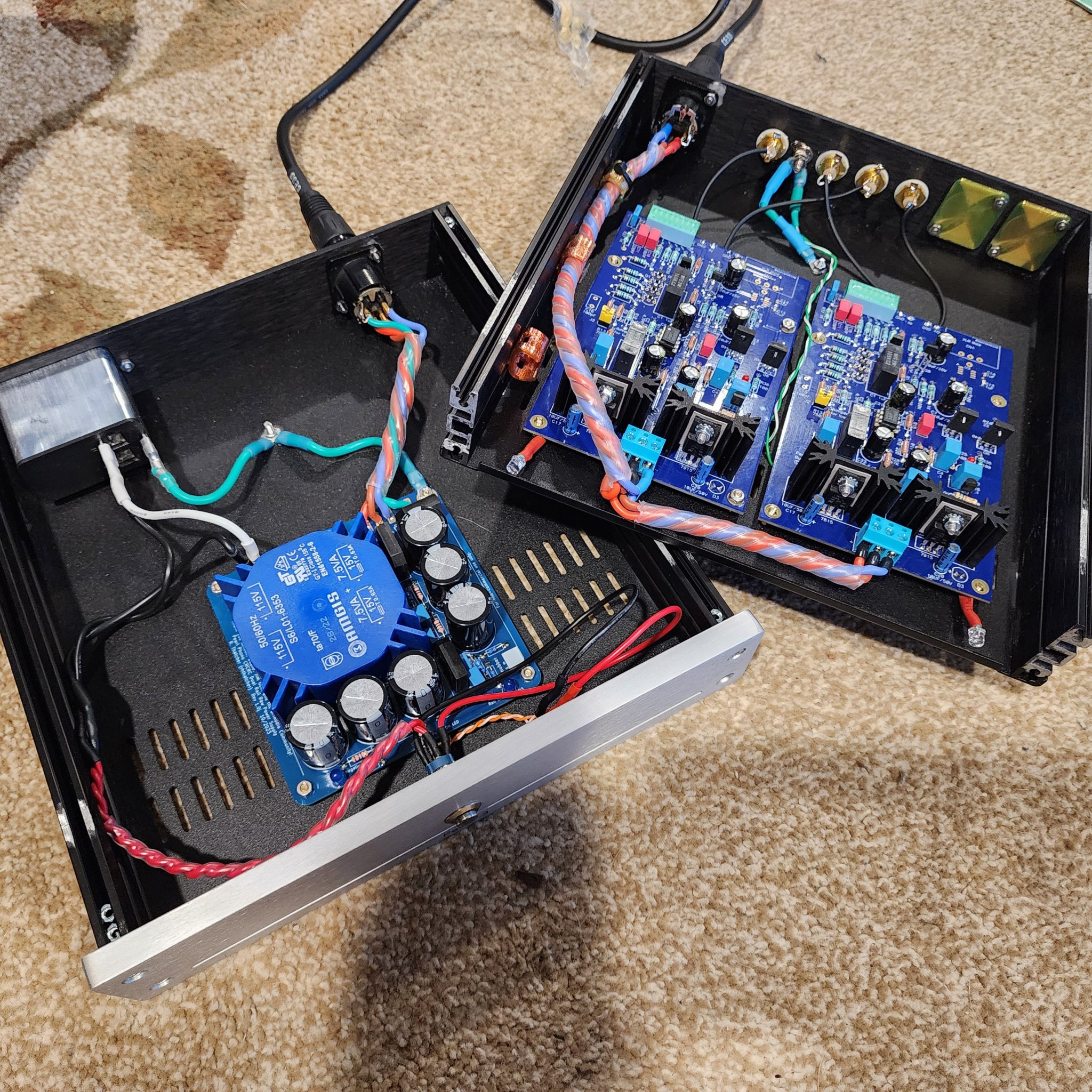

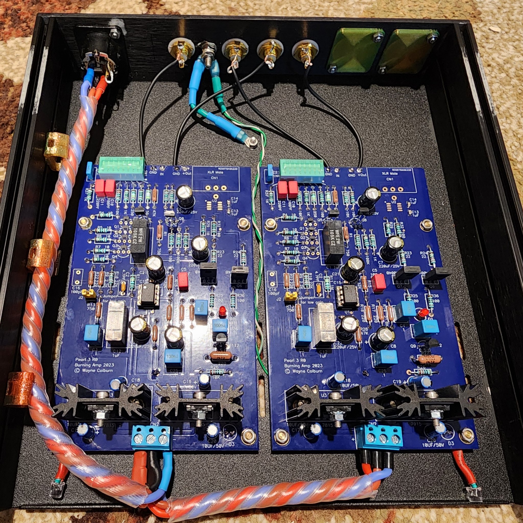

So, after building a couple ACA Mini's yesterday afternoon with my brother (wow, those things sound amazing!!), I spent today finishing the Pearl 3. I'm so close. One question....
I have been changing R27 to get under 5ma. I now have two 560 ohm resistors, but the two boards are pretty different. One board shows 4.44mA, while the other is still just out of spec at 5.11mA. I presume it's OK to have different values for R27 between the boards in order to get in spec, and perhaps have closer matching current?
Thanks in advance for any help. I'm so close! Toys4Boys and I have been neck and neck all day with our builds. It's been fun sharing our progress and lessons learned.
yes
resistor value is irrelevant per se, goal is to have prescribed current
same as you are going to shower - who cares how much left or right faucet is set, as long water temp is as you want it
  • Thank You
Reactions: 3 users
Thank you Zen Mod! I figured that was the case, but my noobness made me feel like I needed a hand on my shoulder, a confirming nod, and a great analogy :rofl:
I shall pursue matching currents and let R27 be what it may for each board.
:cheers:
[EDIT: 680 ohm on right board gives 4.3mA and a 560 ohm on left board gives me 4.4mA. I suspect that's plenty close. Thank you again ZM! Water temp is perfect for me.]

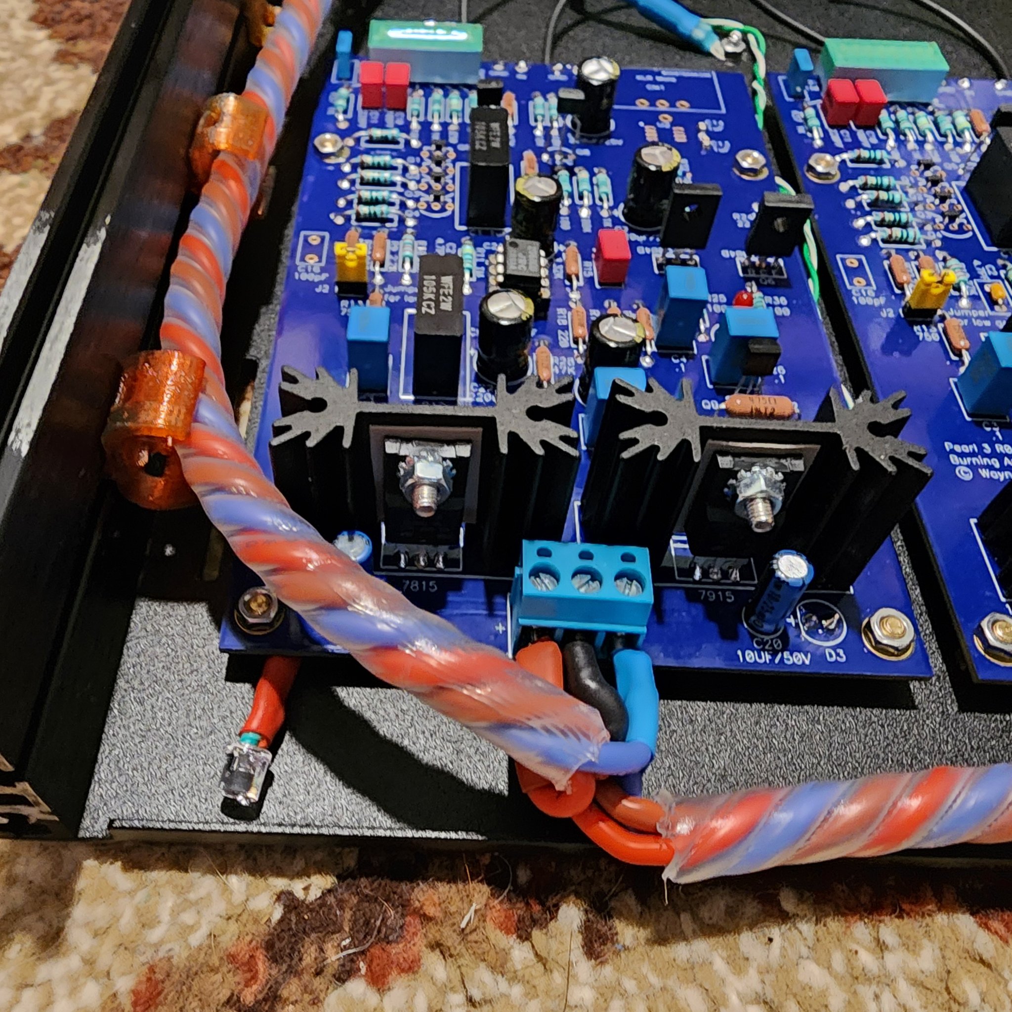

Nice build, but one question..........
Why the massive power wires inside the Pearl??
The total comsumption is approx. 100mA pr. board, so my thoughts were, that you maybe could
have done a prettier job with thinner wires ;)
Just my 5 cents.
Well, all I had on hand is 16ga, so it was a matter of availability (I am building this at my parents house, 1500 miles from my home, and neither one knows how to solder). I suspect it'll work fine though. I think it's still pretty, even with the "cankles".
