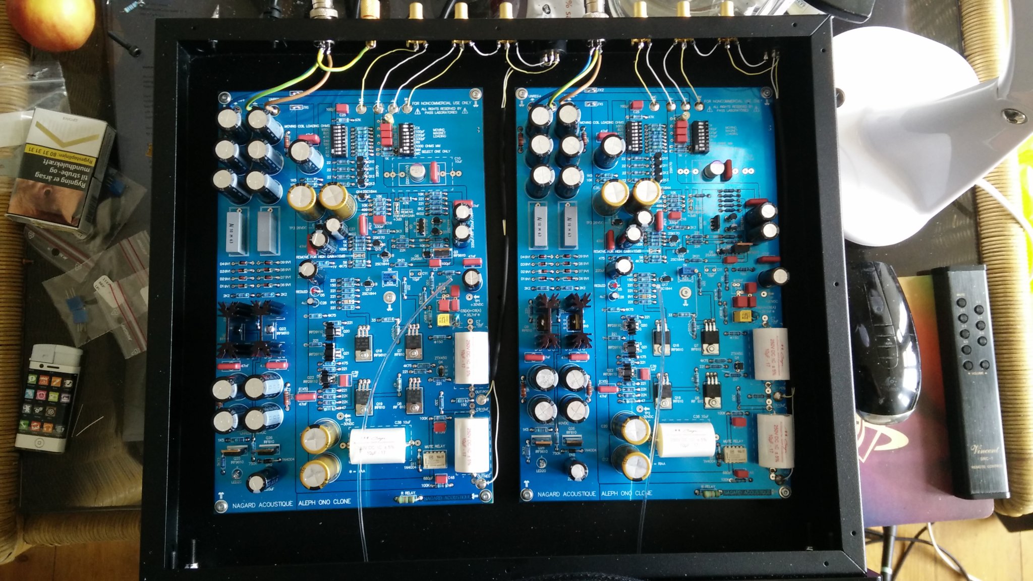

As promised.@Boydk: Let me know how the 19 vdc works in the noise arena.

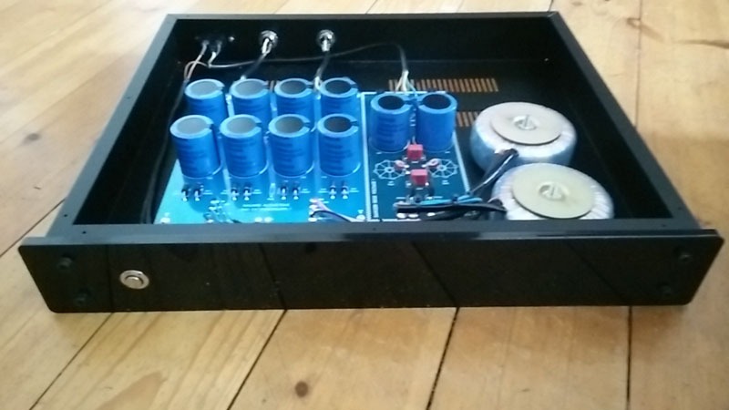

Adjusted the @sachu888 -supply to +-19.5 volt feeding the Pearl. No noise issues whatsoever 😍
It´s playing as I write this, Hans Theessink & Terry Evans "Visons". Opamp is LM-49720......... It stays !!!
Compared to my X-Ono clone it´s clearly a little more revealing in the highs. Lots of detail without being sharp.
Bottom end is impressive too. This is absolutely perfect.
Only issue left is a bit of hum (100 Hz). When connecting the ground wire from turntable it hums a bit or more
like snearing and nothing changes when touching tonearm.
Without the gound wire it´s dead silent, but a weak humming when touching the tonearm 🙁
Moving the PSU away makes no difference whatsoever.
Everything is wired according to build guide. Come to think of it..... I wired 2 extra LED´s for the front panel directly to
the power inputs before the 78/7915´s, but I have a hard time believing, that this could be the cause. Will fiddle around
with this issue tomorrow. I´m tired....... want beer and music now.

For those who might be interrested........ HUM IS GONE 😍
Had sanded all connecting sides of the enclosure before hand, so was a little worried..... obviously for no reason.
Tightened a couple of screws. rewired ONE connection from PSU to ground of the Pearl-3, and now dead silent
with arm/tt-ground connected.
This is (almost) better than good 😊😊😍👍

was this a new wire? from where to where exactly? did you try other connections?rewired ONE connection from PSU to ground of the Pearl-3
1. No... just moved one wire, Was from housing of the PSU to the housing of P-3.was this a new wire? from where to where exactly? did you try other connections?
2. No...... retired and getting lazy 🤣 .It worked, so no reason to try anything else 😊

3-wire screened cable from PSU to Pearl. Earth on inlet via bridge rectifier and 10 ohm to PSU enclosure.the wire was reconnected how?
Had forgotten to connect the screen to riaa enclosure-ground. After that....... no more humming.
