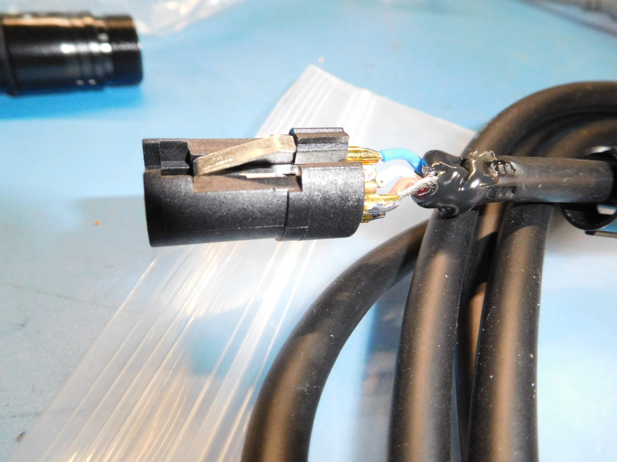

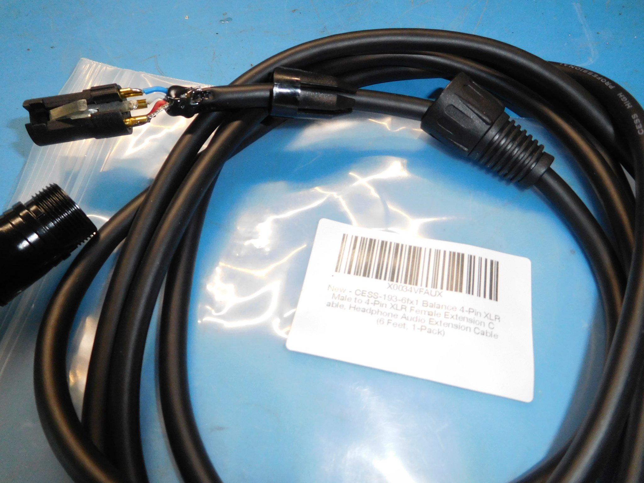

Short the input if there is no or little noise at the output, the power supply including regulators and umbilical are functioning okay.
The umbilical on my bench is just 3 insulated 6 foot long conductors. The noise floor, Volts/Rt Hz is quiet on the FFT.
You also have a good idea that the chassis shielding is also working.
Start adding other components one RCA connection at a time while watching the noise floor on the FFT. You can see the little bit of power supply noise that leaks into the RCA cable and get amplified 50dB. It is no secret. As @wayne told us a couple hundred posts ago do not use your cell phone near your Pearl 3.
In my other life I am a California Hospital Inspector. Keeping EMI and UHF radio out the medical alarm systems is a challenge.
In the RCA cord the shield is a signal caring conductor and is exposed to all the EMI on your bench.

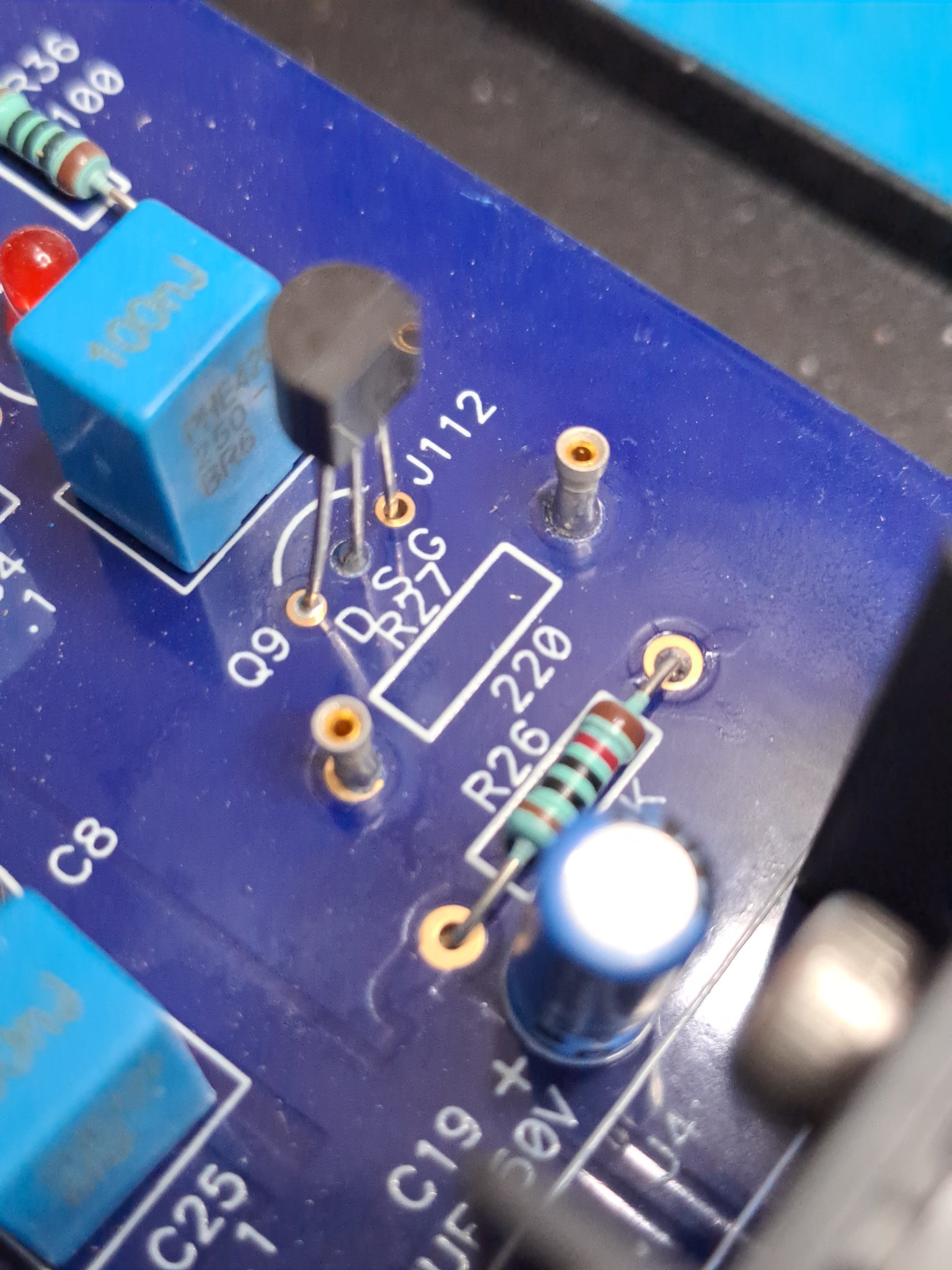

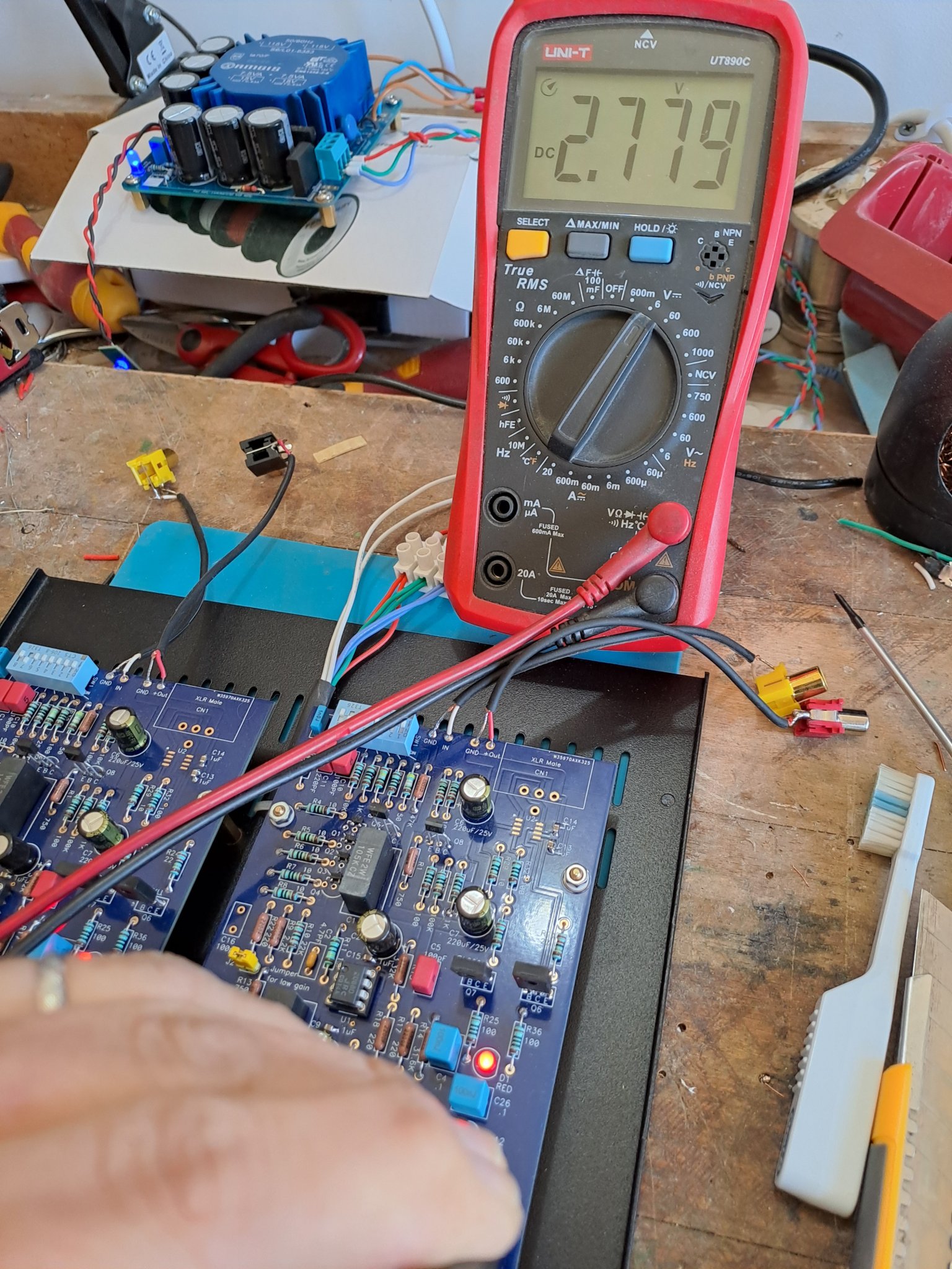

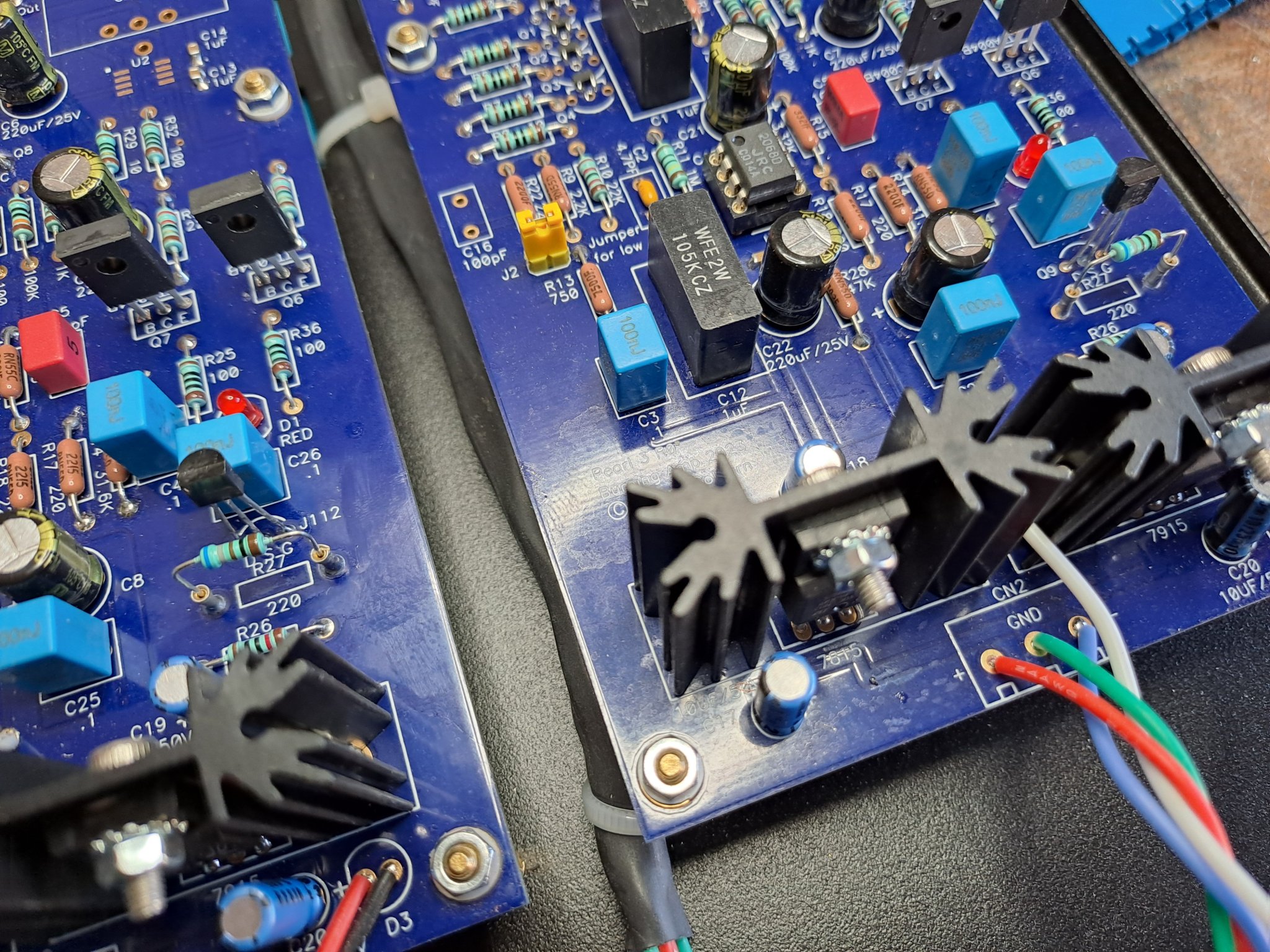

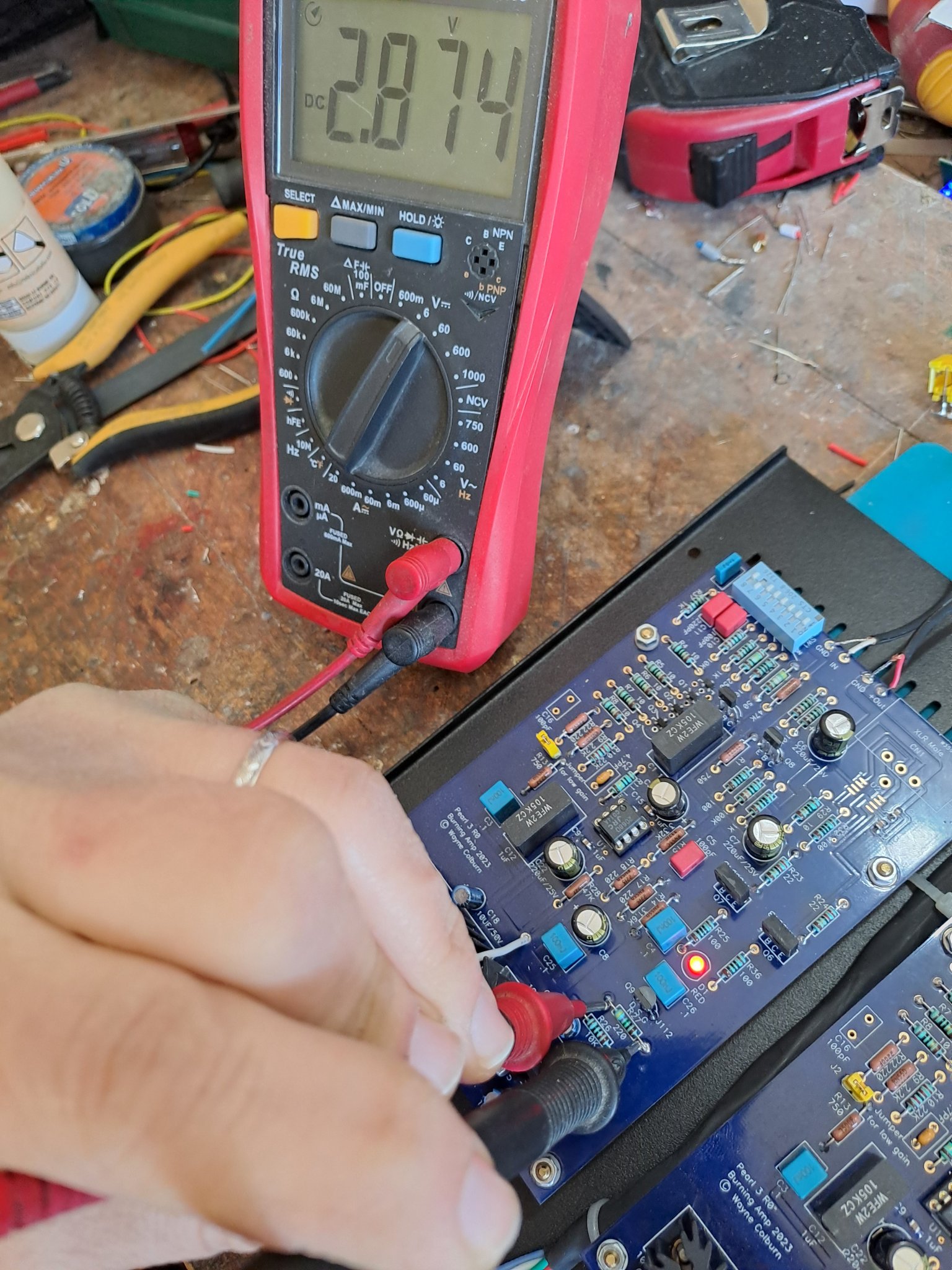

On my boards voltage across R27 is 2,3/2,4V: I have to double up the value of res. Something between 470 and 560R..

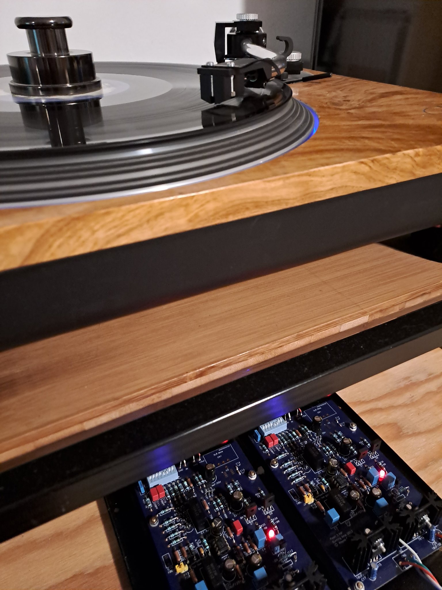

Very nice looking build!
Those sockets make it very flexible for rolling - great idea.
Now it's time to play some tunes and let everyone know what you think!
Easy for me anyway 😌. Thanks...Mouser put it in the description, but I guess it's easy to overlook.
_
Does the opamp installed influence the bias current given a certain value for R27? In that case I might have to install sockets as well. I determined a value for R27 with the NJM2068, but I only had that opamp in because it was the cheapest one I had in case I had made a mistake.In order to allow opamp rolling, I put two sockets salvaged from an IC socket on R27 position. With 681R I have 3V circa, so now it is ok for opamps supplied in the kit.

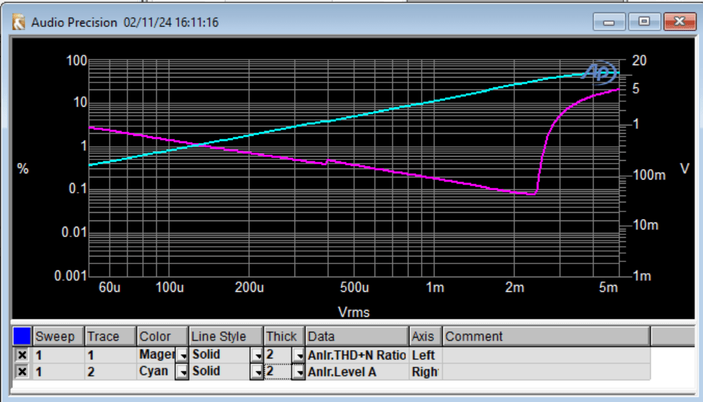

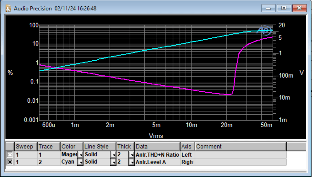

I made the MC calculation based upon 300uV spec 5cm/sec but upon further reflection, and looking at a table in Doug Self's "Small Signal" there is a preponderance of MC carts with much lower output.Someone asked about overhead margin. Here are two graphs. I calculate 18.8dB in the high-gain MC mode, and 13.9dB in the MM mode.
My Audio Technica is rated at 300uV @5cm/sec.
I define the overhead margin as that voltage which raises the pre-pre-amplifier's THD+N to 1%
