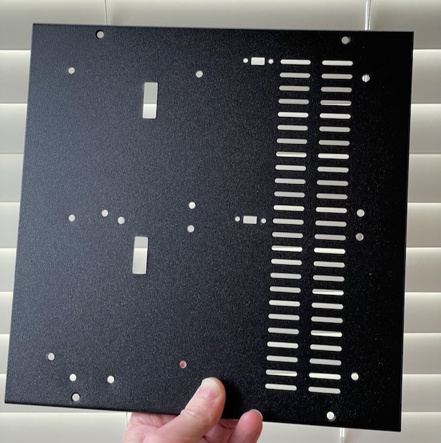

Chassis Bottom Plate Mods
Finished modifying my preamp chassis bottom plate yesterday evening...
Added access holes for DIP switches (soldered to the bottom side of the PCB, will need slightly taller standoffs), and MC/MM gain selection slide switches. Credit to @GKTAUDIO who suggested bottom side DIP access openings earlier in this thread, it's a nice idea - very convenient if you change phono carts regularly:
I'm currently thinking I'll 3D print some cover plugs lined with copper tape to provide shielding across the access openings (should connect to the exposed steel around the perimeter of the opening), since those DIP switches are connected directly to the signal from the cartridge. So, it's a pretty sensitive node.
The gain select switches are located as close as possible to the J2 location on the PCB so those wires can be kept short. Lined 'em up with the vent slots for aesthetics. I selected E-Switch EG1201 for this - it just fits the gap between the two PCBs. Mounting holes are 4-40 tapped, and I'll probably print some spacers to stand off the switches and reduce the protruding actuator length.
You may notice some extra holes lower left - those are for another custom feature I'll post about soon. 🙂
Or, you could cut holes in the bottom of the chassis and mount the DIP switches on the bottom of the PCB, like I did here.
