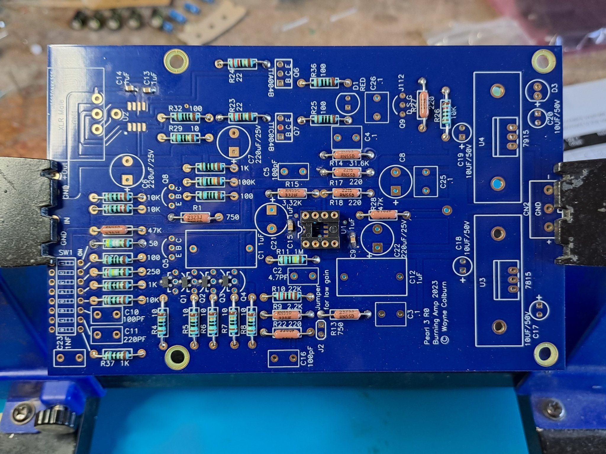

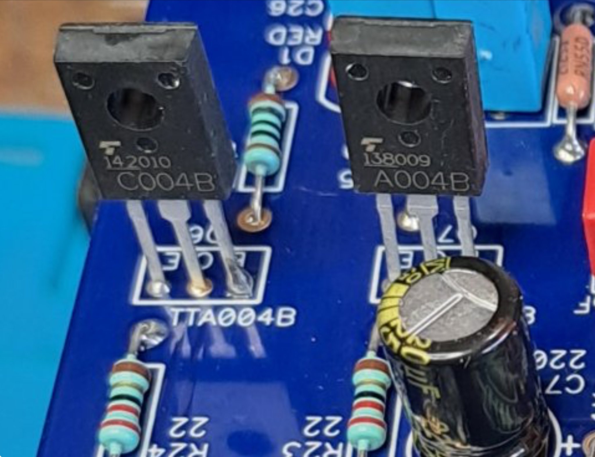

Resistors in place:
....... Assembly of Japanese Bicycle Require Great Peace of Mind .......... and having Italian ancestors
Big mistake? Not at all! That’s a small, and easy-to-do stuffing error.
Also, easy to fix!
Everything else looks quite good, thanks for posting all the photos!
Also, easy to fix!
Like "measure twice (or more), cut once"...
"Share photos first, correct mistakes and attract brilliant advice... then flip the switch" is a good modus operandi. Especially with these good folks.
