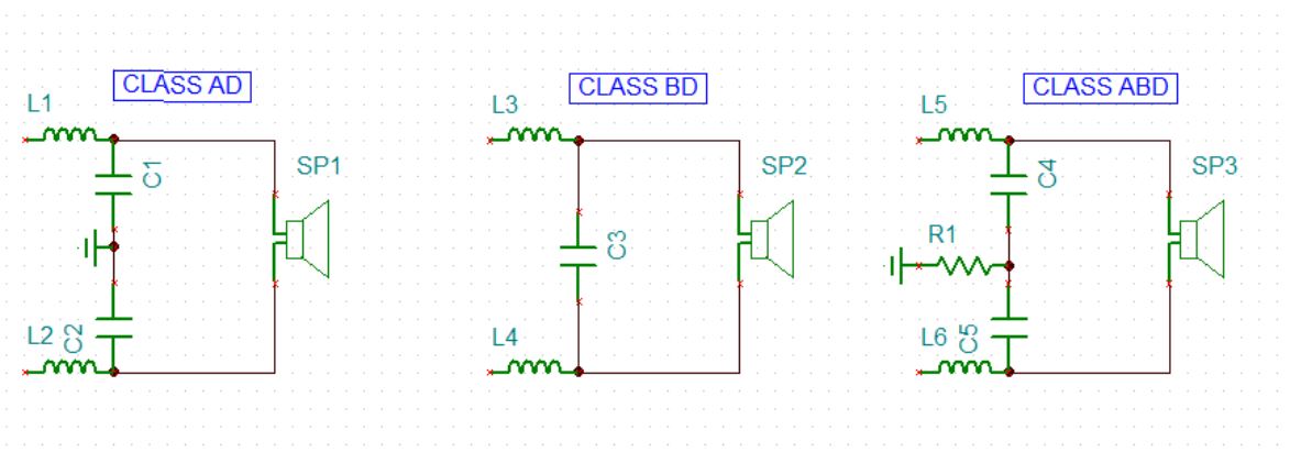

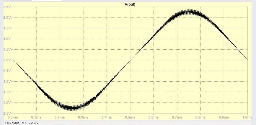

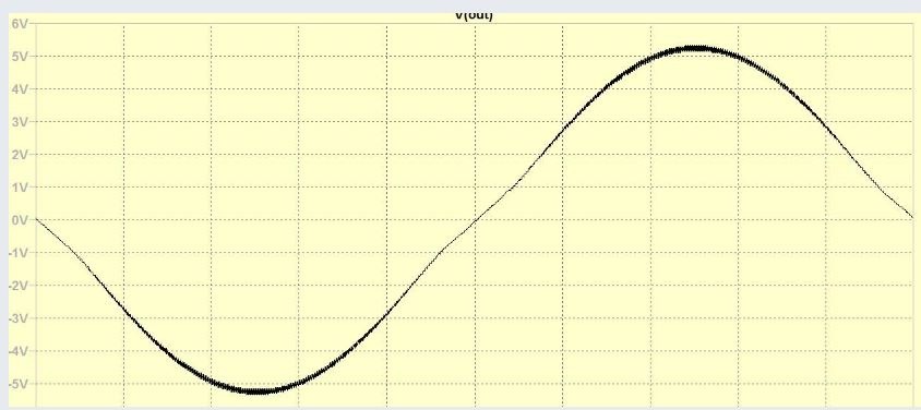

The AD mod has too much bias. The BD mod no bias. My ABD mod has just the required bias.

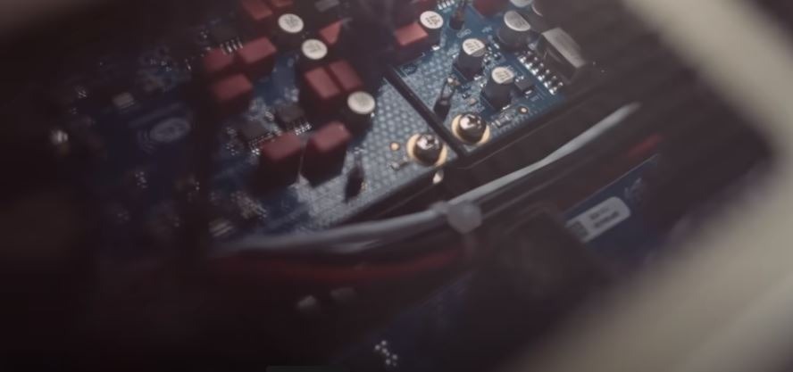

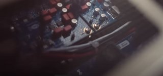

Apples v oranges. The GaN 400 has global feedback the GaN-1 and Carina-GaN have no feedback.Well the GaN400 shows significant frequency deviation dut to load, so why is this different?
And if you look at the two boards they are totalaly different to look at even though the 400 was taken through the case top vents, so that "call" just can't be made "yet".
Cheers George
NO that wasn'nt said!so removing feedback will decrease output impedance?
They (Gan-1 and Carina-GaN) are totally different boards as I've showed you to what you are trying to compare them to the older GaN400, who knows what they've done, you can't speculate and put ****on them yet, till some measured figures come out on the way they've used them.
