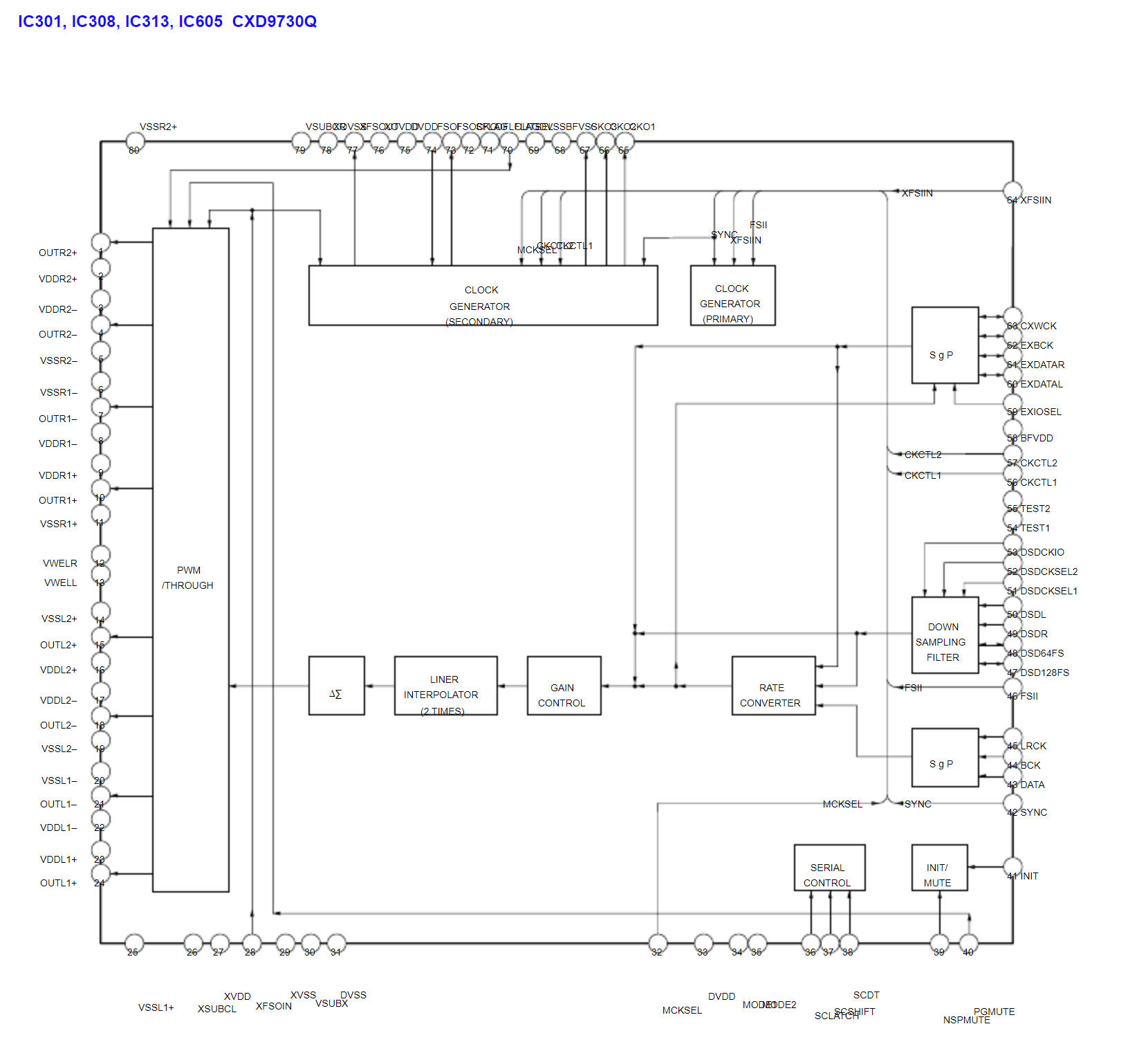

I still have the old Panasonic SA-XR55 "all digital" PWM amp using the TI chip. It still sounds darn good when fed a clean digital signal (forget about analogue inputs). I think these types of PWM amps have a great role when they are priced low and plenty available (like Panny was), so I wish TI would have continued to make such products.There's no need to try and combine the two and TI have even given up on this concept with a lot of their single chip amps. Most of them now contain a traditional DAC plus class D amplifier together in the one package.

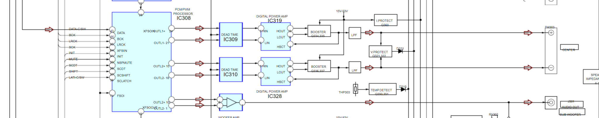

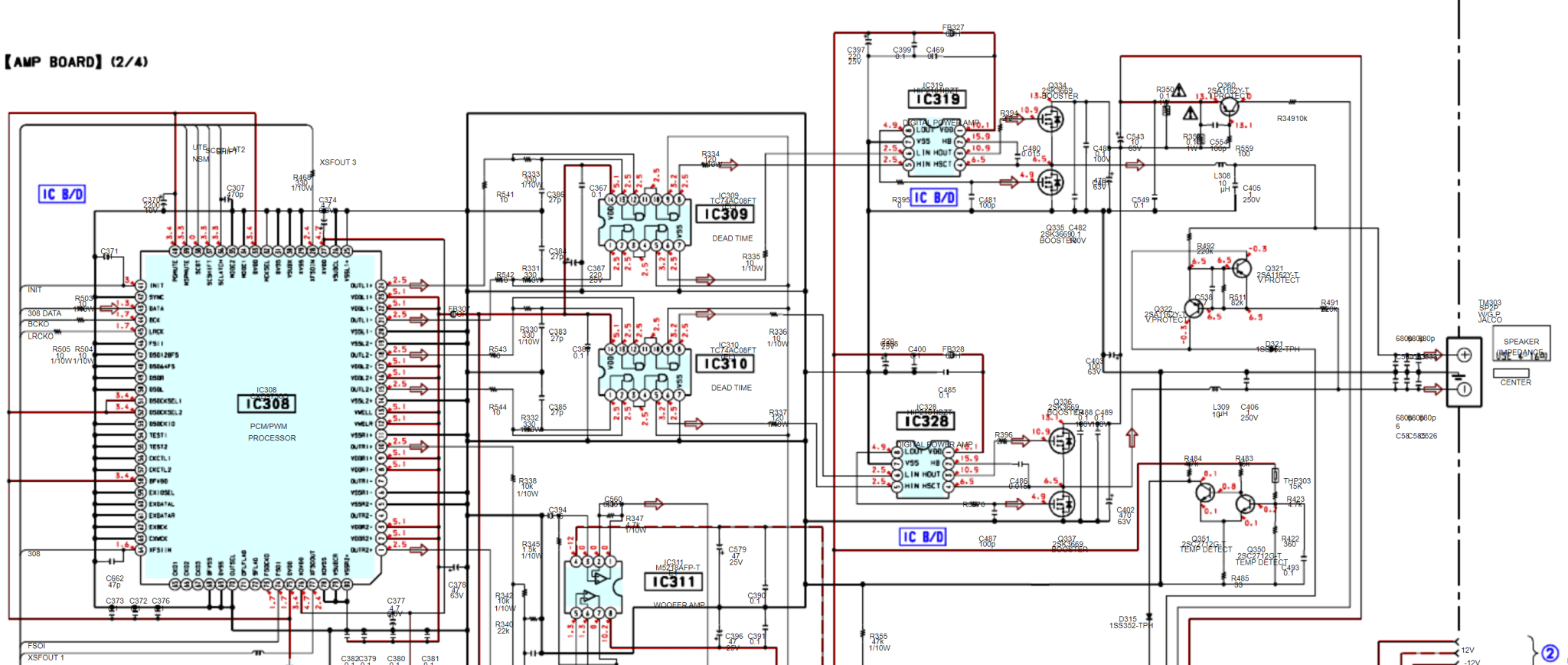

No, no. Digital boosters🤣They are the output devices. They operate in the voltage, current, time domain. That's analog.
Jan
Correct, they're just doing a bit of marketing.They are the output devices. They operate in the voltage, current, time domain. That's analog.
These Peachtree GaN-1 and Carina-GaN are digital all the way "up to the output stage", which is more digtal than anything else today.
Yes from what I've read the GaN output stage themselves the way Peachtree use them are analog, but because of their far superior switching speed and dead time figures, they allow the use of "everything before them to be totally digital", which Mosfets can't from what I gather. (correct me if I've understood it wrong)
