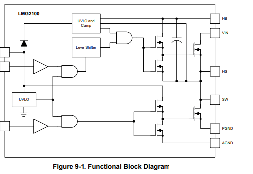

Why would higher speed and smaller deadtime lead to lower distortion? That doesn't make sense to me.Another thing I should have added to the GaN output transistor superior switching speed and dead time figures over Mosfet, is it said that because of these advatages over Mosfets they can be used open loop (zero feedback) (as Peachtree do in these 2 amps) and yet still have great low distortion figure of .04% or was it .004%. Remember designers only use global feedback as a bandaid to bring distortion and output impedance down, most prefer and myself "the sound" of local feedback only if the distortion and output impedance are still kept low.

An amplifier with no feedback has a Zout which is often at the same order of magnitude or higher than the intended load impedance.Why it is load dependent?
That makes the output voltage load dependent.
Fb can lower the Zout by many orders or magnitude making Vout independent of the load, within the amp's current capacility of course.

I asked the question to TNT.
The switches link the load to ground or +V with few milliohms. The output impedance is that of supply at switching frequency. Whether the load is 1ohm or 100ohm, the PWM has the same amplitude. Only the damping of the output filter makes the difference but the feedback of standard class D exclude the filter.

https://www.ti.com/lit/an/snva815a/snva815a.pdf
Load impedance -> Load Current -> Deadtime variation -> Amp performance
https://e2e.ti.com/blogs_/b/powerhouse/posts/the-sound-of-gan
Says less deadtime, less distortion, but I don't know if this i applicable for all cases of use?
"GaN’s inherent characteristics provide a more ideal model of a small-signal PWM, driving the output filter. Along with this, the absence of a body diode eliminates reverse-recovery charge, which enables increased output linearity. Both characteristics allow GaN to minimize THD and ultimately create higher-quality sound."
Så not independent from the load but GAN " provide a more ideal model of a small-signal PWM, driving the output filter."
Integrating the driver still don't make dem digital devices, but a mixed signal one: https://www.ti.com/product/LMG2100R044.

Page 9 explains this for AD modulationWhy would higher speed and smaller deadtime lead to lower distortion? That doesn't make sense to me.

Don't know why, I just repeting what's said, that it has .04 or .004% without the use of feedback.Why would higher speed and smaller deadtime lead to lower distortion? That doesn't make sense to me.

@HAYK has given a good reference that explains it. Logical in hindsight ;-)Don't know why, I just repeting what's said, that it has .04 or .004% without the use of feedback.
