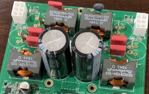

As for distortion, the biggest losses are very often in the inductor, not in the main switching circuit itself.
Only a proper post-feedback solution will fix that.
I have seen MANY designs with the wrong kind of inductors being used, as well for the material as well as the size.
I use premium flat copper wire high current inductors in my output filters and it makes a difference. These four inductors alone are the most significant cost of the amp assembly.
