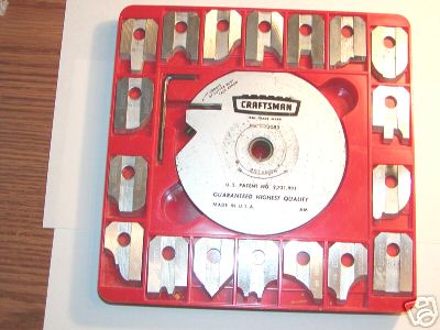

I do insane things like ruining concave moldings across the blade.
Ah, me too. Nothing wrong as long as you setup guides and raise the blade by small increments.
I milled about 2 miles of 7" MDF baseboard, 5" MDF door casing for a house a few years ago with the dreaded Craftsman molding head Cutter. Truly scary. Still have all of my fingers though (knock on wood)

'"I milled about 2 miles of 7" MDF baseboard, 5" MDF door casing for a house a few years ago with the dreaded Craftsman molding head Cutter. Truly scary. Still have all of my fingers though (knock on wood) [/B][/QUOTE]'"
I love that thing! It's like having a bunch of tiny shaper heads.

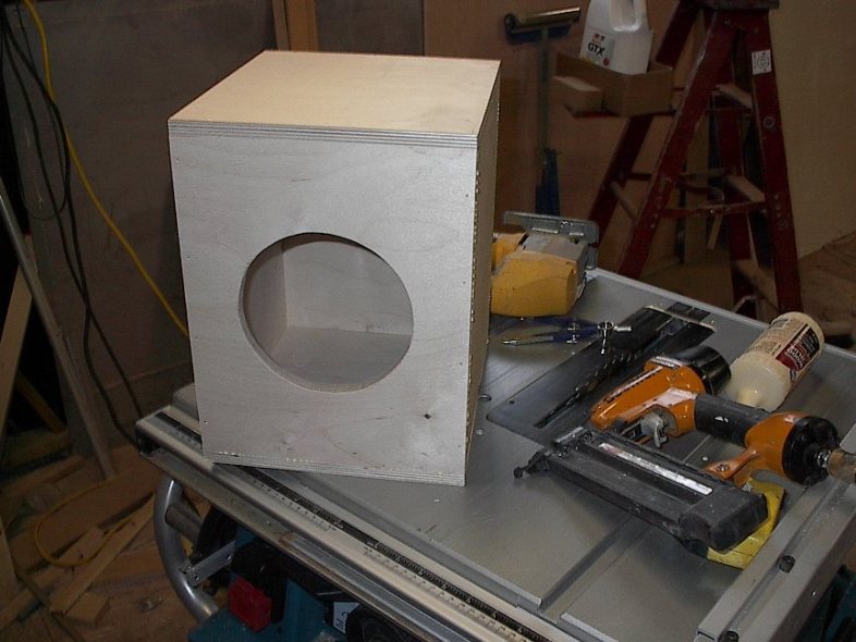

Test & Assembly
First, I checked the crossovers & drivers:
Sounded good. Definitely not $380 good, but everything is working OK.
Added foam to interiors. Double layer on back wall.
Madisound could definitely include more foam, I ended up scavenging scraps to get full coverage, and it looks awful.
I then siliconed in the rear of the port:
I put some foam scraps in the tube to give myself something to push against. I wanted to hold the tubes in while the silicone set. I then used tape to hold the scraps down, followed by books (not shown, sorry).
I also foamed the driver openings in the baffles. I think I did the right thing here, but please let me know if this all looks completely screwed up.
Madisound puts double sided tape on the back of the crossovers. I ended up using it:

Gluing on baffles
I masked off the cabinets with painter's tape and newspaper:
On the first cabinet (shown nearest to the camera), I didn't mask off the baffle too, which was a mistake - I had to run around trying to clean off glue while the titebond started to set.
On the second cabinet, I masked off both:
Because the baffle was obscured by the newspaper, I had to keep checking to make sure I was putting the baffle on the right way on the cabinet.
Even when I was done, I had to poke a hole to make sure (and to let the solvents from the Goop & silicone escape. They're still outgassing at 12+ hours.)
They're in the basement now. I'll let them set for 24 hours before moving on to the final bits.
