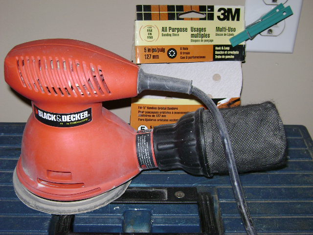

But sanding worked well too, just slower. I bought both a belt sander and an orbital sander, and I must have known which was going to work best since I put the most thought and $ into the orbital. I was very right to get one with adjustable speed, that turned out to be great to have, at least for me.
Tool:
Result:
In the end, all but two of the faces (see below) looked pretty good after a couple of hours.

I just today finished a can of bondo that size. The trick is not to mix to much to avoid waste. Dont add to much red it hardens quicker. The trick is to finish the tube as you finish the can. I managed that. This palm sander is my best friend. It really gets the job done. I cant see you needing a belt sander in speaker building.
