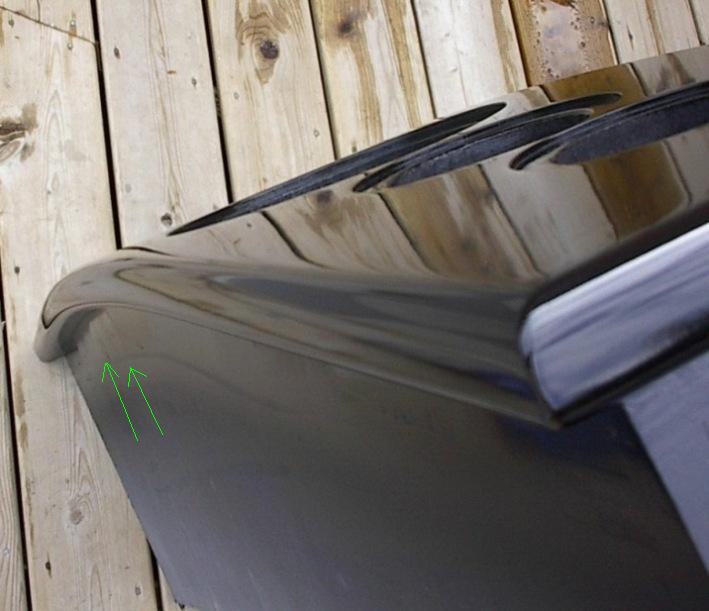

Here's an ugly shot for you. When the sun hits the baffles just right, they look awful:
Luckily this is only a few minutes a day, but still. I show you this partly to scare the younger children back on to the straight and narrow, but also in case there is an excess of perfection elsewhere in this forum that needs balancing. Note the excess glue, clamp marks, and other deformities.
Keeping with the ruthless honesty typical of this thread (or am I just too lazy to edit), I show you my latest problem. While moving the speakers for housecleaning today, I found this flagrant error:

Stew, the best way to tape the port or anything else is to overlap the tape and the trim it with very sharp utility knife.
If the port is under any kind of internal pressure, silicon will not hold it. If I may suggest, catch the port with 4 decorative screws. This way, you will have a good mechanical bond.
Are marks on the front baffle appear to be under clear coat or surface scratches?
I will screw the ports in
I have considered screwing the ports in, I just didn't want to make any more of a mess, plus I thought it might look bad. The ports shouldn't be under any internal load besides gravity, although gravity might well be enough. I think you're right though, and I'll try to get the ports screwed on today.
The front baffle marks are mostly over the clear coat, but there are also lumps from missed dribblets of glue I failed to sand flat enough. I could fix some of them with another few coats of paint/gloss, I'm sure, but really it is not visible or objectionable 98% of the time - and least not to me, and I'm the guy who looks at them.
I will do better next time.

I've never felt the need to screw in the ports. I've found hot glue, epoxy, or even wood glue make a real good bond. Maybe the silicone wasn't completely dry when you stood the speakers upright?
Those look like a great pair of speakers Stew, makes me really want to finish my speakers, which I can finally do now that the weather has become nice enough to work in the garage. When time permits...Your woodworking skills are obviously very good, and with these you will consistently create beautiful speakers.
From the looks of it you needed to sand the baffles a little better before painting (perhaps put some scraps of wood under the clamps...), and maybe a second coat of paint. It's not a disaster though, very fixable, will just take some extra time and effort.

I am just not big fan of silicone adhesives. My dislike also comes from working on site and knowing how easily silicone can damage finish. Like anything else it has it's purpose.
I think screw look fine. They also add a mechanical bond, so if there was some stress cause by lite green man, archangel Gabriel or an unknown force of nature, it is gone and irrelevant now. It's not like you are going to stand behind the speaker all the time and admire the ports.
I should have mentioned it before but sometimes glue spots are hard to see on the light veneer, like birch or even on the painted surface. It helps to wipe with rag, moisten in denaturated alcohol or just water. Shows you the glue spots.
Nice job anyway, and like you said, it'll be better next time.
