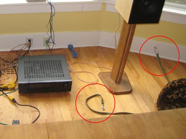

Re: Re: Re: Yes, I have a dog.
Being addicted to owning dogs, the evidence was just too obvious.
As for the WAF on th white noise, I would let her out of the house as well😀
StewLG said:
How did you know we had a dog, anyhow?
Re: Re: Re: Re: Yes, I have a dog.
Oh! No, that's for the toddler. The dog would never tolerate being tied down like that.
We can get speakers face to face very close together, reverse the polarity on one of them, run noise, and throw a blanket over them. Most sound will cancel out, and what's left is going to be muffled.
Try it.
