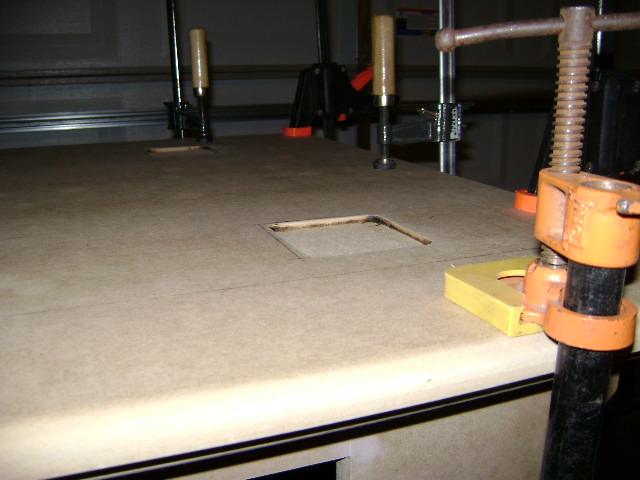

Failing at flush mounting speaker terminals
Added wires to my crossovers, along with labels, etc. Have not tested them yet.
I wanted to try to get a flush mount for the terminal ports, as shown here on Zaph's site:
I tried using a pattern bit and a pattern. Watch me fail:
That's all from the first attempt at making and using a pattern. It sat about flush, but looked terrible:
After the first attempt, I tried making another template and using it again. It also looked bad, for the same reasons - sloppy looking and ugly.
In the end, I opted for the simple, non-pimp version, and cut a simple hole, leaving the mount floating on the outside. It isn't slick, but it looks better than my flush version would have:
Router-masters please advise if there's something obvious here I could be doing better with pattern cutting. I have Bill Hylton's book on using a router, but clearly I failed to absorb something important from the relevant chapters.

Yep thats about how my test recesses came out too. I spent a few hours free handing with various methods to come to this conclusion. That is why I went for option #2 and made the router jig. It takes a little time to set up but once done you can spit out recesses until the cows come home. I'll never fear making precise rectangular recesses again.

Hi Stew,
Don't take this the wrong way, but there is a whole ship load of woodworking knowledge that you don't have. There are easy ways to do everything, but you need to know how.
Accuracy. It's not going to happen with hand held tools (not the kind of accuracy demonstrated in Zaphs builds), when you don't have the experience necessary.
To build a very accurate jig for your router, use a tablesaw. Yes a tablesaw. The picture below will give you the general idea. Cut pieces of MDF or plywood with the tablesaw and glue them together. Do something else while the glue dries.

No offense taken. I know I'm a novice, and that's mostly why I'm here posting at such great length.
Ooh. This is what CC was talking about. I get it. I don't have a table saw, so did not have this option. I'm not sure it would have occurred to me if I *did* have a table saw. Maybe next time I can get this right. (And maybe it's time for a table saw..)
Thank you very much for taking the time (moments? minutes?) to put that image together in what I assume is Sketchup.

No problem. A pic is worth a 1000 words, right? Better to illustrate sometimes.
Tablesaw is fairly essential equipment for the budding finger cutter...oops, woodworker.
Cheap one will do until you gain enough arrogance to believe you deserve the best. 🙂
Keep up the good work.

Yes stew that was why I posted pictures of the jig with the router in it and the recesses I created with it. The jig I made does not require a table saw only four pieces of wood with straight edges some clamps and glue. Its a trial and error deal to get it set up. I marked off the recess area as you did then placed my router with bit in over a corner area and clamped jig sides down as I went around the marked off piece with the router. I had no idea I lost you in my limited explaination. SO sorry. If you like I can go step by step with pictures to illustrate. Really once you do it once you will be a pro. The hardest thing about using a jig is gettng the router bit to cut through the mdf. Just chip away at it a little at a time. I dulled out many bits messing with this mdf. Its not power tool friendly. By the way good job so far. Its nice to watch your progress. Nope these stumbling blocks havent discouraged you. You do plan on more builds after this one? Maybe some speaker stands?? I see allot of nice tools and bits recently purchased.
I sometimes forget others havent messed with power tools their whole life. The router is one of my favorite tools.

Stew, you don't need a table saw to make straight cuts but you do need a fence or high quality straight edge. You can make very accurate cuts with a high quality circular saw and a clamped straight edge and a little patience.
