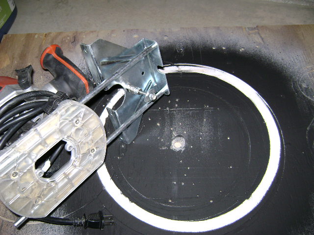

Tweeters routed
I received my Jasper circle jigs today. Since I've never used a router before, it took me a few hours to read all the directions and figure out how to use the router and the jig.
Even once I thought I understood how to use it, I thought I'd better do a test run on some scrap wood.
I went from outer -> inner when cutting the rebate (is that the right term?). I incremented the circle jig too quickly, and ended up with a hump.
This was a minor error, but I didn't repeat it. Incrementing 1/8" at a time on the jig is slow, but meditative in a way, and very reliable.
The big mistake I made was cutting the outer hole too small, so the tweeter would not sit flush:
Luckily, this was a test run. I incremented the hole size by 1/16" and it worked for the next test (not shown).
Finally, it was time to route the tweeters into the actual front baffles.
These are maybe out of flush by a hair in either direction, but I guess I'd be astonished if it will be audible.
Both baffles, one sample tweeter installed:
Tomorrow I expect to do the woofers, after cutting as many test holes in scrap as needed.
Also, I'm considering rounding over the edges on the front baffle, but I have no idea how important/unimportant this is sonically. I've been thinking about painting the front black (maybe glossy?) but finishing the sides in veneer. Or maybe veenering the whole thing, but rounded over corners make me nervous.
Any tips or advice appreciated.

Supposedly roundovers/chamfers are recommended, but alas, I don't know why. Holy crap, how thick are your baffles?!
When I recessed my speakers into the baffles my biggest concern was making the recess big enough to accomodate the three coats of primer and three coats of paint. Are your tolerances to tight for paint??? Just a thought.

chubby chaser said:When I recessed my speakers into the baffles my biggest concern was making the recess big enough to accomodate the three coats of primer and three coats of paint. Are your tolerances to tight for paint??? Just a thought.
Ah crap. Didn't think of that. Maybe I can go light on the paint in the routed holes? Or am I screwed?
1/2" on the roundover, check. And thanks for quoting me all that. I am trying to follow Zaph as closely as I can, but he is expecting you to use the Parts Express enclosures, so I'm already a bit outside his guidelines.
And to whoever asked, the baffles are 3/4" MDF.
StewLG said:Ah crap. Didn't think of that. Maybe I can go light on the paint in the routed holes? Or am I screwed?
Unless the tweeters are very tight in the existing rebates, you should be OK.
You could sand the inside edge of the rebate - very carefully, you don't want to deform it. As you say, going light on the paint will work. You can gently sand the paint too (as long as you don't cut through).
