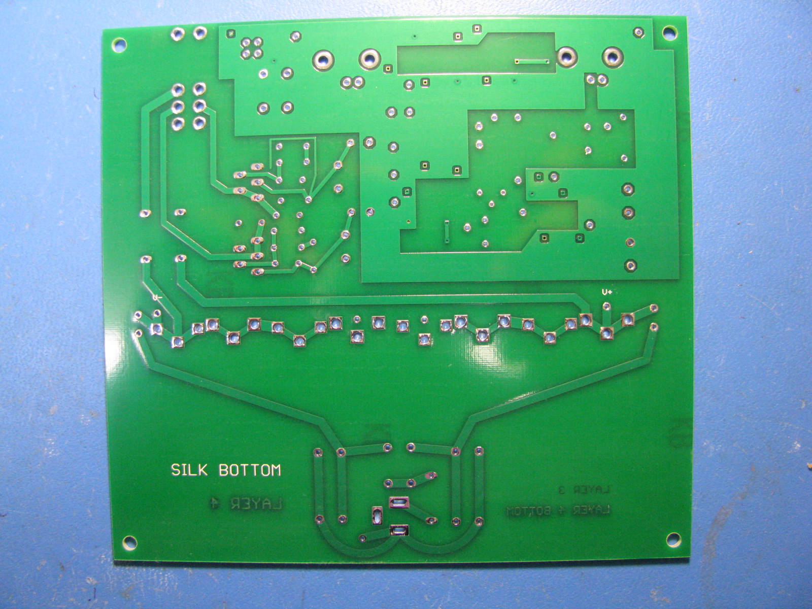

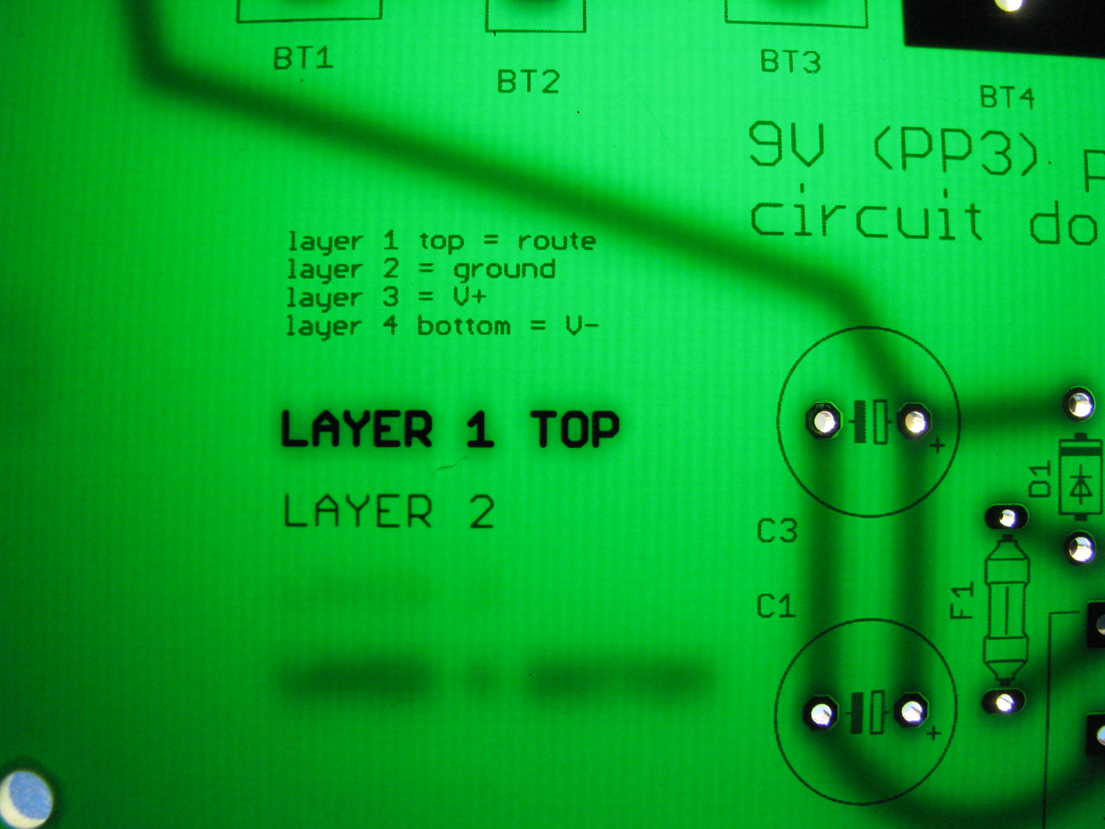

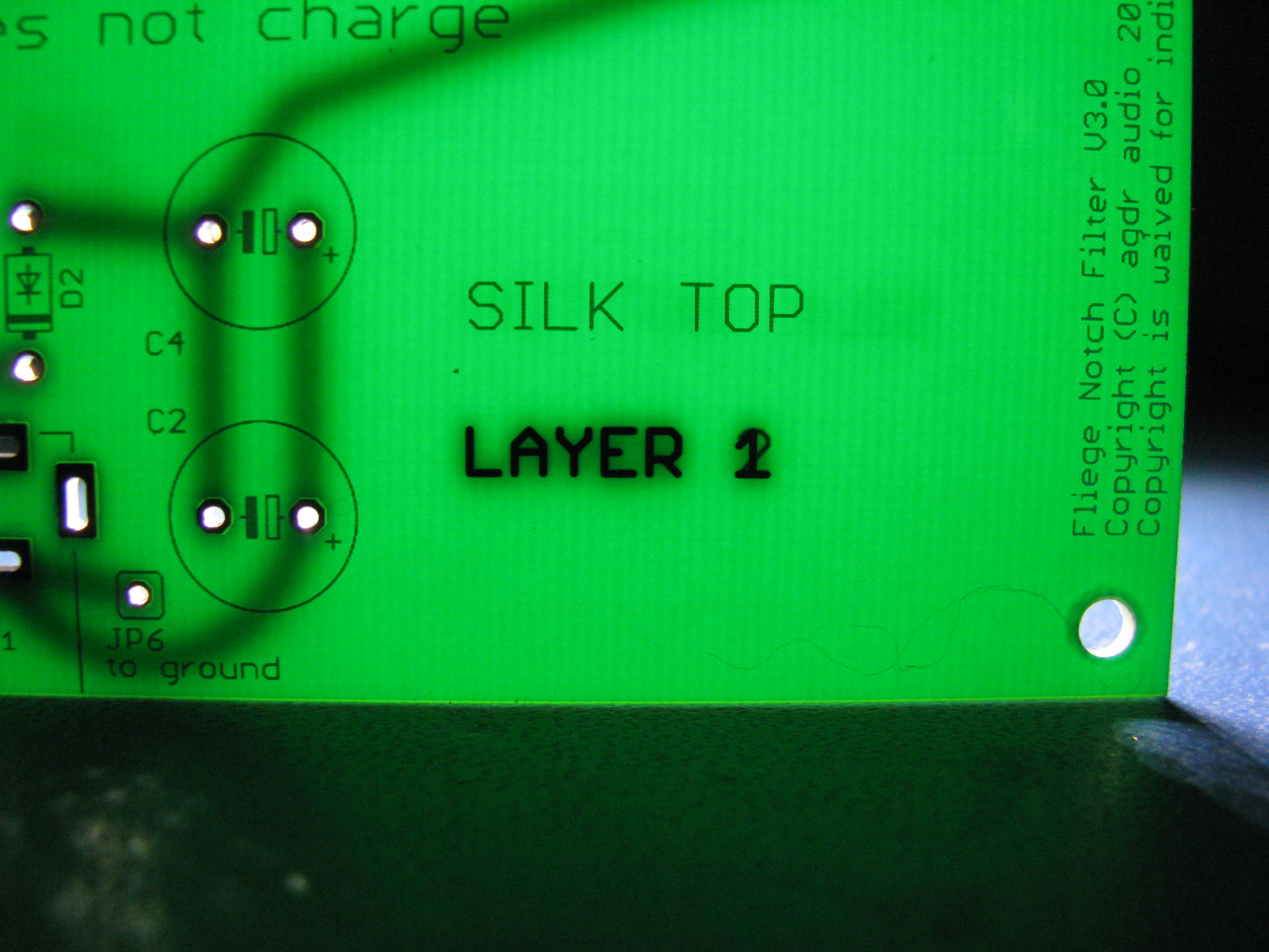

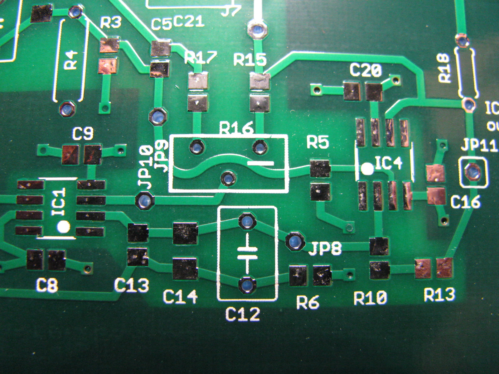

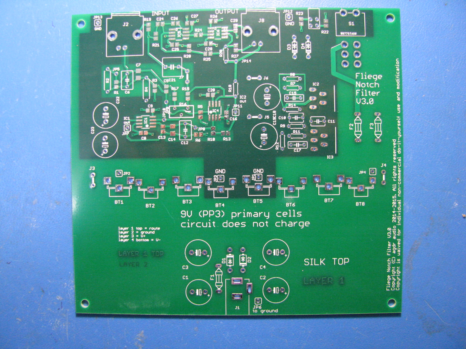

A very good PCBway experience this time!
As per the posts above I was going to wait a year to try pcbway again, but a project came up and I couldn't resist the 1 week turn-around and good price, lol.
I'm happy to report that I had zero trouble this time and the board is just excellent.
Their $25 DHL shipping had it to me in 3 days (China to the US). I notice that pcbway tenders the shipment to DHL right there in China. Things start moving immediately. Seeed Studio, the other outfit I've been using in China, charges more for DHL but theirs takes typically 4-7 days to get to Hong Kong by racing turtle (!), then from there is tendered to DHL and off it goes. Express shipping really isn't express if there is nearly a week delay in the express shipper getting the package from when the boards are noted as "finished" (Seeed Studio). DHL had the boards the day after the boards were reported as done with pcbway.
The board I sent is 4 layers and and is fairly large again, 120 x 130mm. Works just great. I've built it up and havent discovered any fabrication imperfections at all. No missing pads, no plating problems. This board has plated slots again for a power jack. Once again they came out just fine. I didn't send in any special manufacturing instructions for the slots either.
This time I put alignment text on the board, as shown in the photos below. The next-to-last photo has the word "LAYER" on each layer. In the last photo I have that word on all 4 layers right over each other so any alignment problems might show up. I did the same with the top and bottom silk screen although it doesn't show up well in the photos.
