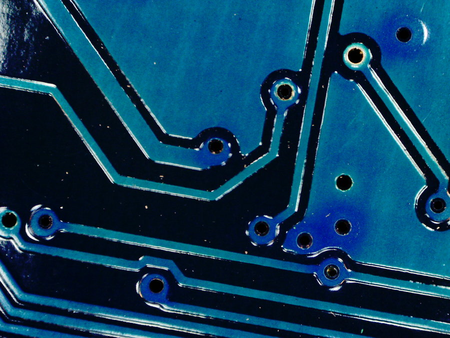

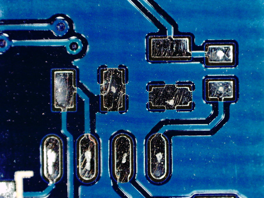

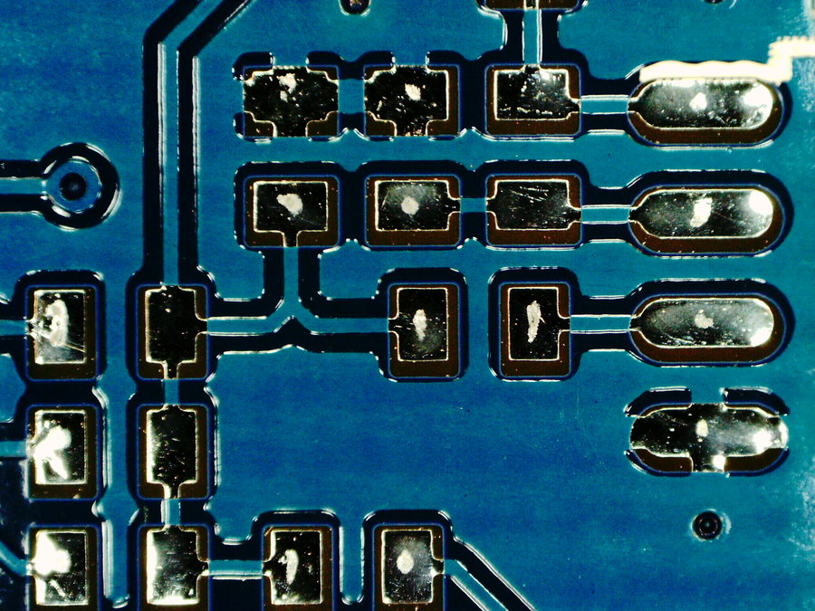

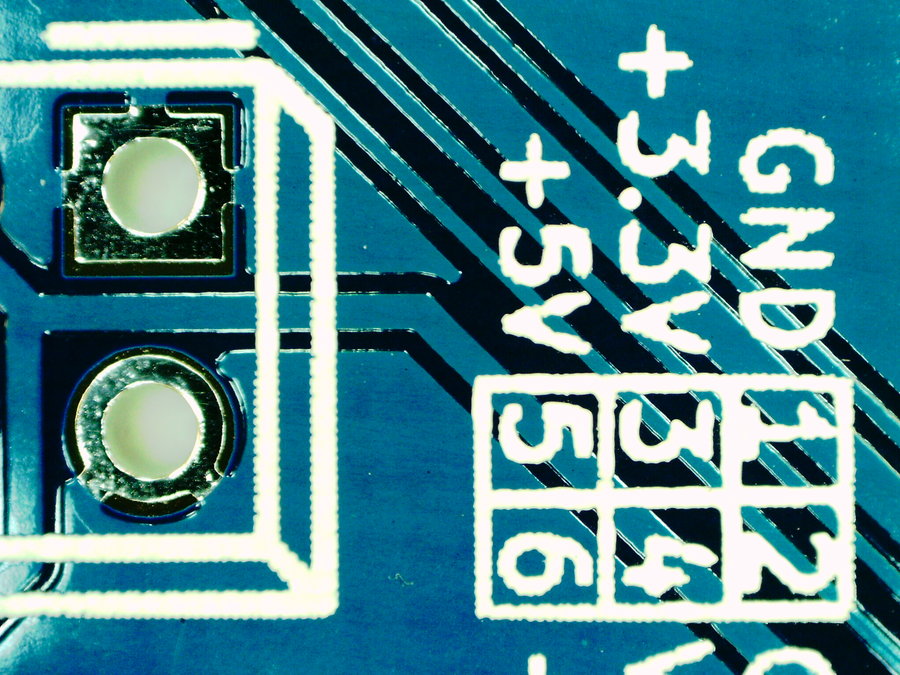

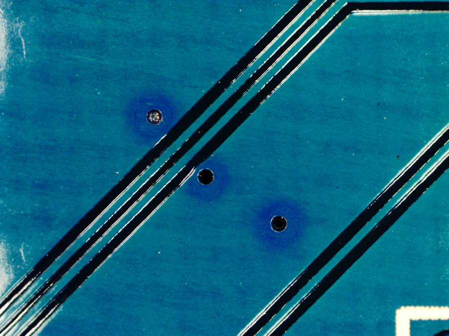

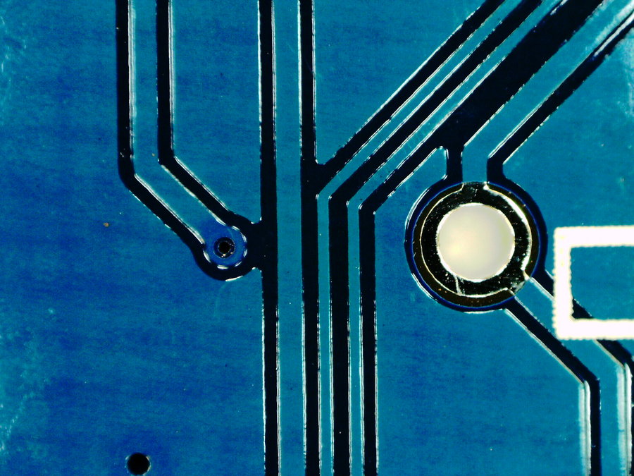

Our first order from PCBWay gave pretty good boards in a fast turn-around-time. (4days, Friday->Wednesday)
The board is 100*160mm 6/6mil tracks and 12/24mil vias. Came out nice, registration is good (still not perfect), mask opening could be a bit smaler to my needs.
But have a look at the pictures.

Good experiences so far with pcbway!
I was going to start a thread about these folks after having a few good ordering experiences, but I just found this one via search.
Disclaimer: I'm not affiliated with pcbway in any way, just a happy customer at the moment. 🙂

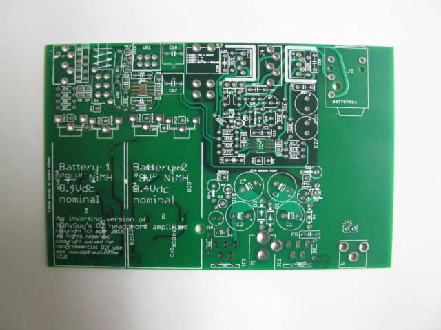

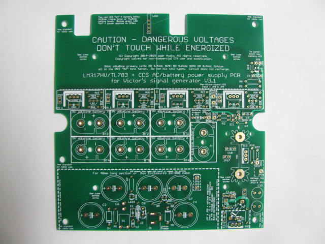

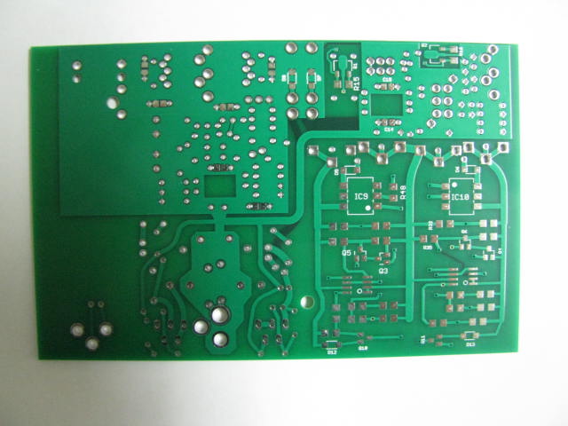

I first found the company a few months ago via pcbshopper.com, a board comparison service that Mark Johnson had linked to in another thread. I've been using Seeed Studio in China for the last couple of years with good results, but the prices have been creeping up, especially with the shipping. The pcbway price couldn't be beat, the processing time was incredible (short!) and they ship via DHL express for just $25 (I've been paying $35-$45 at Seeed Studio). Since then I've run the 3 boards in the photos below. I'm using Eagle V7 pro for the layout.

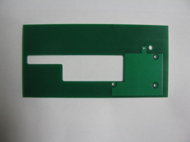

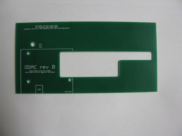

The first board is just a top-slot carrier board for another PC board, so (almost) no circuitry. Pcbway processed the big milled-out hole in the center correctly. The hole is to allow heat from parts on a board below to make it up to the top of the case and out some rear panel vents. Lol, I figured this was a good first test board. If they screwed up a board with one trace on it, that would have been the end. 😀
The next board was a lot more involved with 4 layers. Pcbway got it right! I've built up a couple of the boards now and they work perfectly. The finish on the board is just HASL. This design has parts on both sides of the board. It would have had text on the bottom for all the SMD parts if I didn't screw up one library part on my end and put the text on the top by mistake.

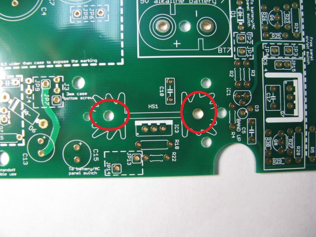

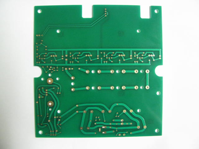

The third board (a 2 layer but large - 148mm by 143mm) is the most interesting because they did make a fabrication mistake, as the last two photos show (the red circles). The pads for the large heatsink were missing (one through-hole plated but the other didn't) and half the large electrolytic pads mysteriously shrunk. The yellow circle isn't a mistake, those are through-hole plated slots that pcbway processed perfectly! Mistakes can always happen, especially with the super-short timeframe these folks build the board in. The true test is how a company deals with it when a problem comes up.
Well I'm happy to say these folks passed the test. Their customer service got right back to me via email and had an in-house engineer look into it. The result was an error in a manufacturing file on their end, so they re-did the board at their expense. I also learned that all pads have to have a circuit attached, or they won't through-hole plate (what happened to the lower heat sink mount), something to keep in mind with this processor. This board was ENIG (gold) and the re-do was still in gold, even though I told them HASL would be OK (I was just curious how their ENIG finish looked). Even better they were willing to use an updated set of Gerbers for the re-do, since I had made a few updates since the original. I was pretty happy about that and volunteered to cover the $25 for the DHL express shipping again, although I presume they would have paid that too.
I'm certainly happy enough with the results to keep sending boards in! I'm getting another one together right now in fact.

Yes, but there shouldn't be any issues if the drill files are right. Problems occur if you just have one drill-file with plated/non-plated holes mixed together. Only then, holes without copper connection or pad are supposed to be non-plated. (I always use 2 files and send manufacturing instructions with)

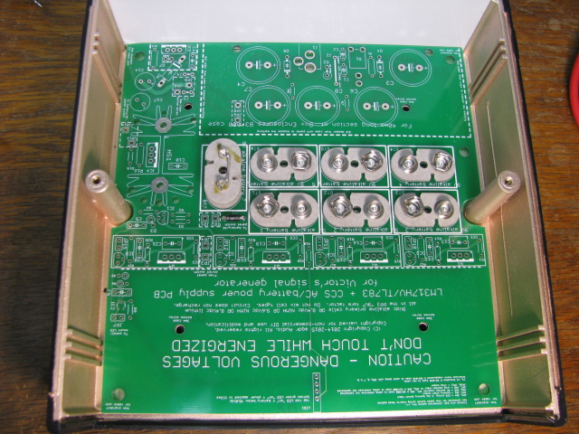

Mine is most likely mixed. I had the earlier V2.0 incarnation of the board processed at Seeed Studio, photo below, and it didn't have the problem with the missing heatsink pads, even without a circuit attached to the lower one.

If there is a pad drawn on both sides of the board for a heat sink, it should be there and through hole plated. I've never had one dropped because there wasn't a trace connected to it. They've done 40+ sets of boards for me in the past year.
