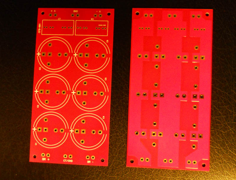

Your photos show fabrication performance similar to the PCBWay order I placed back in January. The off-center drill hits certainly aren't bad enough to cause problems with manual assembly, and they probably conform to customary industry tolerances as well as the supplier's stated tolerance, but I can imagine being taken aside by a manufacturing engineer who wants to know if I expect the hole placement to improve with the next batch.
The silkscreen looks ratty. Technical people tend to not care about this as long as it's legible and the edge irregularities don't lop over where they shouldn't be. Less enlightened souls (e.g., purchasing, sales, project management) often judge the "quality" of a board primarily on the silkscreen.
(I think your first photo shows a via too close to the edge of a copper fill. I'd expect the DRC in your layout software to squawk that, before the board goes to fab.)

Latest PCB
Here is the latest pcb I had made, no traces at all, just copper pours. My capacitor bank, with 2 oz copper.
MI

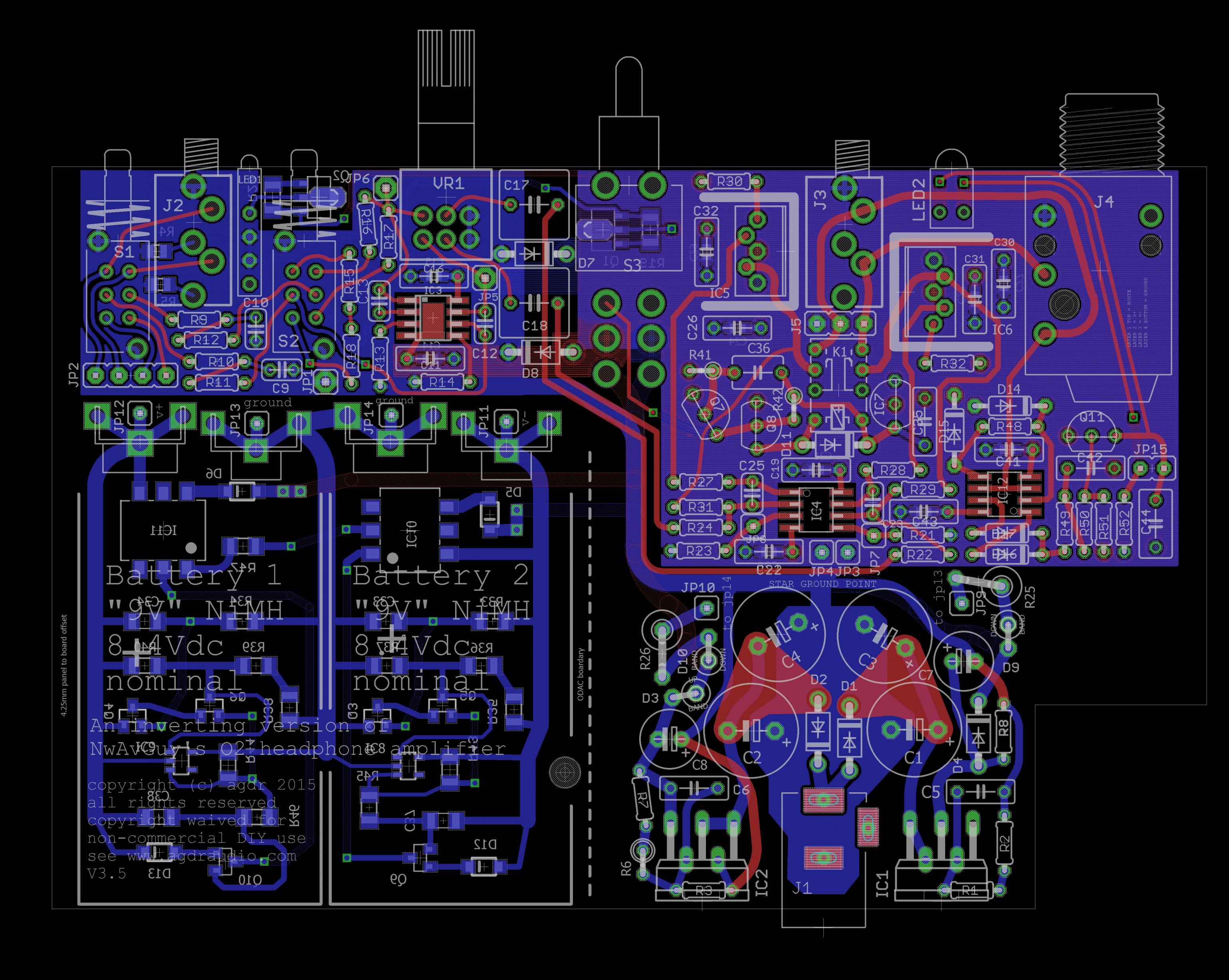

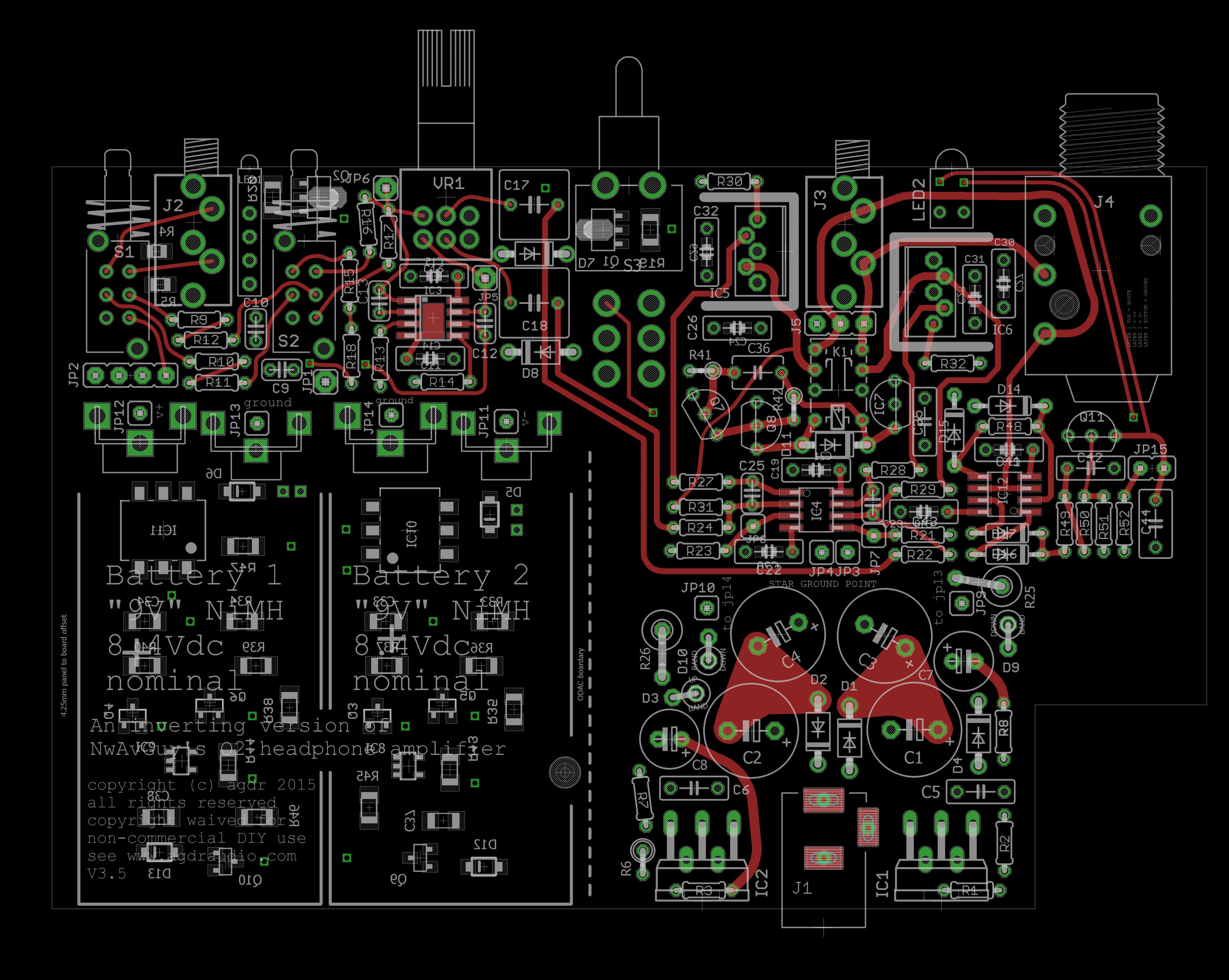

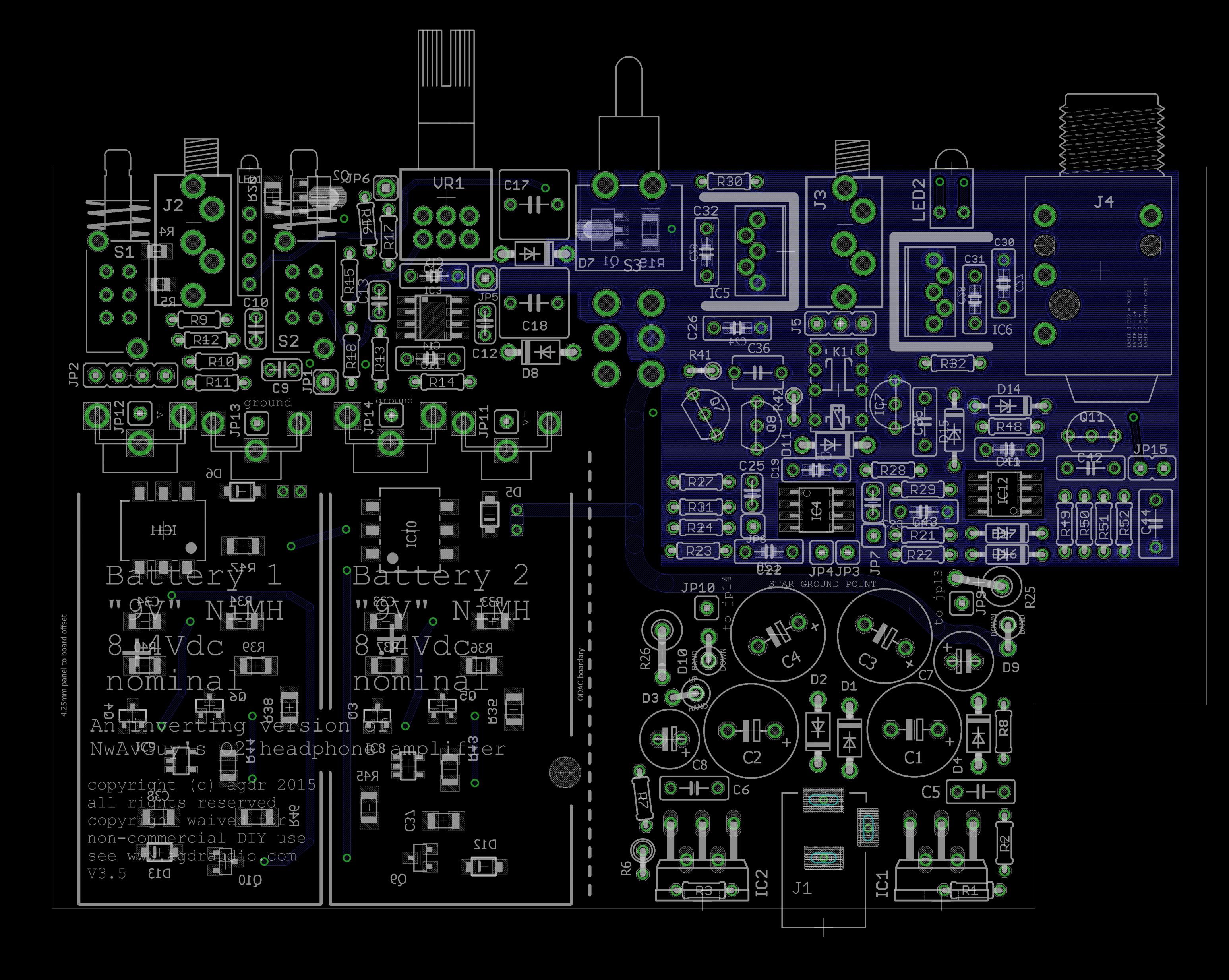

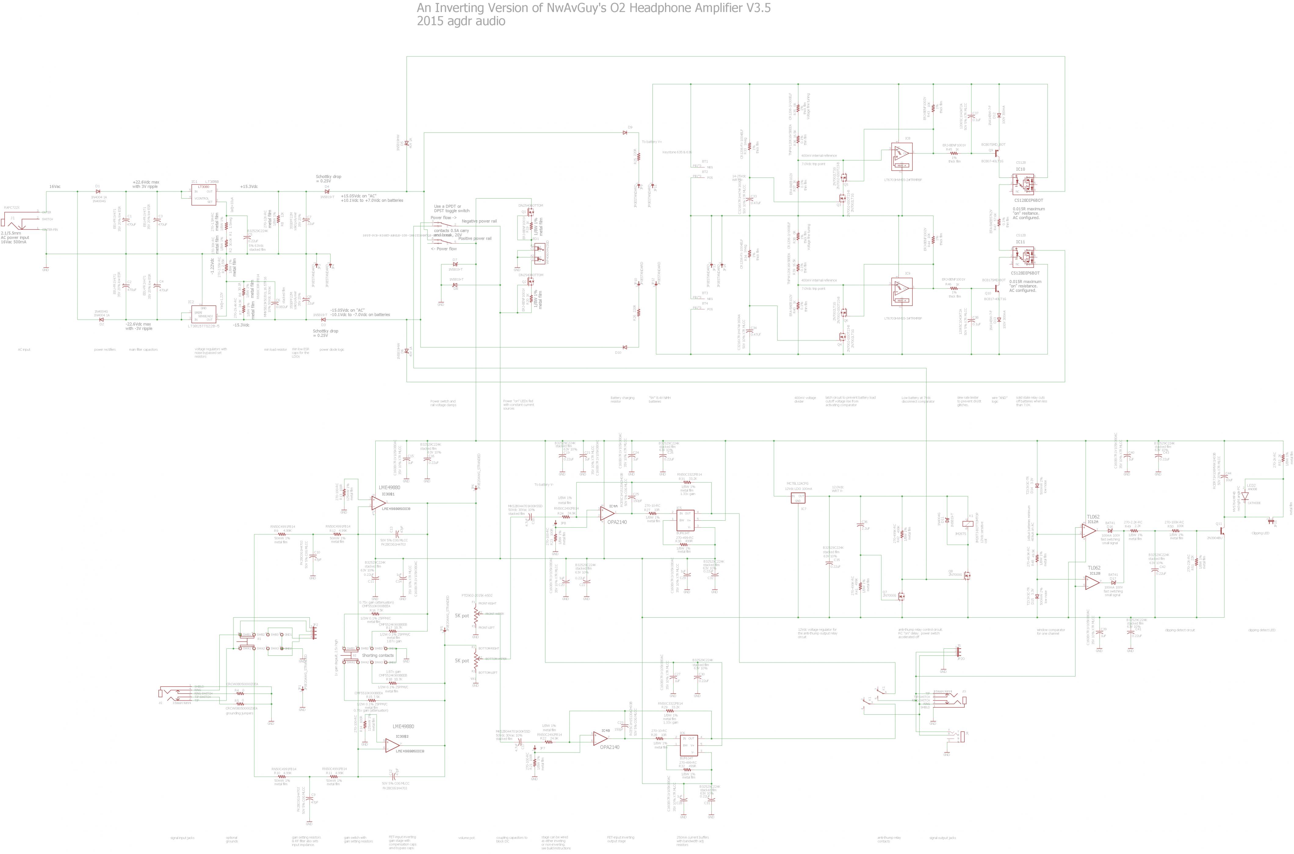

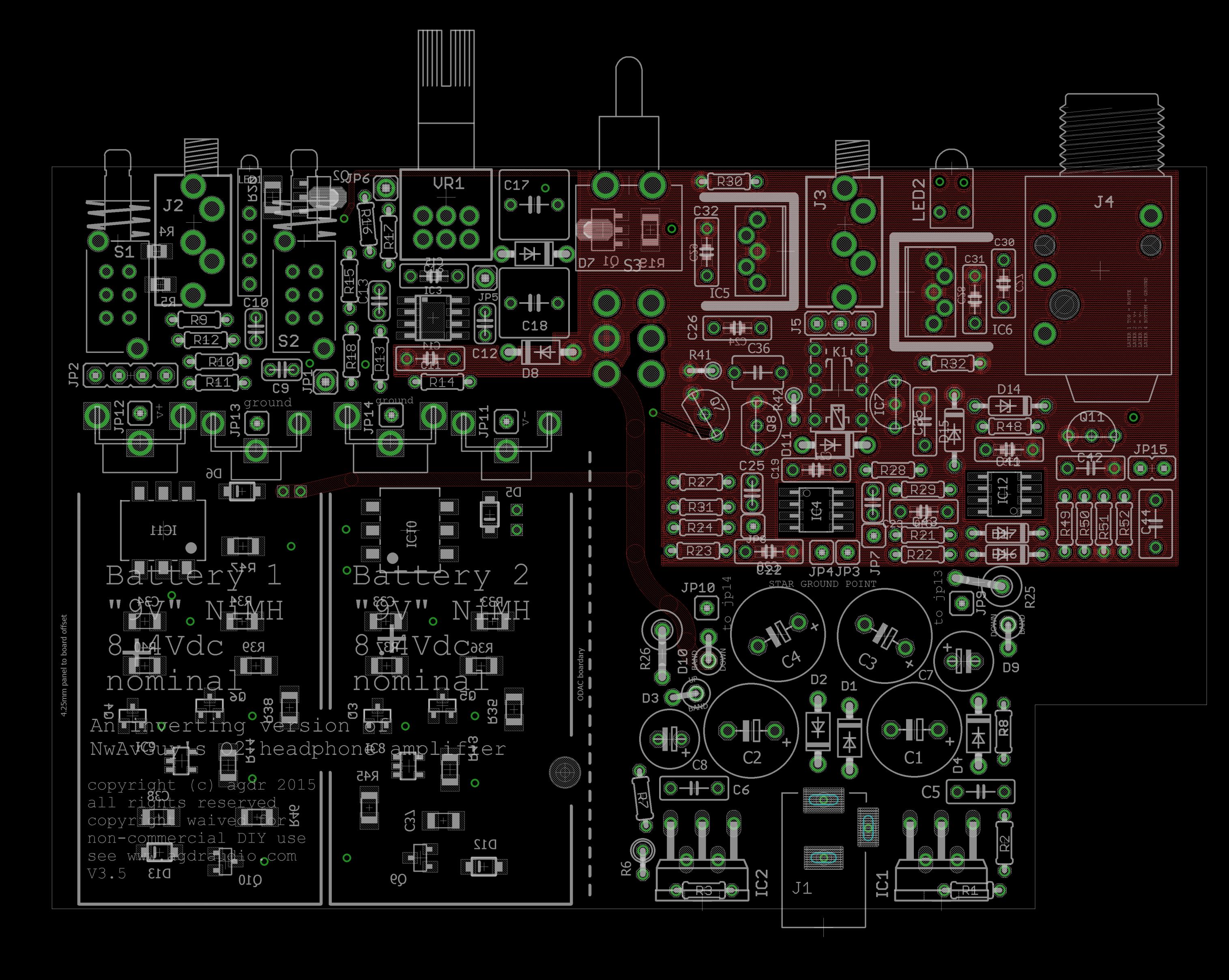

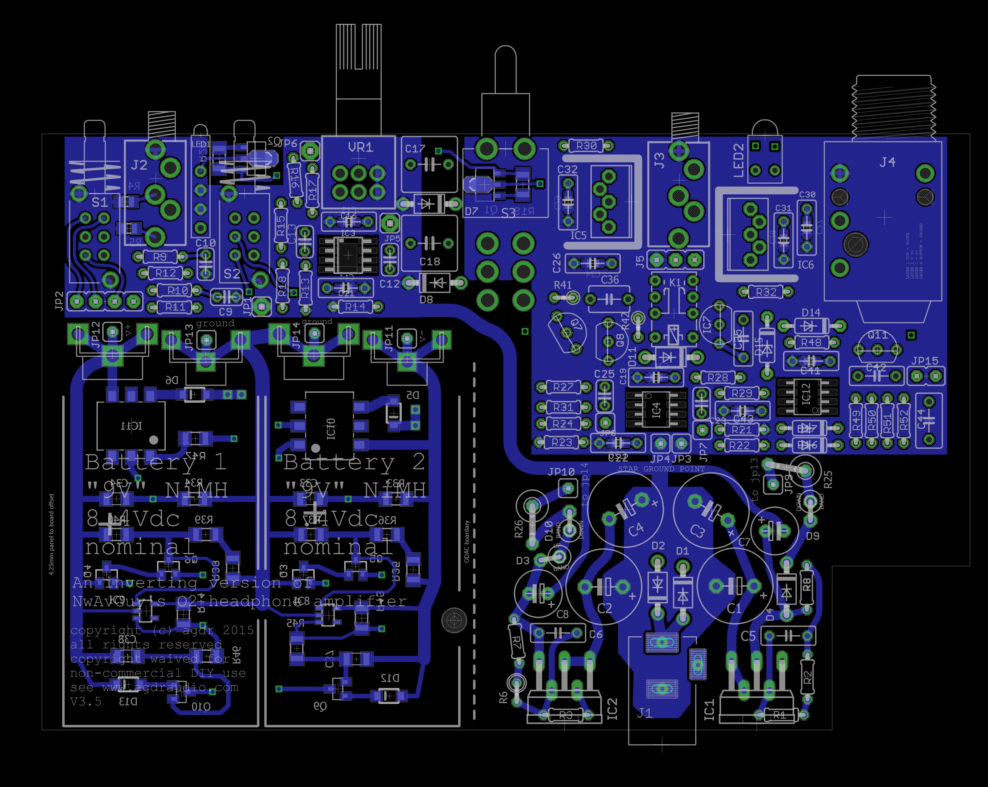

Would you mind to post your layout?
Sure thing. Below is the whole layout in the first image, then the 4 separated layers. It is this project:
http://www.diyaudio.com/forums/head...avguy-o2-headphone-amp-vs-original-thd-n.html
I have a theory that pcbway's scanning software "saw" that dashed line on the silk-screen half way up the board in the middle and decided it was a score/cut mark for two panels. The line is actually there because another board can bolt on top of this board in place of the batteries. The dashed line is just the extent of the add-on board.
