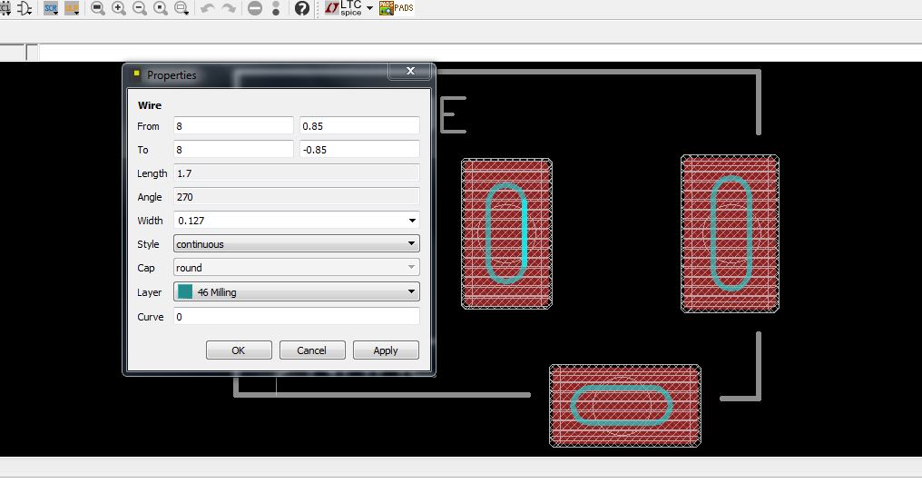

may I ask how the slots are defined in the gerbers? I need to do a board with PCBWAY that has slots so I'd like to know how to do that without "special instrunctions"

How to make plated slots in Eagle
I actually haven't even had to look at the Gerbers, I did it all via Eagle. :) The Eagle folks have warned me that the ability to process plated slots is very fab-specific. For instance last I looked at OSH Park's instructions they specifically state they don't do plated slots. But I've had boards with palted slots fabricated at both pcbway.com and seeedstudio.com (both China) now with no special instructions and the plated slots came out just fine.

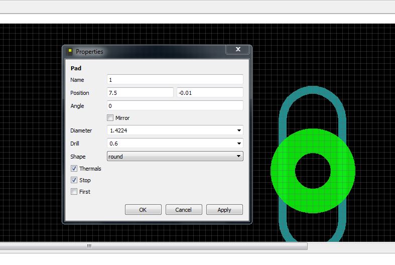

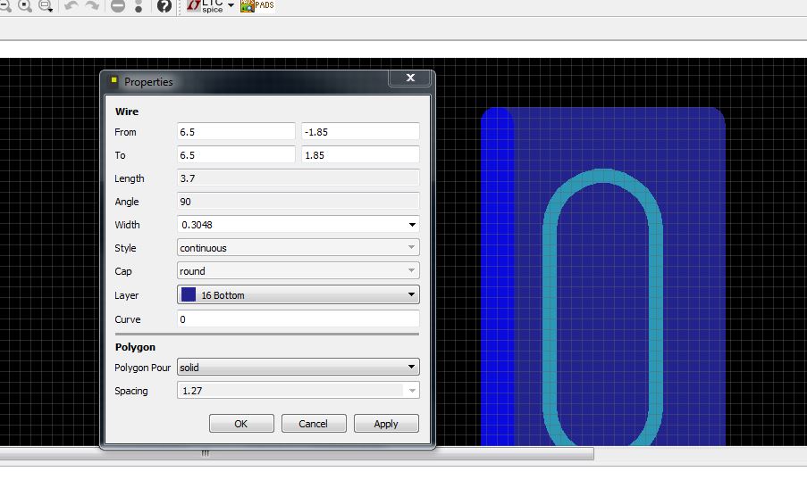

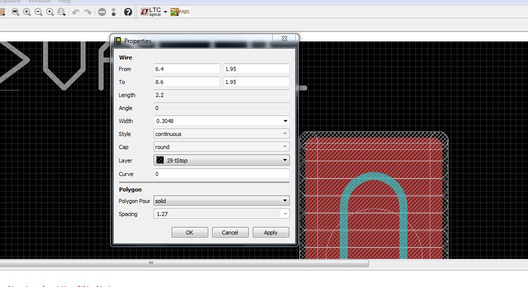

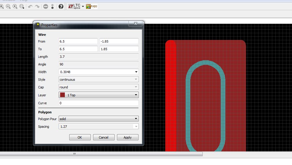

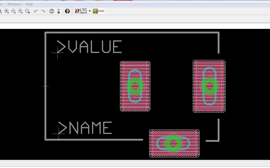

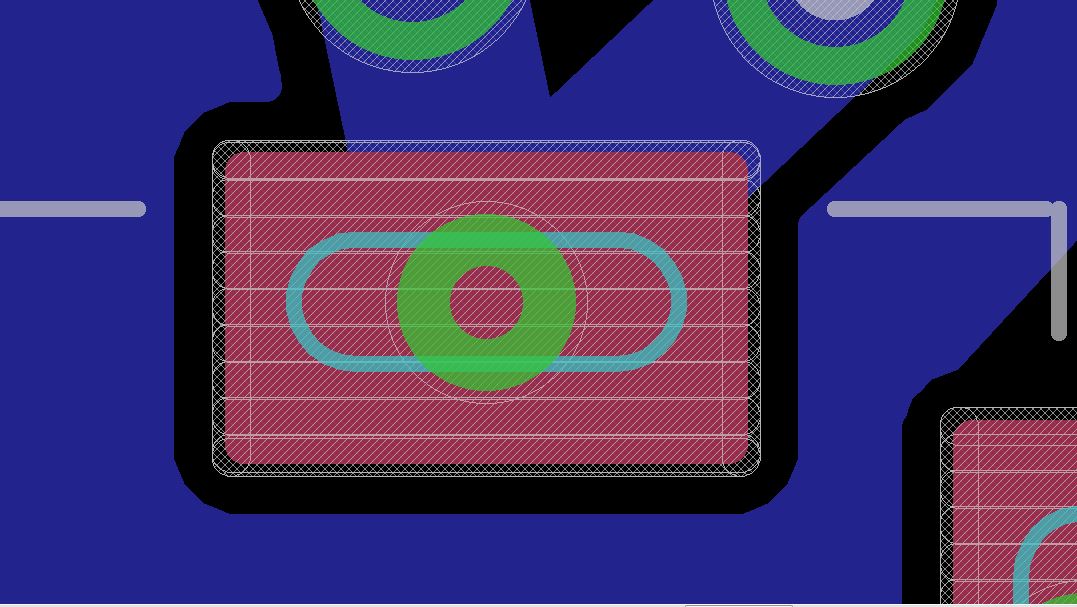

Here is how to do it in Eagle, in pictures (screen captures from Eagle). This may not help you much if you are doing slots by editing the Gerbers, but it may be useful to others out there using Eagle. The part here is the typical DC power jack (although this project uses it for AC), the switchcraft RAPC722X. The jack has 3 flat leads, one for +, one for -, and one for a switch contact. The rear flat lead is wider than the other two, hence one wider slot. Thanks, Switchcraft.
Photos and steps:
* The first two show the part on the layout, with the 3 slots. You are looking at quite a stack of stuff here on each slot. :) There is a milled-out slot in the board (aqua), a rear foil polygon (blue, doesn't show), a top foil polygon directly on top of it (red), rear & front stop masks (the white hatching) and a pad. In the second image you can see one of the tricks: the hole in the pad has to be small enough to fit completely within the milled-out slot. The actual outer width of the pad donut isn't important, other than it should be (well) within the (red) top metal polygon but big enough to extend outside of the slot.
* The next image shows the part now in the package editor in Eagle. You bring this up by right clicking on the part in the layout and choosing "open package". Here I have the primary grid set at 0.1mm, with the alternate grid (hold down the ALT key) at 0.01mm. The grid lines that show up below then are 0.1mm. Again notice that rear slot has to be a bit wider than the rest.
* Next I've clicked on that milling layer oval and brought up the properties window. Here you can see the milling layer is on layer 46 in Eagle. The milled slots wind up in the .GML milling layer Gerber file, I believe. To make these slots I first drew two 0.127mm wide lines parallel to each other on layer 46. The minimum milling width at Seeed Studio and pcbway is 1mm, so that is the spacing I used between the lines, even though the jack datasheet called out for slightly thinner slots as I recall. Then with the arc tool I drew end caps bridging the two lines, also on layer 46 of course.
* Next up it is hard to see, but I've clicked on that white hatching at the top of the slot pad, which is the top stop mask layer (tstop), layer 29 in Eagle as that properties window show. I made the stop mask polygon extend 0.1mm past the top and bottom foil polygons, as can be read off the grid here. This tstop layer is sitting directly over the same thing for the rear of the board, the bstop layer on Eagle layer 30. I haven't shown that in any of the images here because it is an exact copy of this one. If I turned off this layer 29 in Eagle there it would be. :)
* Next I've turned off both of those stop layers, 29 & 30, and clicked on the top foil (red), Eagle layer 1, which from the bottom of the properties shows as a solid polygon. Once again directly under this one is the same exact thing on the bottom layer (blue, doesn't show because the top foil is covering it), Eagle layer 16, which is the next image. I turned off the top red layer so the bottom blue layer would show.
* Finally the pad. I've turned off both front and rear foil layers here. In this case the pad has a 0.6mm drill hole with a 1.42mm donut. The pad is required so there is something for the wiring to connect to on the part in the schematic.
And that is it! Works great. :D I've examined the interior plating inside the slot with a magnifying glass. Just perfect from either company (seeed or pcbway).
It did take me 3 tries on different projects (all use that same power jack) to optimize the slot width though, since the flat leads on the Switchcraft part also taper at the bottom, which allows the slot width to be even a bit less wide than it would seem. I started with the slot dimensions given in the jack datasheet and found the part was still able to wiggle a tiny bit back and forth in the slots. On the second try I shortened the width of the ends of all 3 slots by 0.5mm. Helped quite a bit when the second fab run came back! On the third try I shortened them another 0.5mm on each and and the result is just perfect. The part flat leads go in the slots with no scraping, yet the part doesn't allow much "wiggle" and stay oriented perfectly while soldering the leads.
The gerber data must create pads/ovals/shapes/keepouts etc to accommodate a slot
but any drilling/milling of a slot is defined in the cnc excellon drill or milling data.
Another thing to consider is if the slot is to be plated or not? That will control the process of when the slot is created.
Some ecad tools do not create cnc milling data (which is a separate cnc file) so to make or specify a slot you have to create a hole in the centroid of a slot. Then in the drill schedule notes you specific a unique hole so that you get a separate entry in the drill schedule where you define the slot width(which is the drill hit or tool diameter) and the slot length.
pcbway in their cheap process by default plates all the holes or slots as they do not do secondary drilling/milling (non plated through holes) after plating. They only mill for image removal from the production panel.
