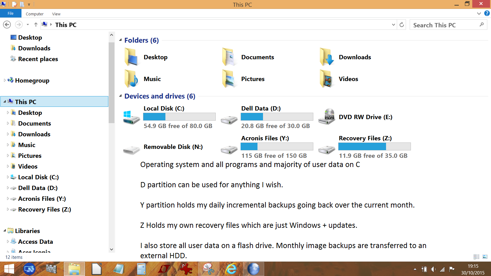

Andrew, this is how I have my single drive set up. Its a system that works really well in practice.
Does that mean I set up 4 partitions.
One at the time of installing Win7 and then add three more using the partition system within Win7?
I thought Win7 went into a partition all on it's own and other apps went into a different partition.

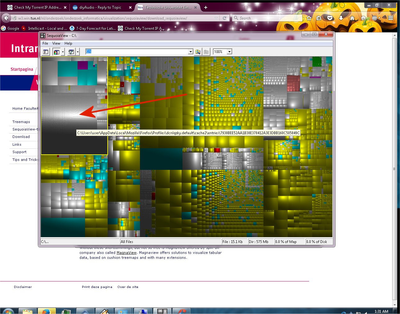

You can look at a typical "mess" on a non-optimized setup (standard users)
with a good viewer -
Technische Universiteit Eindhoven: Info SequoiaView
(below) is the 5gig W7-64 with the big grey firefox cache (red arrow).
With this tool you will know if any thing is adding "bloat" to your
"lean and mean" OS. You will also see no big grey box on startup ,
the cleaner will delete it automatically.
I've seen an unchanging image on this tool for 4 year usage timespans.
My OS is like a "toaster".
On an optimized OS like this , you can use a HDD disk image on a bootable
USB to restore this perfection in 3-4 minutes. NEVER down for more
than 3-4 minutes.
